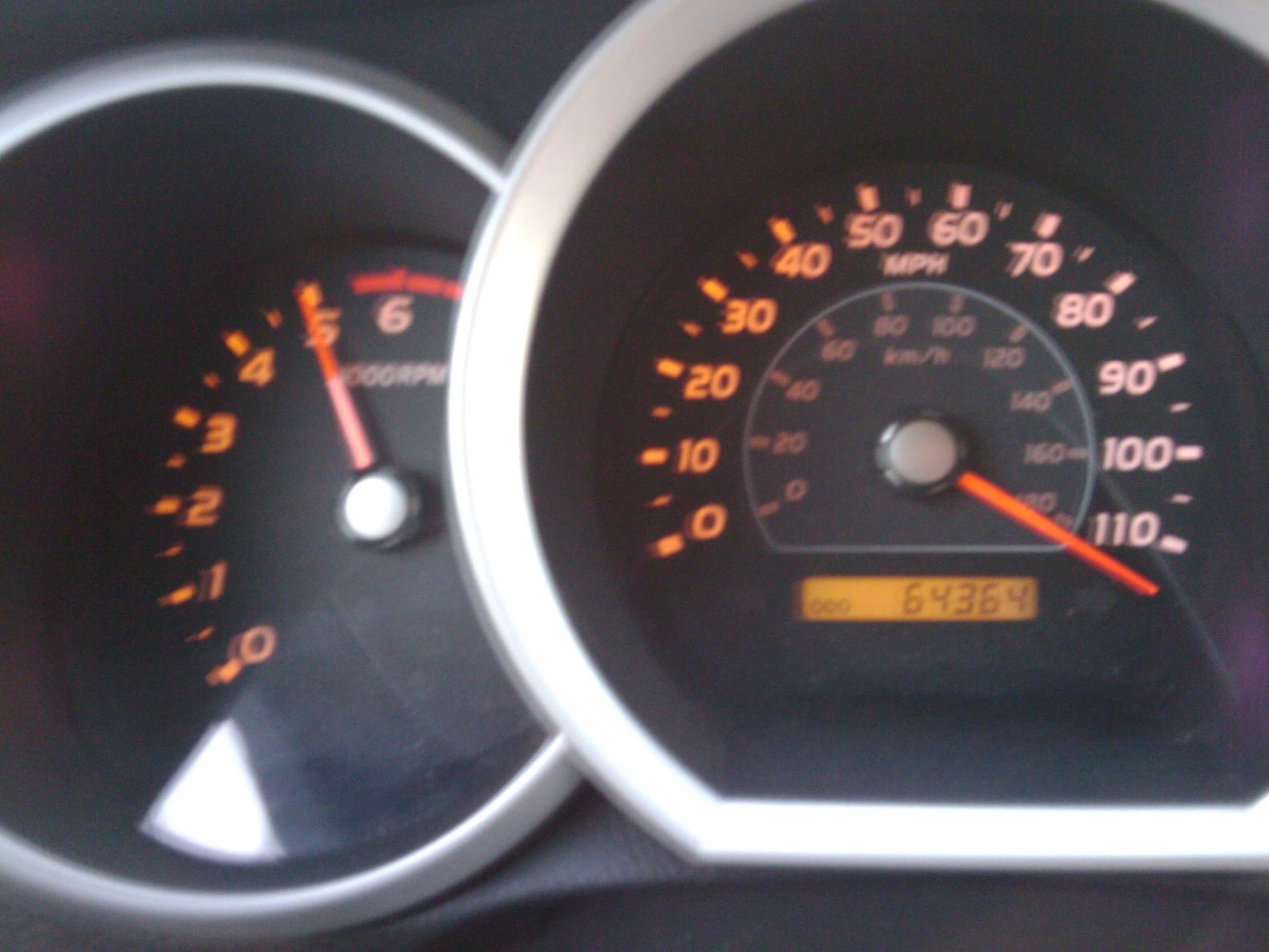

I can break lose the rear end in second, plus sliding is alot easier with just throttle and a good weight transfer with a good down shift. HP and TQ wise IDK I never dyno'd, same with top speed although I know its alot faster than 120 mph. Sadly though APR isn't making the X1 anymore so you'll need to look into getting another EMS. mapecu2 or the newer mapecu3 or the pro efi 48 or 128 is what I would look into, though IDK how the rest of the electronics like the speed, tach, ac, etc will react to a stand alone EMS, thats the beauty of the X1. If you just want a good bang for the buck get a urd MAF cali.
