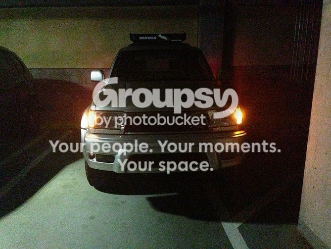

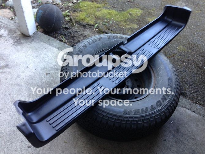

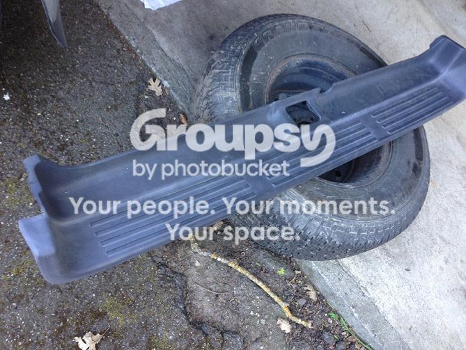

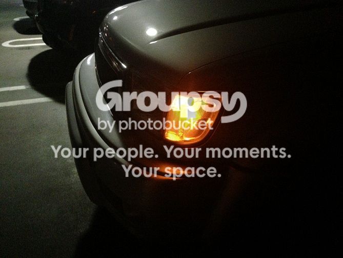

So I got some led amber corner lights. Much better than stock. Then I painted that sun damaged bumper plastic piece.
After:
Still saving up for that lift!

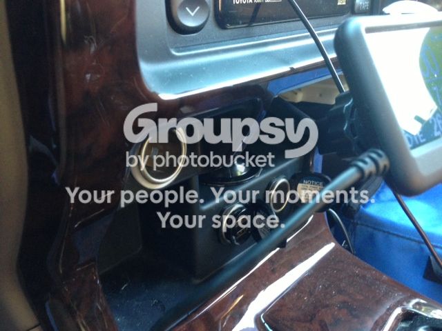

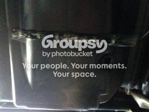

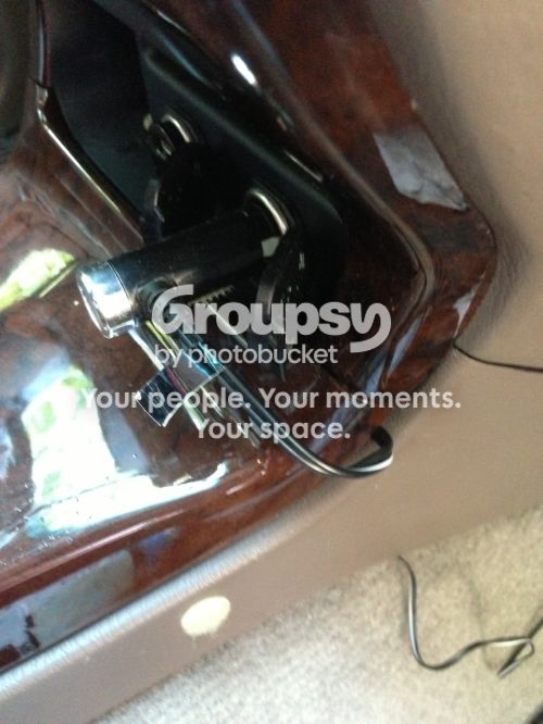

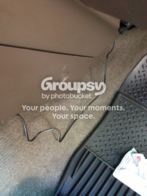

[MENTION=73561]spenedwrds[/MENTION] [MENTION=85535]TRDteen[/MENTION] How I did this was really simple, I went to pepboys, bought two small white led strips and a 12V Cigarette Lighter Plug with positive and negative leads. I just wired them together, tucked the wires under the center console and voila! I'll eventually free up some space and wire them to another power source, but this works for now. One extra thing I had to do was dim the led lights a little bit. They were really bright so I put some film tint I had lying around over them. Lemme know if you have questions, or if I didn't explain something well.
Nice man. You have to turn it on manually thought right? I would want them to come on with doors. But like u said. Temporary.

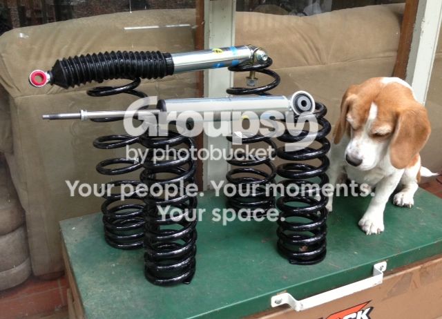

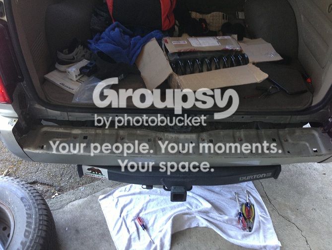

So after months of researching and saving up some $$, I finally got my lift!
Tundra springs/5100's. (probably gonna leave it on the first perch)
OME 890's/5125's.

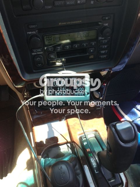

Got my Ultragauge yesterday! Its a cool little device. Definitely worth the $70.
I got an engine light a couple days ago, so I got the Ultragauge just in time to tell me what's up...its a P1135 code btw...:mmph:

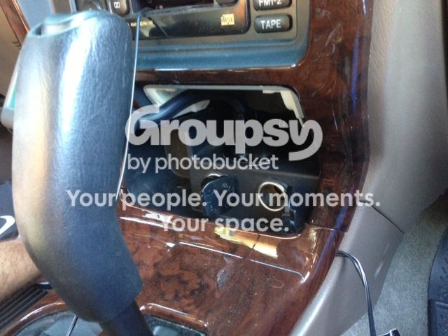

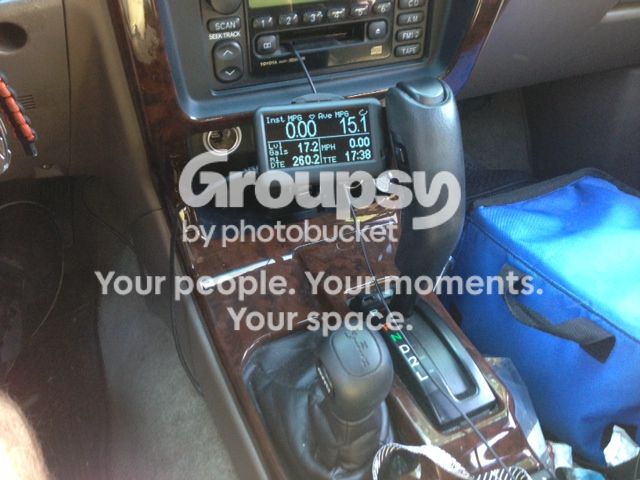

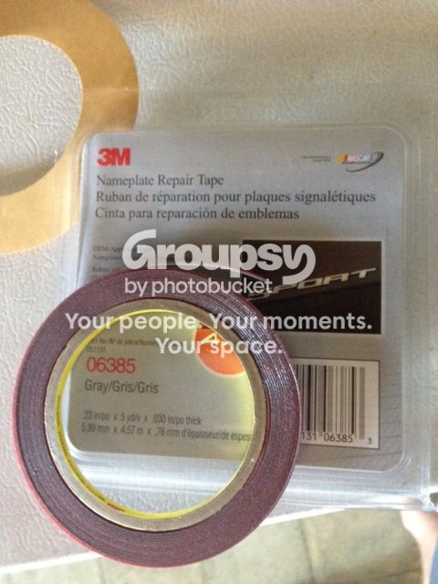

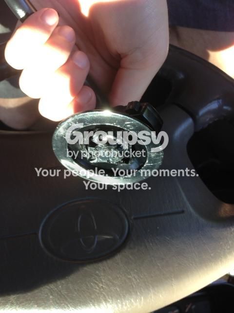

If anyone's interested in my mounting location choice, I'll post some pics.
-Took out the ash tray.
-Cut off most of the suction cup on the ultragauge windshield mount.
-Used double sided adhesive tape.
It's on there pretty good, it doesn't rattle and I can adjust the flexible neck without the base of the mount lifting off.
