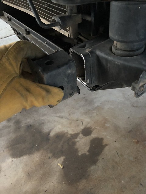

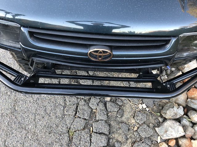

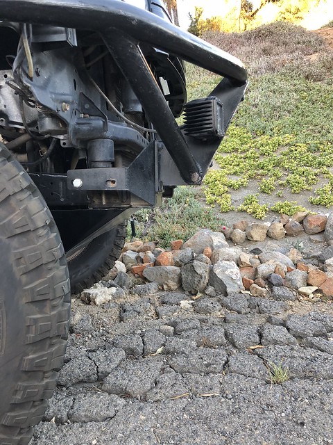

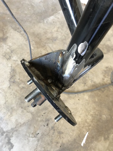

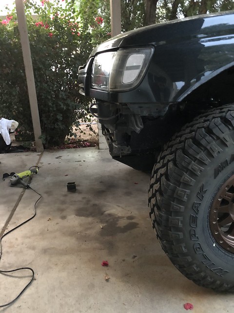

What are your plans for the new front bumper?
3/16” plate welded to the frame. Then 1/4” aluminum “access panels” that bolt into place. I’ll be cutting as much frame as I can. Trying to get it back as far as possible and definitely farther than anyone has ever gone.

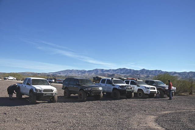

I have to ask how your friend likes the PW. As fun as the silver diesel you drove last month? Haven only driven one down a power line dirt road it was nice but felt heavy.
He loves it. He has about 45k miles on it, uses it to wheel all over, ties his Toyota Buggy with it. It does everything. I prefer the diesel though just for towing ability. With a coil spring rear on the PW, you’re kind of limited.
Decided to sacrifice approach angle for a winch. Ordered a 9.5k Smittybuilt. We'll see what happens when I start the fab. I see 0 free time in my future.
You could have both. Have you thought about building a receiver into the bumper? Then build a cradle for the winch. It's not as strong as a full bumper build set-up but a lot of guys use them and prefer them.
If approach angle is really that important to you it's a good option.
If you’re talking about what I think you’re talking about, that’s just one more thing to carry around. Not gonna happen. I’d rather tuck it in there far enough where I won’t care about it being there
