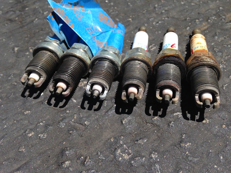

So I'm looking for a cylinder that it cleaner then all the others in a since that their is less carbon build up? It will be pretty obvious I assume?
Assume I keep driving like this, will a larger piece of head gasket eventually break off, causing even more coolant to seep in. Basically, am I driving on borrowed time?
Yep, you are correct. When I have seen such on plugs it means either the mixture is way too lean or the head has a crack in it. But YMMV.
Get another remanned head and stick on there. Maybe even do it yourself. If not, try Brian's guy this time.
Those plugs look pretty used. How old are they?

Alright, I don't have a bore scope, and have done the block tester yet.
But I pulled the spark plugs.

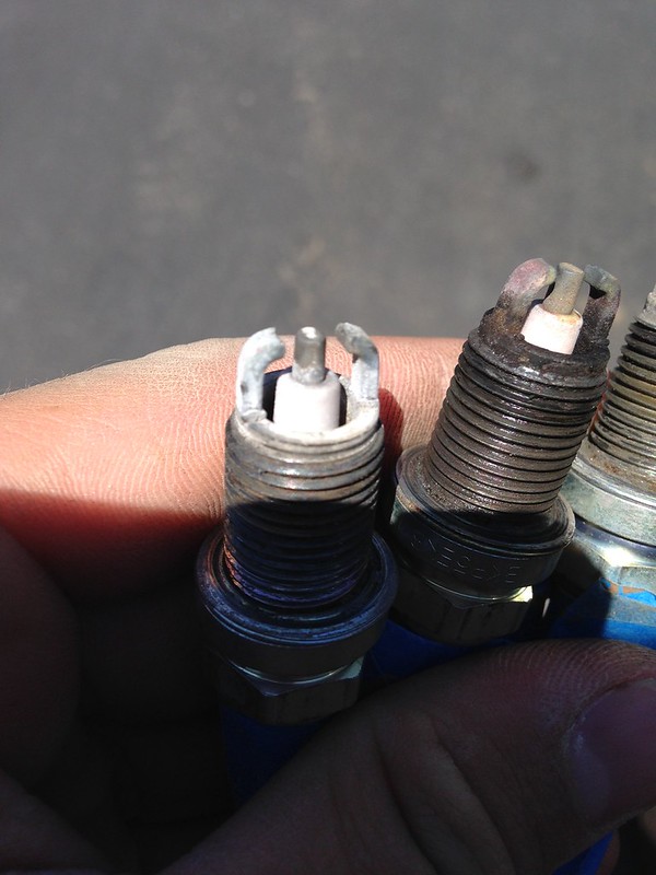

Is this burnt coolant (the white stuff) on the spark plug of cylinder number 5.
IMG_3205 by 4Running Daily, on Flickr
Steam cleaning from coolant getting into the combustion chamber from either a leaking headgasket, or the much less common cracked head, can leave a spark plug looking like that.
If you're going to do an engine swap why not try to repair the head first by doing the work yourself?
School doesn't start for a few months right. What is there to lose?
So we're all 100% sure Coolant is getting into cylinder #5 based on that spark plug?
I've seen enough bizarre things that I would never commit 100% to a diagnosis over the internet. For that I would need to inspect the parts as I disassembled them.
But all the evidence to this point, is leaning in that direction.
