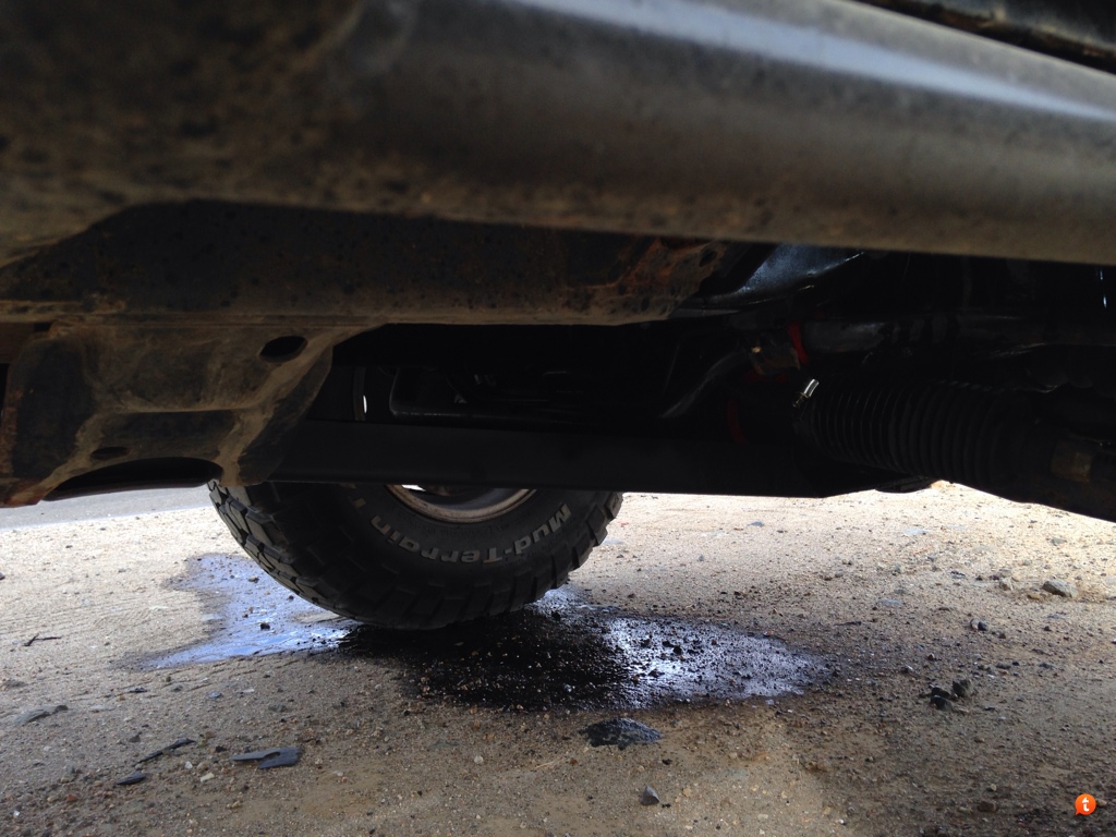

Update: just blew a hole in the side of my engine. Passenger side of the engine, the side that has blown head gaskets in the past. I don't know how. I was accelerating onto a freeway at like 3-4k rpm. And then I shifted to 4th and boom
Wow, it finally committed suicide...

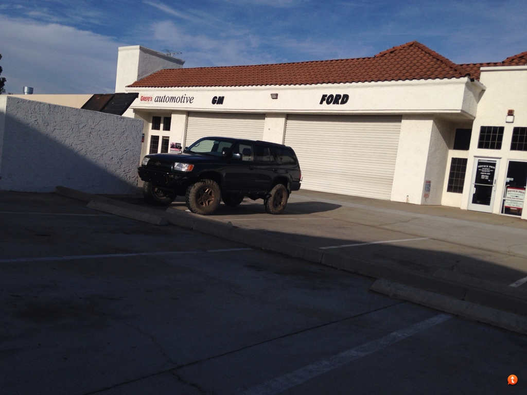

I dropped it off at Service Pros in San Marcos. I don't have enough time to deal with an engine swap. I wish I did, but with work and trips soon, I can't do it. Stay tuned for pics.
come on man. first time doing anything major and I had the motor in and out in less then a week. basically a weekend day, and a couple evenings.
Most likely the headgasket finally let go completely, quickly filling the cylinder with coolant, which hydrolocked that cylinder, breaking the connecting rod, which then knocked a hole in the block.
If I had known you were still driving the truck, I would've suggested not doing so, as what happened was a likely outcome.
Good luck with the engine swap.
