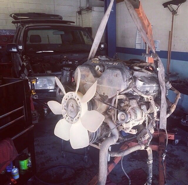

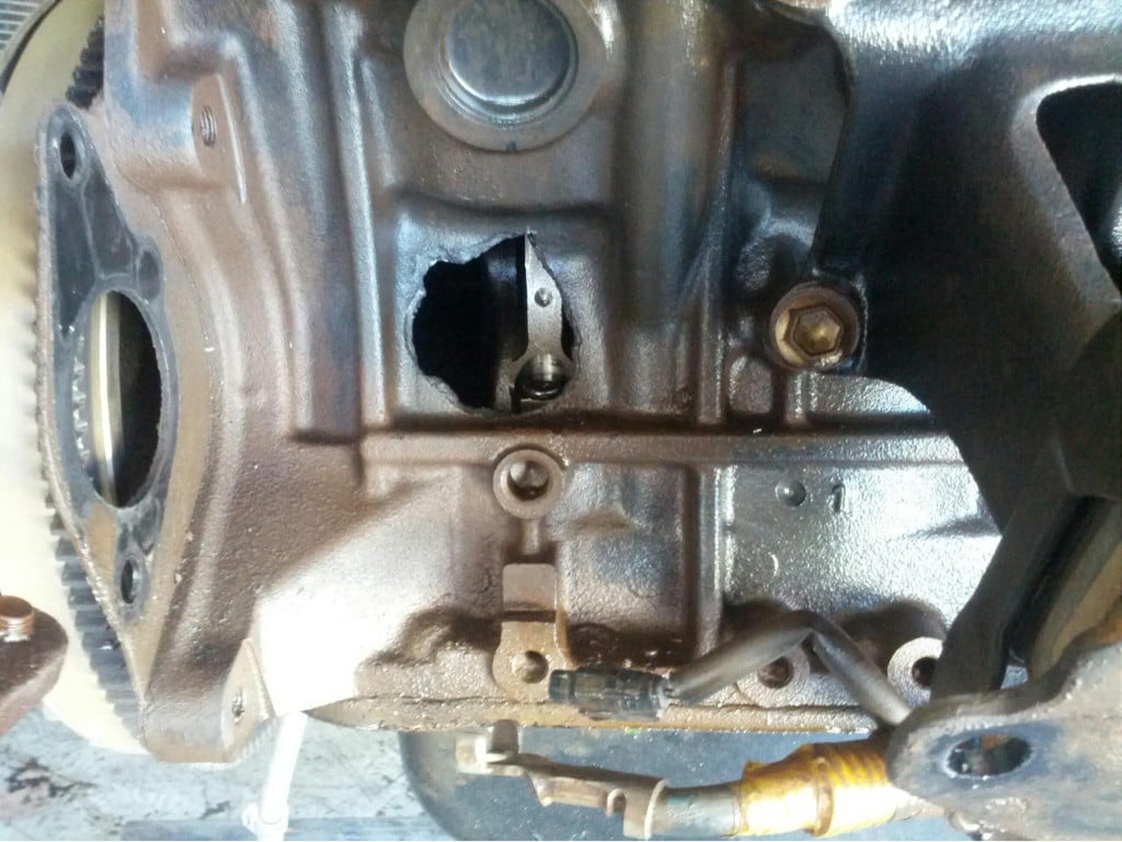

I don't see any holes in the block. Excellent!
Must have been a fight to get out since I don't see the front tires on....
When I pulled mine it was a lot easier to go through the wheel well to get the exhaust apart right there. And also gave you decent access to the motor mount if I recall correctly.

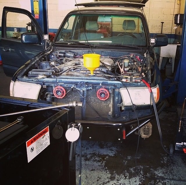

Very nice. At least you will have a nice present to come back to from Alberta.
I guess you have never done the Tundra brake upgrade then? At least flush the brake fluid, its darker than the paint of your 4runner.
Keep an eye on the coolant level for awhile, and top-off as needed.

Will do. I have to go but some Toyota Red.
This engine has 97,000 miles btw, feels pretty good.

Time for the real update:
Mileage of car on time of install: 177,152 miles
Mileage of Motor #2 on time of install 92,000 miles
New Toyota Genuine Parts:
-6 Rebuilt Injectors
-Water Pump
-Thermostat and Gasket
-Timing Belt
-2 Timing Belt Idler Bearings
-6 Spark Plugs
-2 Camshaft Seals
-2 Crankshaft Seals
-Oil Filter
-Release Bearing
-Valve Cover Seal Washer
-6 Spark Plug Seals
-2 Valve Cover Gaskets
-PCV Valve and Grommet
-3 Belts
-Oil Pan
