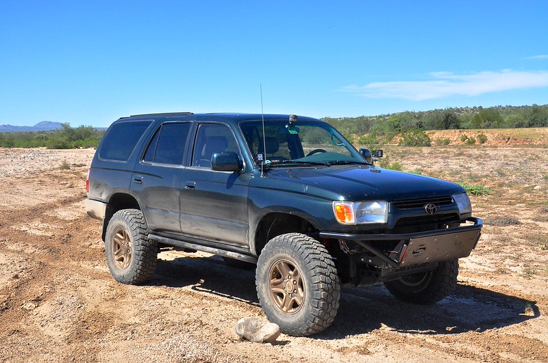

Trucks looking great and I was laughing when I saw your grille fly off in that video. Any plans for a rear bumper at all?
