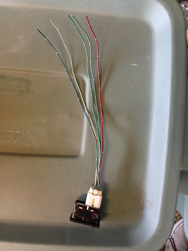

First I bought a switch with a foot of harness attached for $10 off craigslist.
IMG_3976 by 4Running Daily, on Flickr

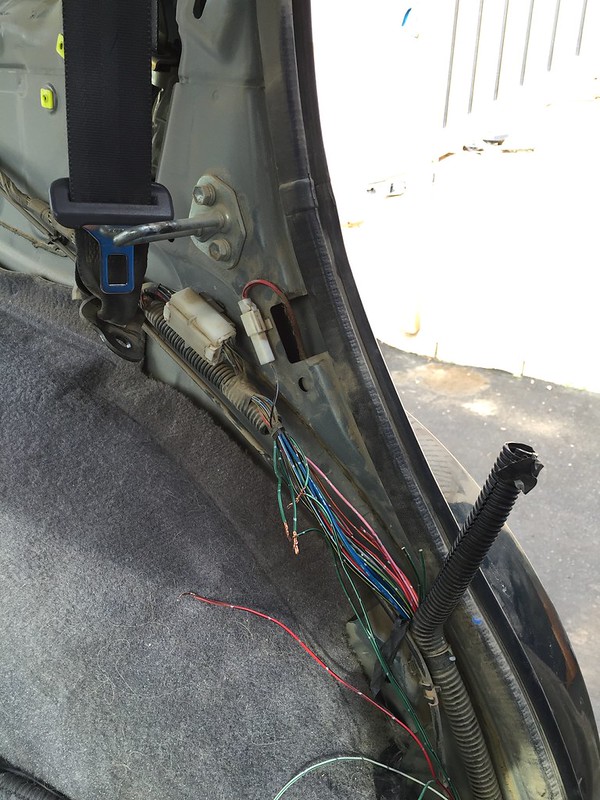

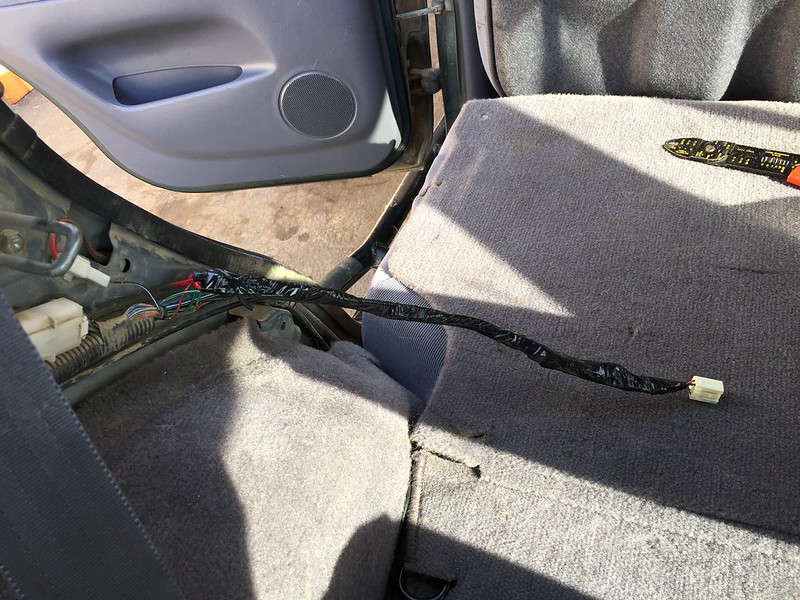

Turns out, you only need 3 of the wires off the harness to wire into the harness on the car. The red and black wire, the Mint Green and Black Wire, and the dark green and black wire.
Slicing the wiring harness, drivers side.
IMG_3977 by 4Running Daily, on Flickr
Extend the wires and wrap in electrical tape

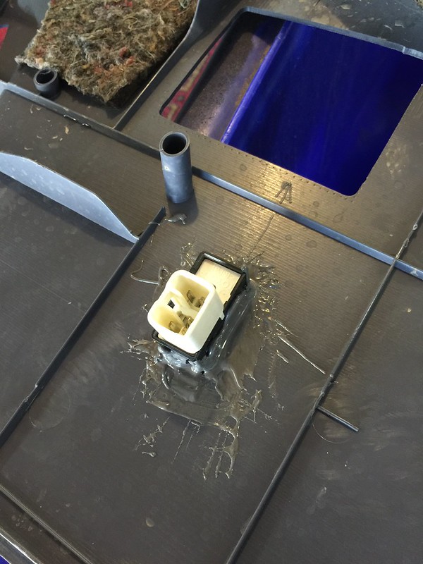

JB Weld the switch in
IMG_3979 by 4Running Daily, on Flickr

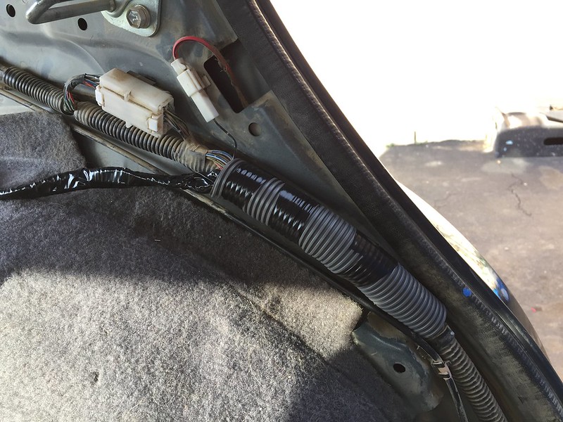

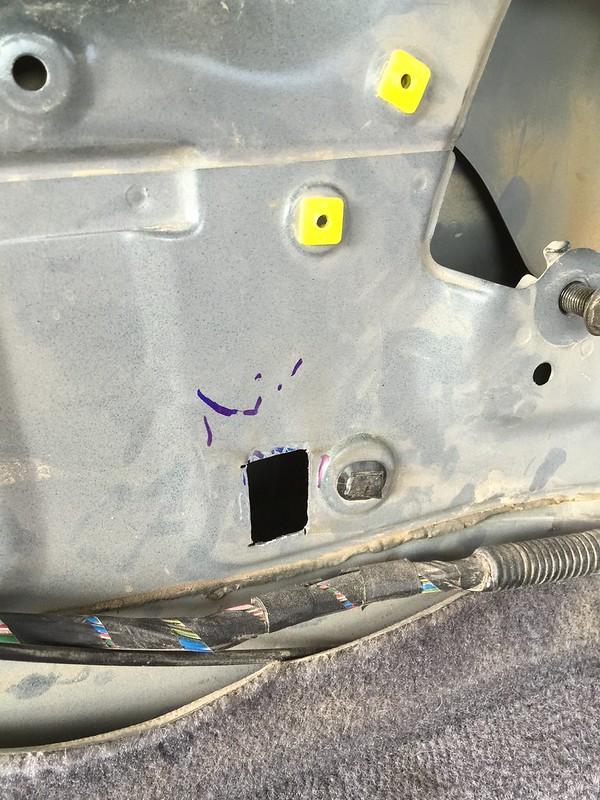

Cut a hole in the metal behind the switch. Stick your make shift wiring harness behind the metal and wire it through the hole you cut and connect it to your switch.
IMG_3982 by 4Running Daily, on Flickr

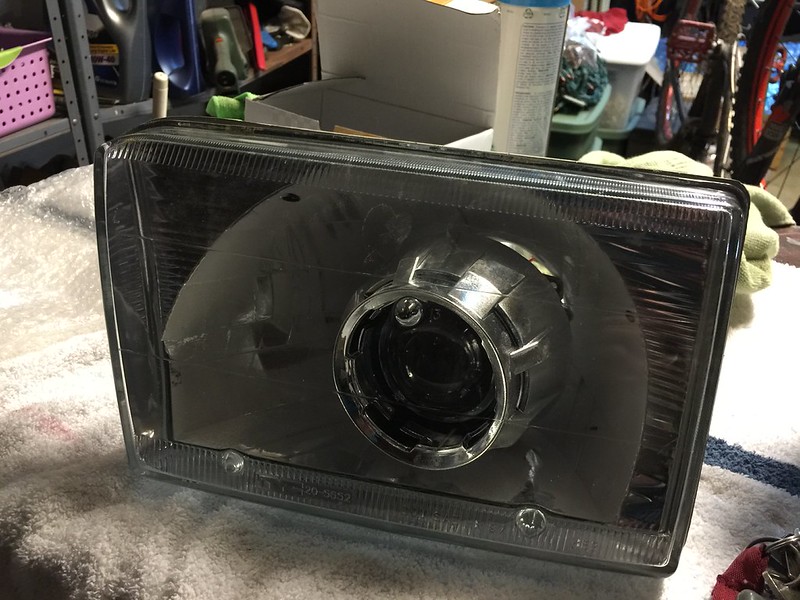

Made some progress on the headlights today
Baking the headlights in the oven. 350 degrees for 8 minutes
Untitled by 4Running Daily, on Flickr
A man is only as good as his tools ;)
Dremeled a large hole in the back to see what it would look like all together
Tomorrow I'll hopefully drill the hole in the back of the other headlight, drill some holes for the mounts, and maybe start the wiring. I'll be pretty happy if these are done by Friday and I can drive up to the meet and great with them.
Looks good but be careful baking the housing like that. If it's too hot or in too long you can melt the housing. That would suck.
The back housing on the stock headlights is made of a thermoset. Its not going to melt, it will just burn, but at temperatures way higher than 350. 350 wont even burn paper. The corner markers on the other hand are made of pp and acrylic, getting them apart without warping and melting them is hard. Putting them back together is nearly impossible.

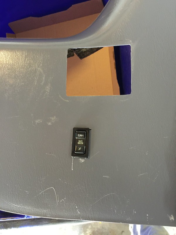

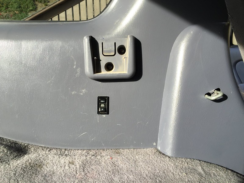

Did this today. Now I can roll down the rear window without moving while camping in the back. It turned into an all day project. But it looks clean and it works.
I do this with my key fob when I sleep in the back, but I know not everyone has that option on their fob. Can you disable the switch? My worry would be cargo hitting the button and rolling it down when you least want it to.
There is no way to disable it, it is pretty out of the way though. But I understand your point.
I thought you were painting them? Or the CRT screen here at work blows.
I spot some cookies though.....
I wil be painting them. Everything is just sitting inside the headlight in that picture. Nothing is mounted quite yet. I have some more dremel work to do.
You should be able to setup a basic $3 relay with the trigger voltage connected to a parallel split off the ACC 12V ignican wire. The one that goes into your aftermarket stereo and tells it to power on but does not provide the power. The run the power wire off that new relay all the way back to the window.
That's a lot of work and probably not needed. I wouldn't do it but if I had to that is how it would probably go. Assuming I didn't miss something.
I think what you did is a pretty cool and original mod. The chances of camping gear opening the window are pretty small.
It's actually already set up so that it only works with the key in the on position.
