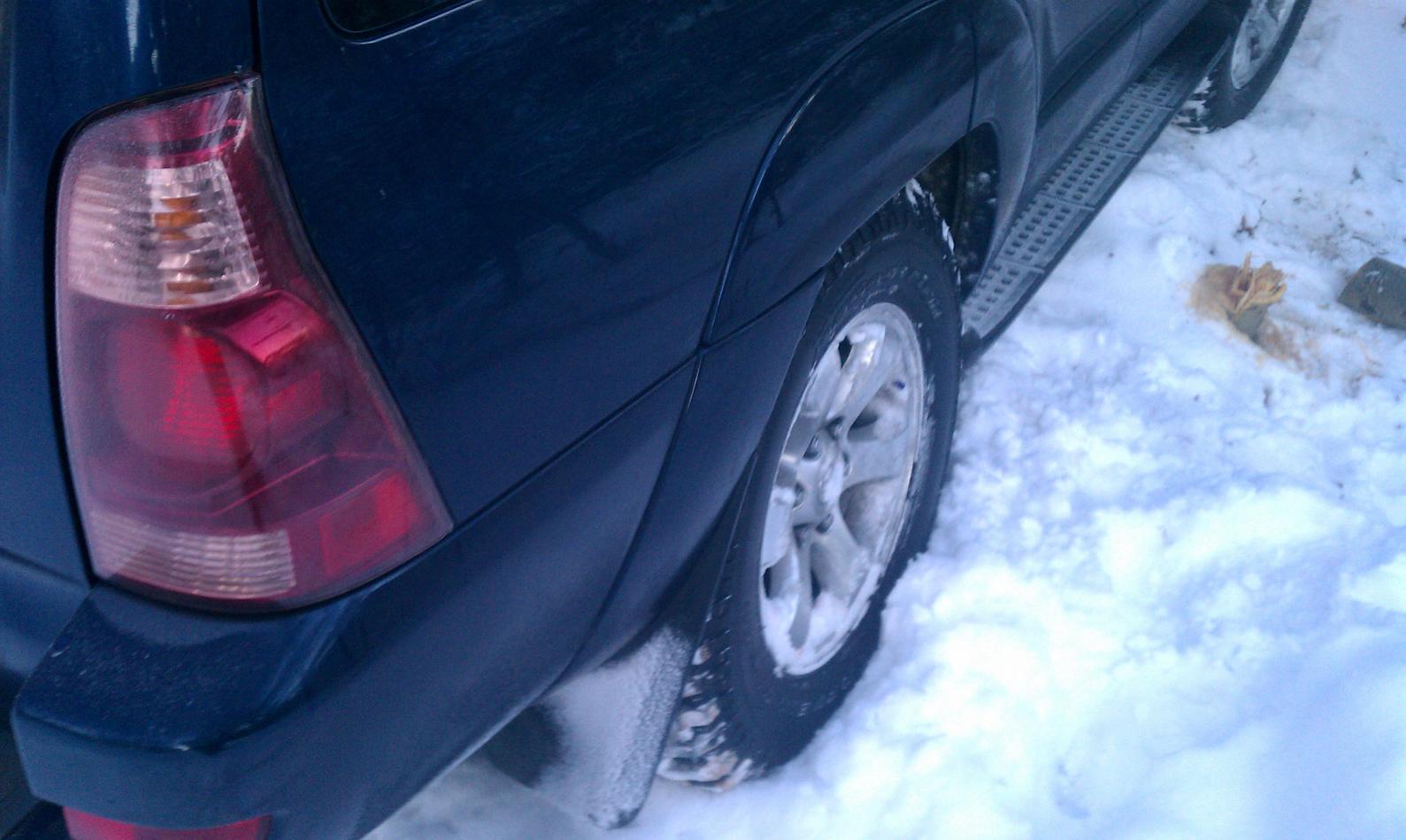

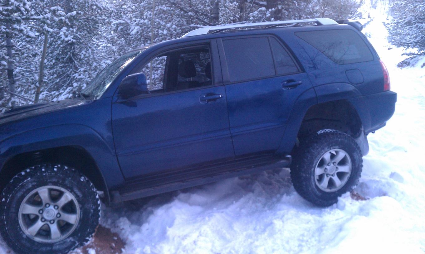

well looking on the bright side I know my rear tires don't rub at full compression
