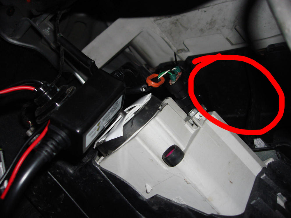

first ballast was mounted on the bracket for the power steering fluid, (saw this done on another post on t4r!) I used double sided tape, then wire ties!
second ballast i put infront of the headlight, near the battery. I mounted it on some bracket, and used double sided tape (not as much to hold it as to prevent the two things from hitting each other) then used wire ties.

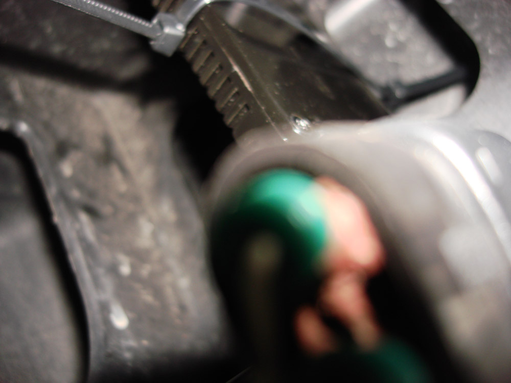

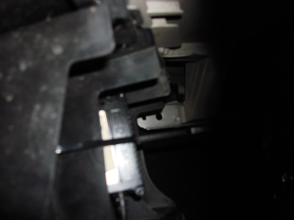

Im sure anyone who tried to mount ballasts down there realized that there isnt much of a place to put them, so I found a pretty sweet spot. above the headlight, near the location of where the bumper ends (each side respectively) there is this black part. I taped the ballast there, then took a wire tie around the back and held them into place (probably easier to take pictures to show, I'll show them soon :D)

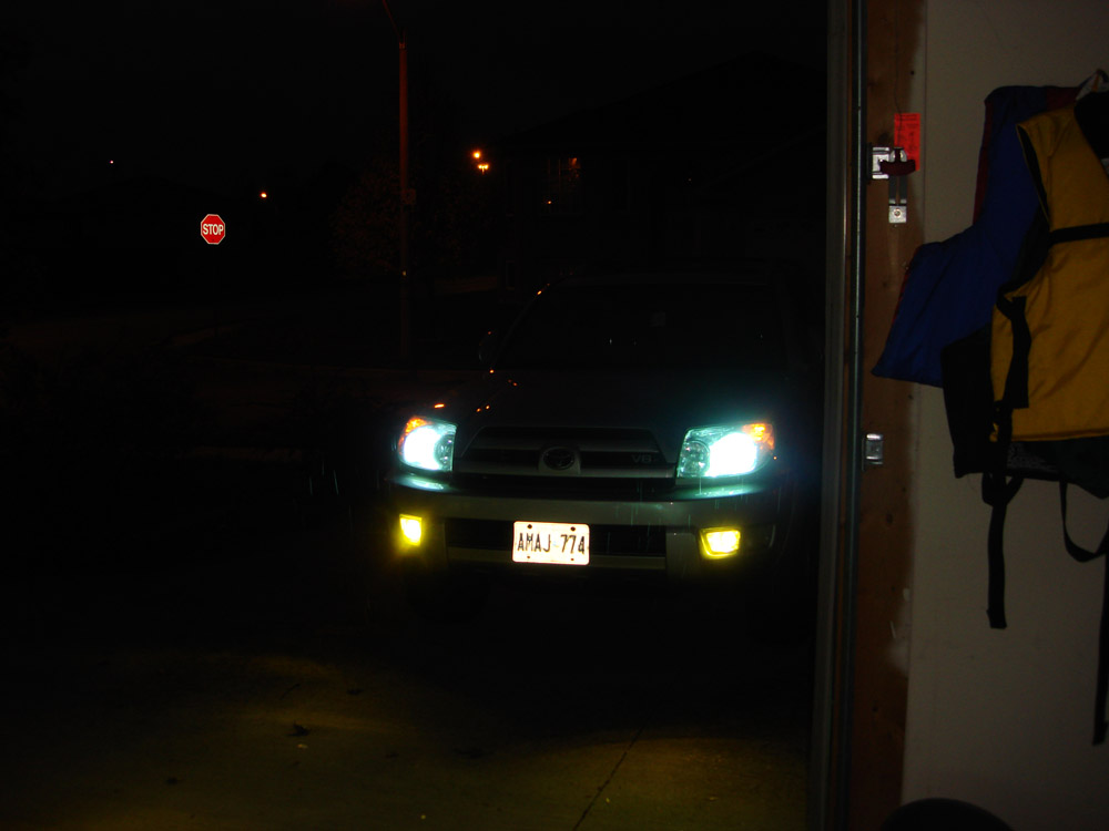

and then, I used the knobs on the headlight to lower the headlights.
(haven't received any flashes from on coming traffic! :D)

8000k in the stock head lamps produce less lumens than the factory halogens and look ricey. Also I wouldn't recommend DDM to anyone, if you want cheap Chinese lights order off eBay or Amazon. They're cheaper, ship faster and same quality.
I've heard good things about ddm, never anything bad. I don't like 8000k, too blue, and really shouldn't have HID in that housing, but I'm interested to see a pic of the fogs on only.
Thats your personal opinion, a lot of people have used DDM here and are happy with what they bought. + a life time warranty. Also, when it comes down to ricey I have to say thats also an opinion, and I liked the look. :)
Yeah I know! I've heard that countless times. But, its only temporary. I'm saving up for a full quad bi-xenon retrofit :D (will post pics once completed.) and I'll be sure to get a picture of just the fog lights :) Pictures look a little decieving, its actually not THAT blue :o I thought it would be more blue, but its pretty white.
Ballast mount locations*
I mean I thought they were the perfect spot :D! heres to anyone who was looking for a place.
