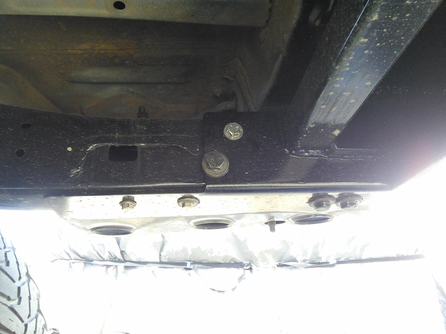

How do you have most of the bumper cut out without planning for the mounting? I'm an engineer and that just hurts my brain. :D
The 4x4Labs rear bumper requires cutting the rear crossmember but it bolts to the factory tow hitch weld nuts underneath the frame rails. Also to the insides of each frame rail with plates w/ weld nuts you fish inside the frame through the ends (where you cut the frame crossmember off).
Probably all the aftermarket bumpers out there mount to those weld nuts underneath the frame rails so that would be a good place to start.

Thanks man, that's pretty much where I was going or assumed.
All of the "shell" i've already cut out. I thought it would be easier to Engineer the mounts after I've tacked the center section together. Didn't really wanna take the time to model up the whole Assy in Solidworks.
I was just curious how all the main bumper fabricators were doin it.

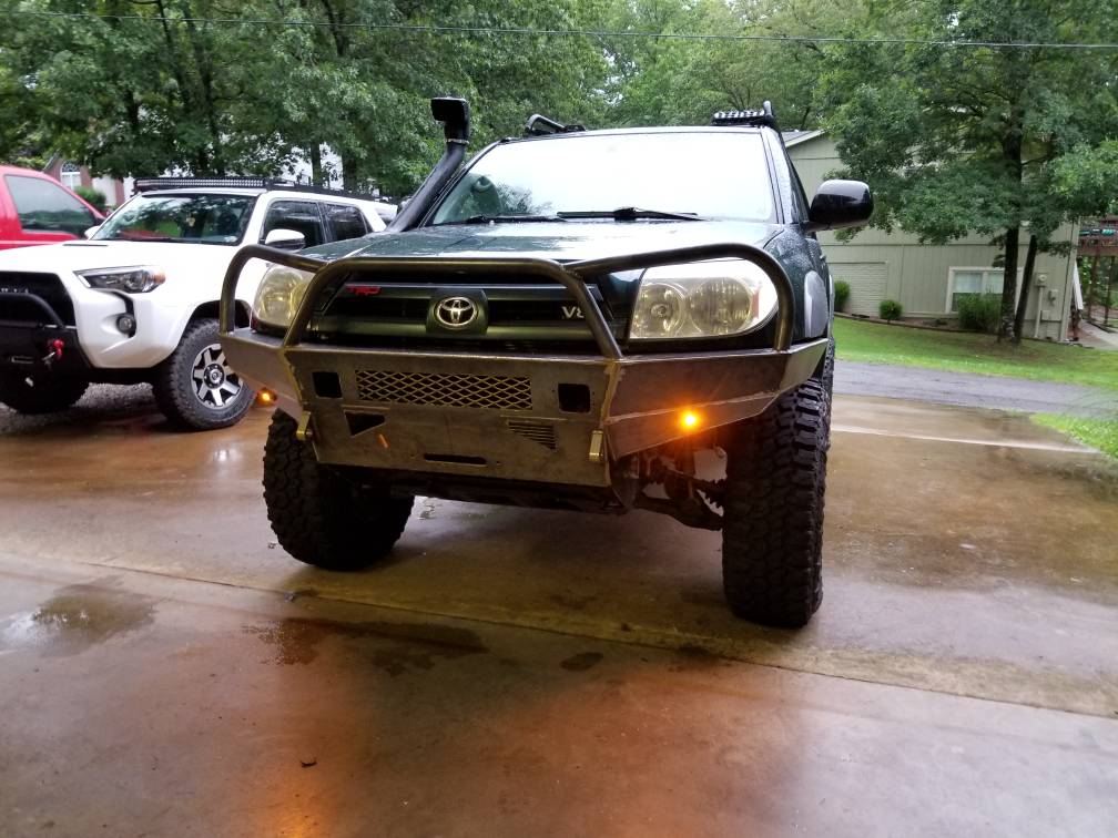

Addicted Offroad Tube bumper with hoop and grille guard. I'll know in about 4 weeks how I like it.

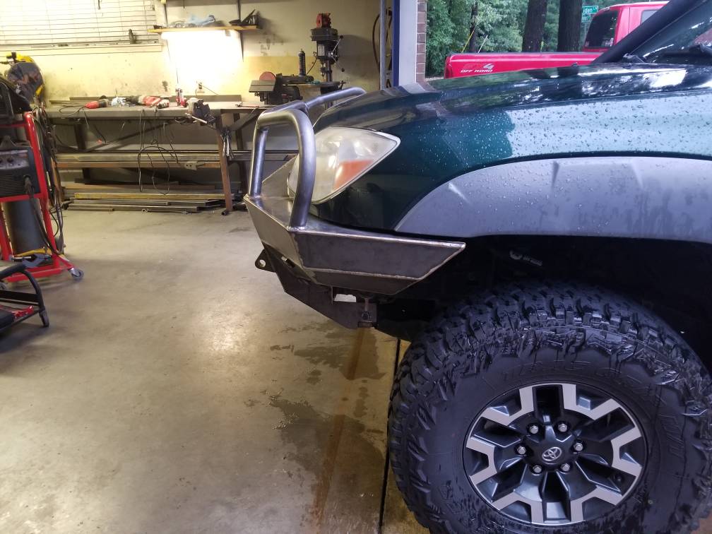

Sent from my SM-G950U using Tapatalk
Wow that's pretty impressive, what material did you use?
Sent from my Pixel 3a XL using Tapatalk
Thanks. It's mainly all 10 gauge plate. Normally do 3/16 but was trying to keep weight down. The tube is 1 5/8s 120 wall. It's all finished now other than bed liner. Just had it sand blasted. I'll post update pics when it's done.

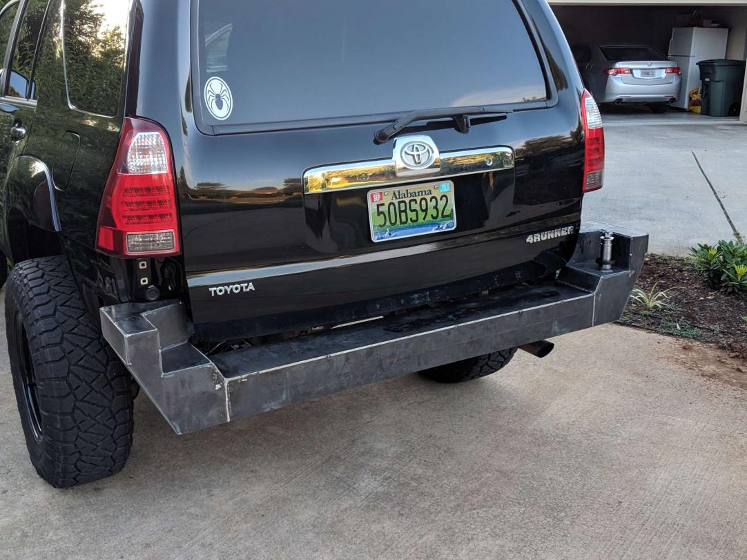

Bumper I designed, just all tacked up at the moment. Made out of 3/16 and 1/4 inch A36.
Hoping to get the tire carrier done this week.
Off to powdercoat after that.
