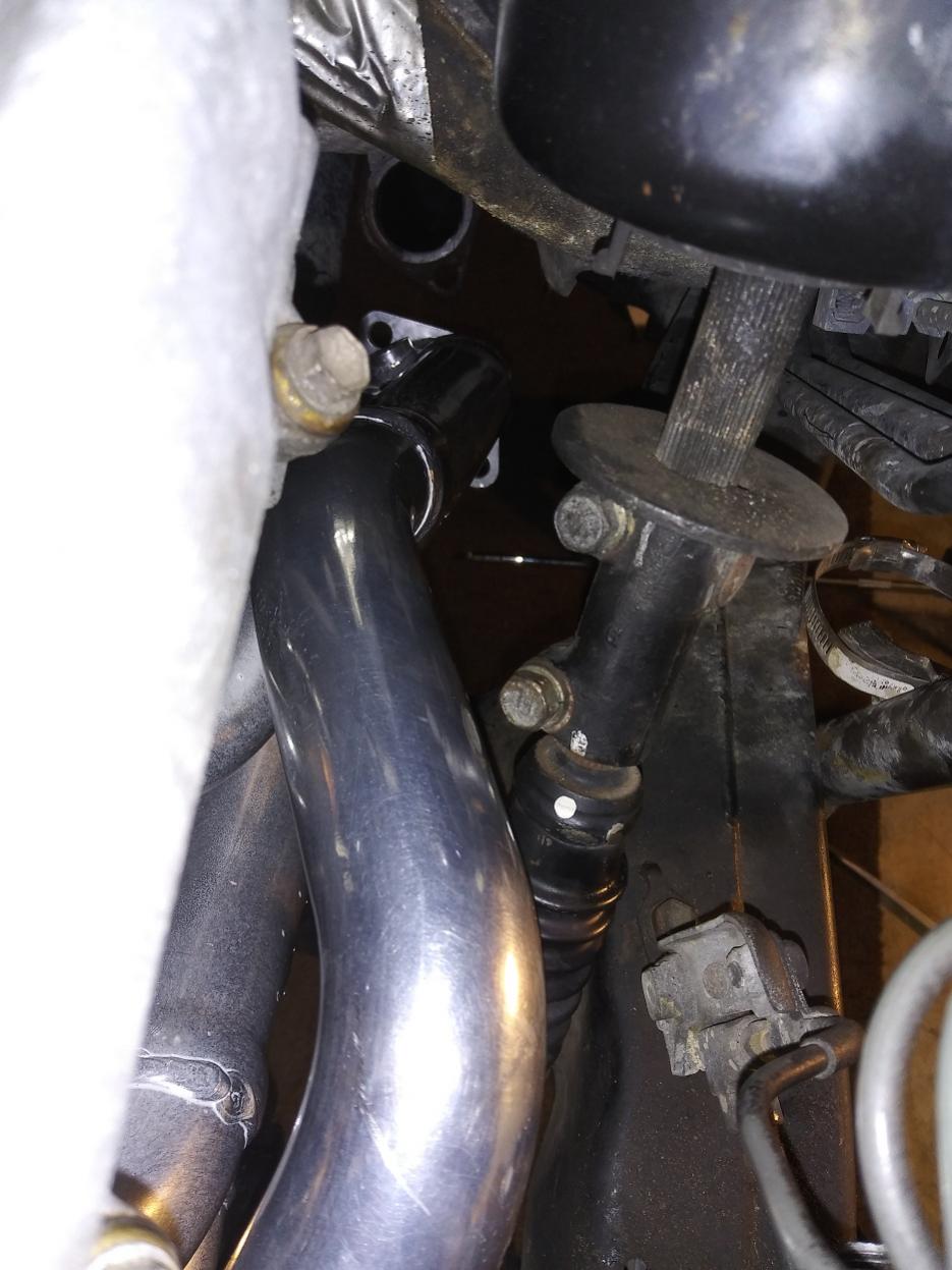

Is the steering slide clamp the nut under the hood or the joint on the driver’s side of the firewall where the steering spacer normally goes?
Reviving an old thread. I have the Toytec 1” body lift kit ready to install when it gets warmer outside (Chicago area).
This is the steering slide clamp, there was just enough stretch for mine.

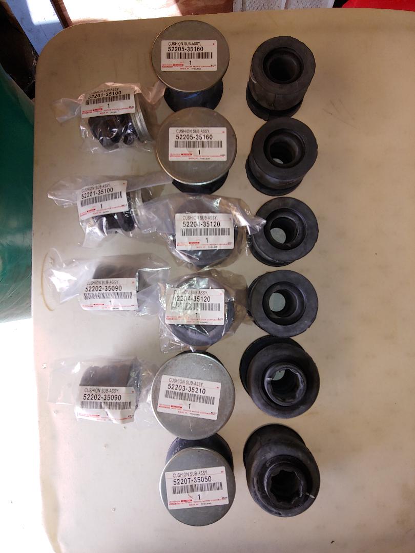

No worries, love the humility. I actually had to think twice before I posted because its been a couple years since I installed mine. I was actually kind of intimidated by this job, but it wasn't too bad. I recommend new oem body bushings when you do this install. They're not cheap but way worth it. Two years have past and the truck still feels very solid. Best price I found was Partsouq.com.
