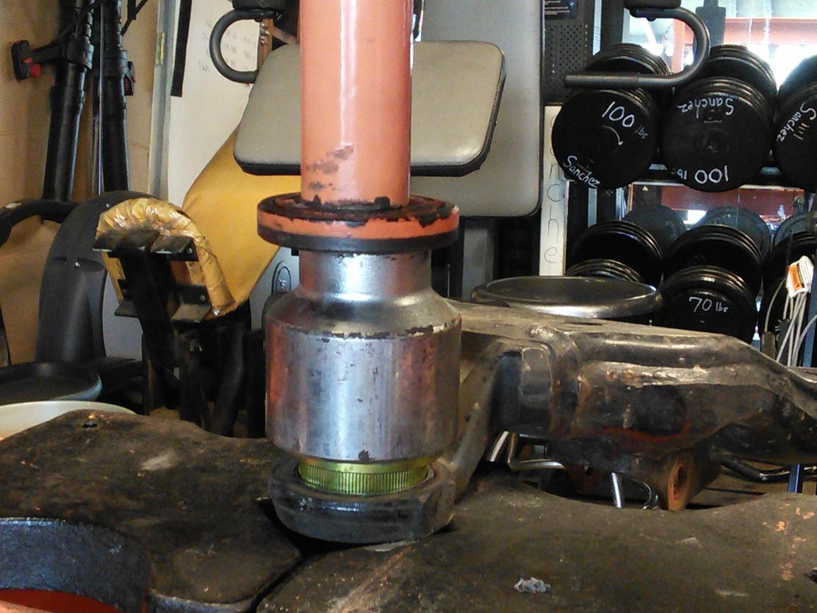

Whose changed their LCA bushings? Now that I know they're bad my rides deteriorated in my head lol but srsly is it easy? Seems easy
Going to try tomorrow, was going to a couple weeks ago. My neighbor has presses to help with, but, didn't put any heat to them to pop them when I did my poly bushings. Just follow the direction, and if your using a press and they don't budge, put some heat on the LBJ only and it usually will release when pressed.

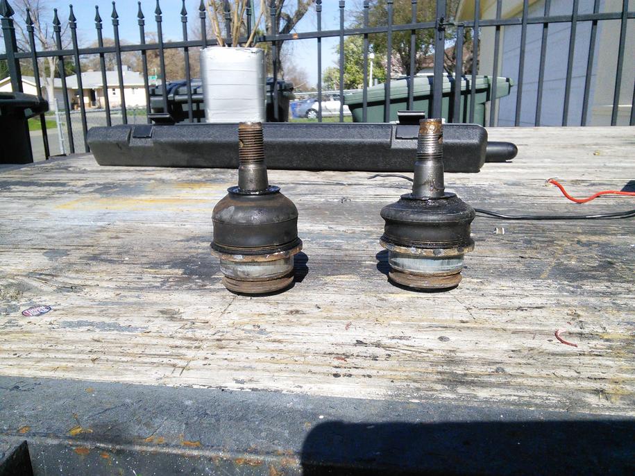

[MENTION=87687]LTDSC[/MENTION]... Here you go Sam, pressure with heat to remove.
Old ones and new going in.
Check out my build for a writeup on the bushings. Swapped to poly few years back. It's easy but takes some time.

Have you considered just replacing the whole arm? My lower balljoints have seen better days and I've been contemplating just replacing the whole thing at once. From what I've read it seems like a huge PITA to press the BJ's out and melt out the bushings. I'm sure I could do it but I'd rather save myself the hassle and have a completely new assembly to just bolt in.
I looked into it but mines only bushings, the BJ is still fine. The replacement arm is around $400 each. I looked at Total Chaos but they want $1500 for OEM replacement. So thats out. Ill just do the stock replacement bushings for now and wait until my BJs go out and fight them to replace if needed because of the ridiculous cost.
When you heat them up, look for when they separate from the housing like the first photo, and do it around the entire shaft. All the post I found just say to get them to start to smoke and never showed this. I did the smoke thing on the first one and was a mess. Second shot shows how easy they slide out and very little to clean up. Let them cool a little and continue for the center.
Honestly, if you have the arms off, I would do your BJ at the same time.
