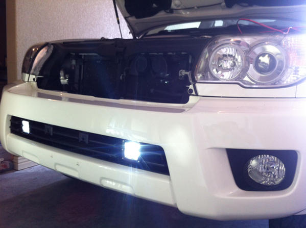

Lightbar mounting
I have the brackets, but my drill won't fit into such a tight spot. I couldn't get the front bumper to come off, so anybody have suggestions on to do it with the bumper on?
I did not remove my bumper to install the bracket for this light bar. All you need to do is remove the bolts to the crash bar and install the bracket and put the bolts back on. I used the end of a jack handle as they are on tight. I used a Dremel tool to cut the plastic grill hole out. Not hard, just take your time.
