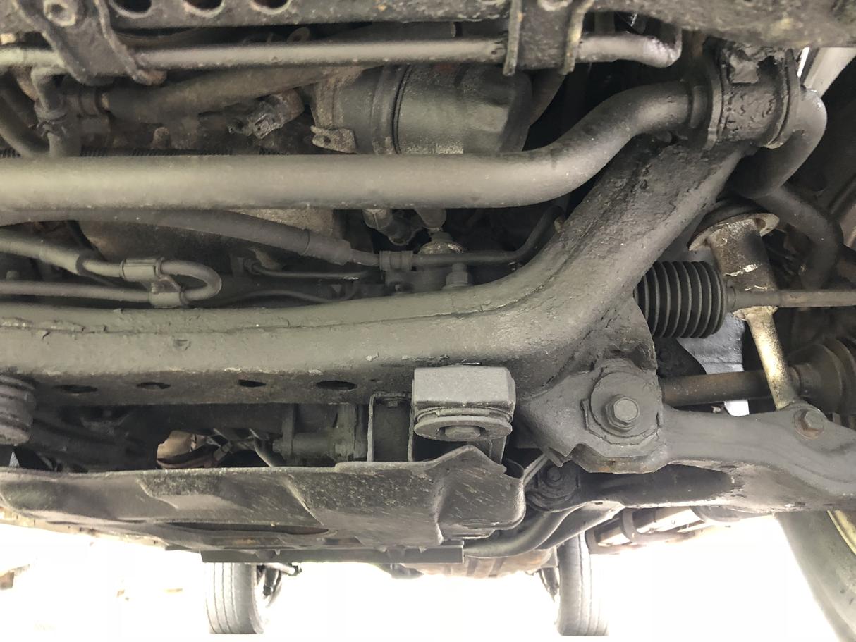

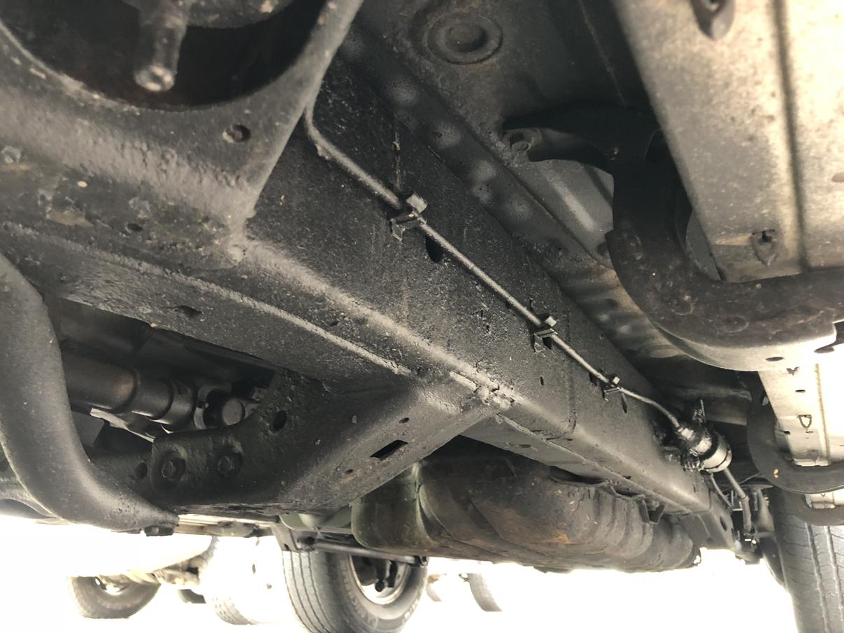

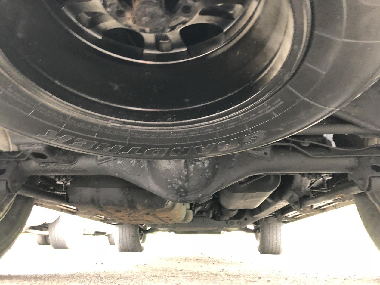

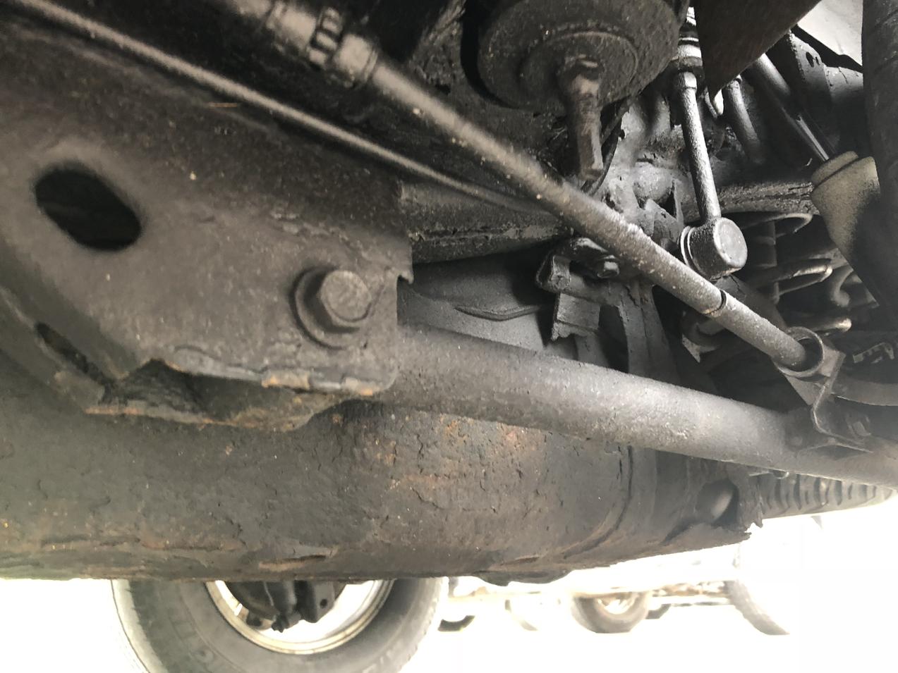

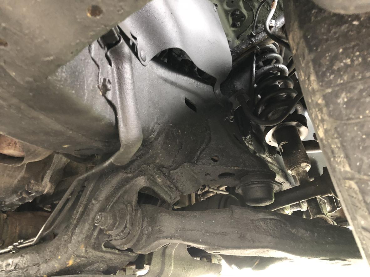

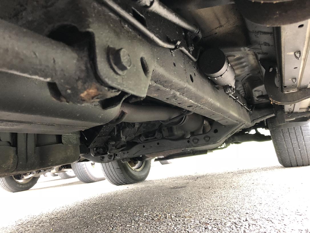

Need advice on underside pics of vehicle I'm looking to purchase
This seems like as good a place as any to get some feedback.
I've been looking for a low mileage V8 4wd but everything I've come across looks like it's been at the bottom of the ocean for the past 10years. First and foremost this will be a daily driver, but I want to build it up for overlanding and light offroading (toytech 3" with 5100s and 285 KO2s.)
What's your position on these underside pics? Anything you see here that would make you pass on this one?
West Virginia vehicle, V8 4wd under 100k:
It looks like it was undercoated at some point. My concern would be if it was done to hide some bad rust so it looks better/sells easier, or even if it was done with good intentions a bad undercoating can actually make rust worse. Personally, I prefer seeing surface rust rather than undercoating since I like to go through and undercoat slowly and detailed myself and I like to know exactly what I'm starting with; hard to tell in this case.

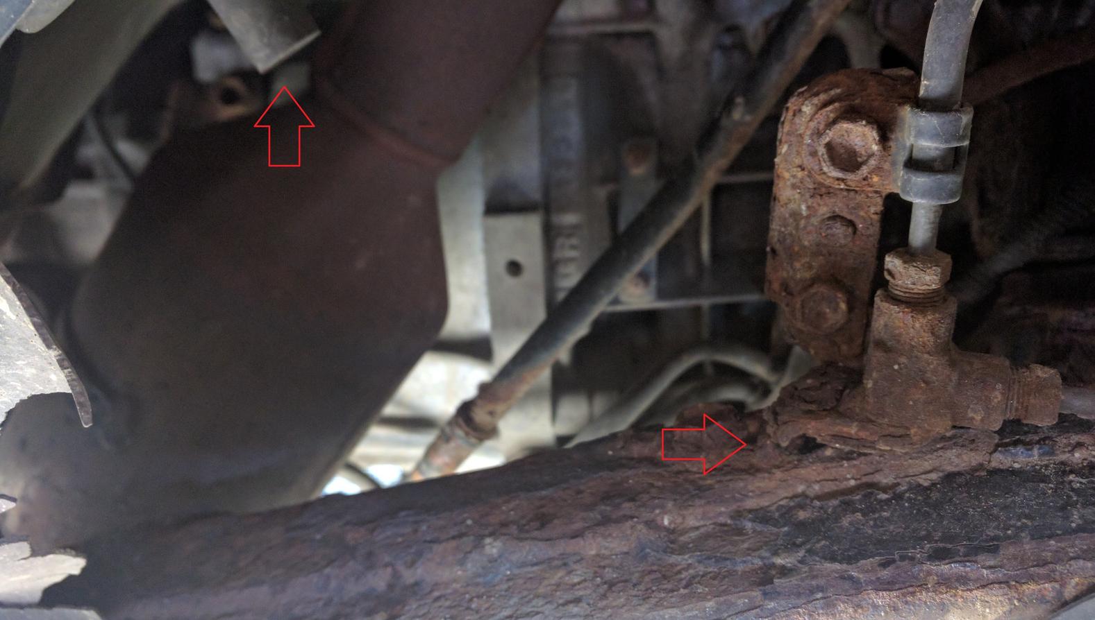

Pre-purchase inspection done: new pics
Update, had the vehicle inspected by a local Toyota mechanic that sent me the following pics. He described it as "pretty rusted," but flaking and no signs of any holes and only apparently surface rust. The worst areas:
view
view
view
view
Otherwise the inspection was great. Body was in good condition, no check engine lights cleared recently, no leaks, (already has a Flowmaster exhaust added, bonus.) He mentioned it needs tires tomorrow, and likely a power steering pump in the near future, but otherwise was in good condition for a sub 100k mile 15yr old vehicle.
Really don't understand these forums. My reply shows up but the image links I included seem to have dissapeared. Does a moderator need to approve my picture links before they show up or something?
In those worse areas, I would apply a rust stopper like a Por 15 to the area and beyond to a 'clear' area. And keep the frame maintained by coating it with some if the ways that I posted a link about earlier in this thread. You got a keeper!

If you look at the picture with the oil filter visible you can see undercoating on the filter, which means it was done after its last oil change. Looks like the undercoating is meant to hide rust.
I definitely agree with you. Im getting my underside professionally undercoated at line-x in a month or two and my friend who works there showed me some pictures of a 4th gen they had done and the difference is night and day from this. I would be very suspicious
