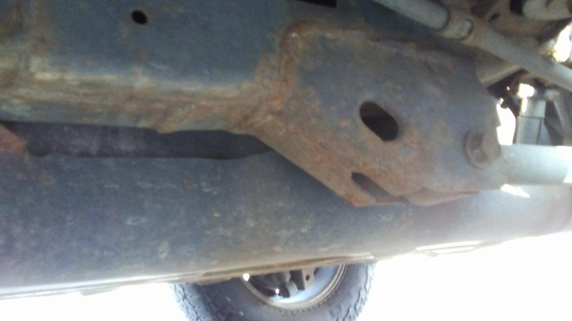

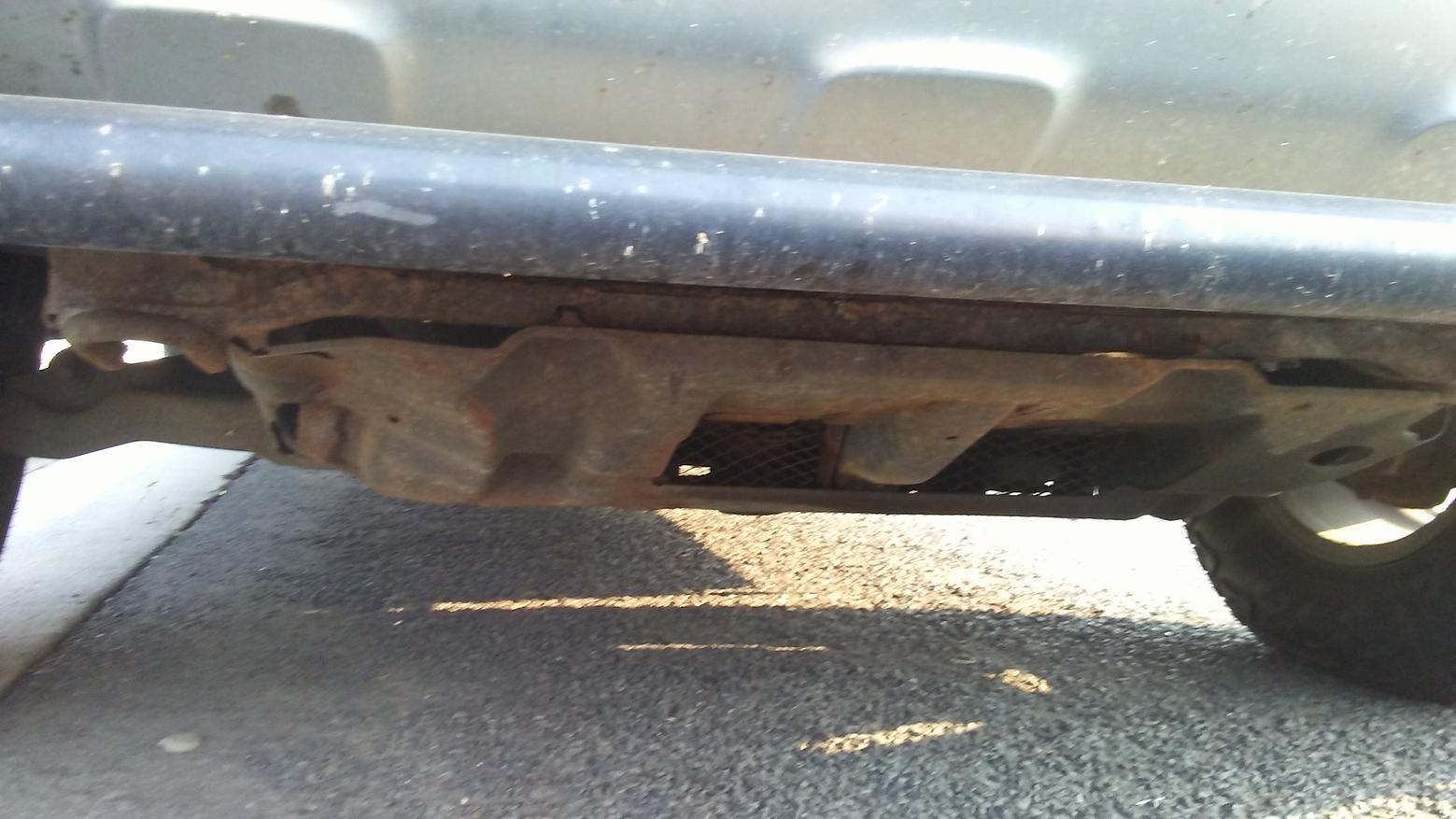

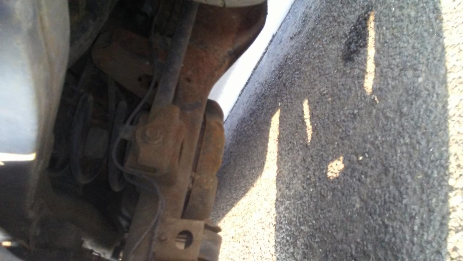

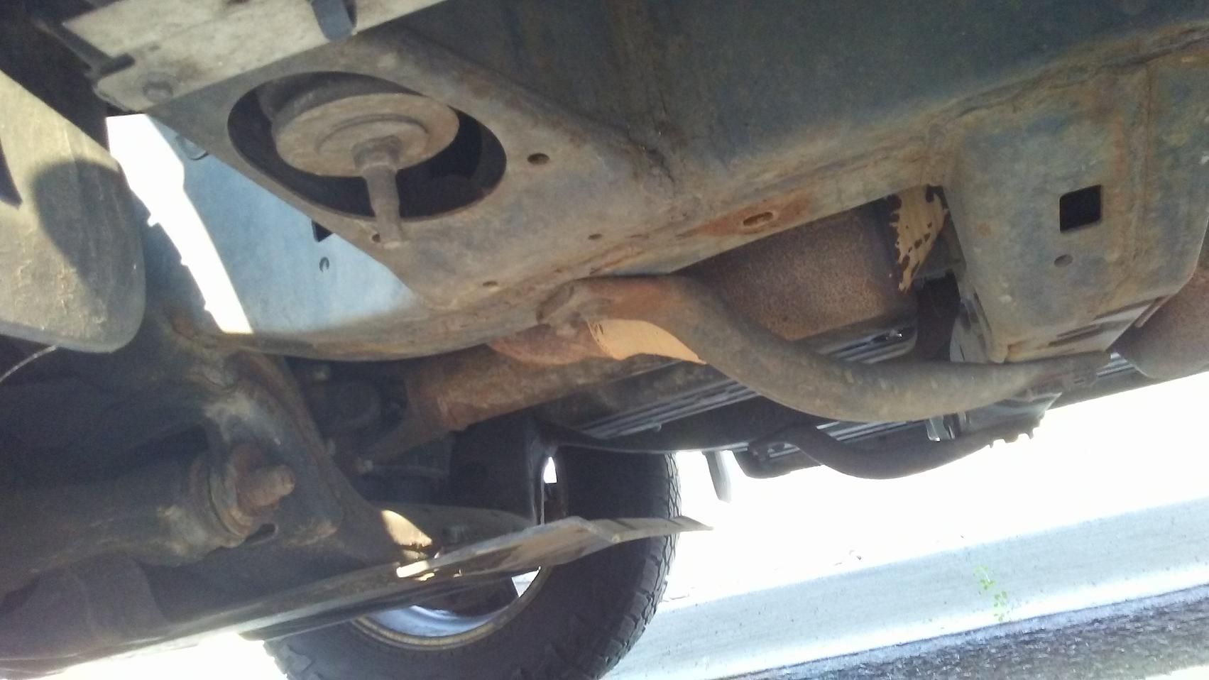

Didn't get out of the NE quick enough. How bad does it look?

Just looks like all surface rust to me, but take a big screwdriver and hitting it with a hammer check any areas that may look really bad
to see how solid the metal truely is, if you don't find any areas that need the rust cut away and new metal welded in clean the frame with a
wire brush and wheel and or a "flap" sanding wheel to remove the worst of the surface rust and then spray a rust converter on the entire
frame!

Thanks! Now just need the time and tools to work on it. The welding skills are not on board, but I'm sure I can find someone to help if it comes to that.

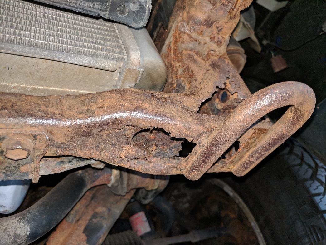

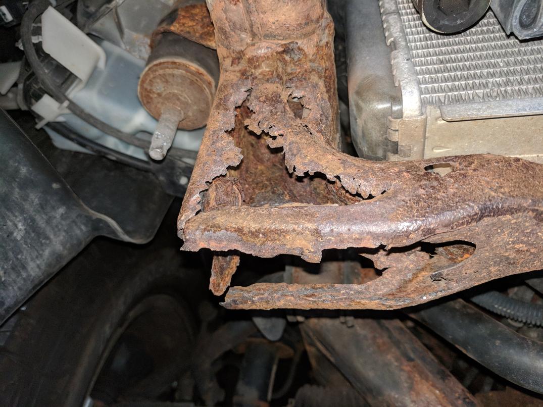

I just bought this 2003 V8. Thought it was surface rust on the cross-member under the radiator. Turns out its totally rotten. Rest of frame is good. What should I do about this?

I'd say find a local welder and see what they'd charge to fix it up. As long as you're going to be looking at getting some work done, make sure nothing else needs welding. I highly recommend whacking the whole bottom of the frame with a hammer to make sure there's no soft spots. My whole frame is solid other than the same spot you have (although to a lesser degree) and a spot midway down the frame on the passenger side about 2"x4" that I discovered with the hammer.

Thanks both of you - made my day after discovering this. I don't have to get rid of this nice V8. - Also can you direct me to a front skid plate for an 03? Can't seem to find one via google.
