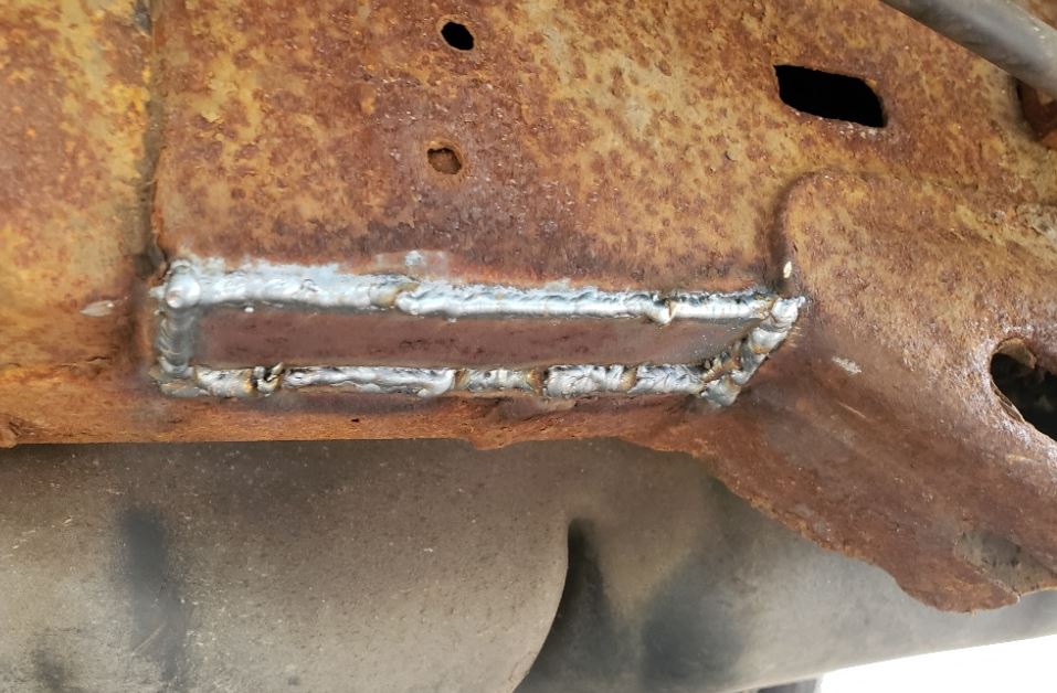

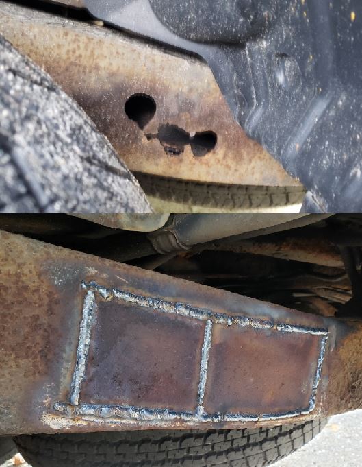

Here's this years rust to contend with and my fix. I also ground down the welds a bit and painted the area. The dark brown area in the before pic was all junk. I had to cut back around 10". The bottom frame section was small-ish but the frame was full of dirt and acorns right there. :tsk:
Not sure how long I can keep doing this.
like they say, till the wheels fall off. least your able to do your own work.
I share your pain and concerns, I have an '03 V8 limited and just did some more rust scraping/sanding/painting the past two days on rear portion of frame and axle housing. I had two plates welded into my frame a couple of years ago at cost of $1000, so as was said, at least you can do your own welding until there's nothing left!!
True but I never would have bought this truck if I couldn't do my own work. I'd have something newer and I would have less money in the bank. :-)
I'm just concerned the next hole will be in a place that's tough to get to. I stopped bothering with the scraping and such, all but one of my rust holes started from the inside.
