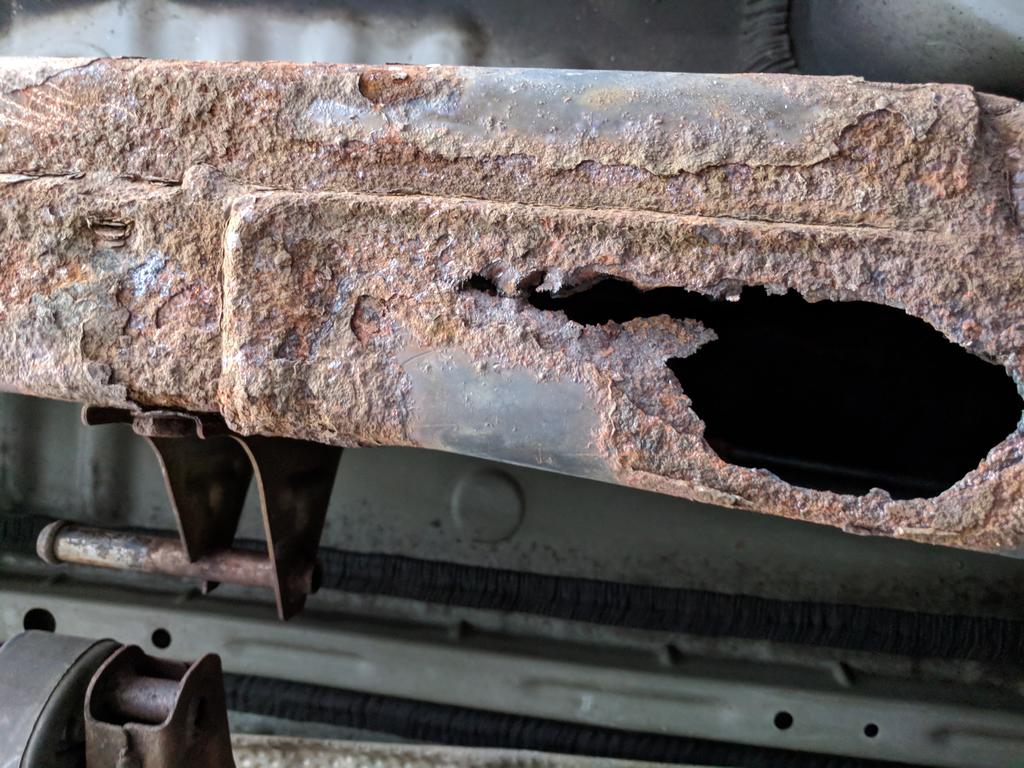

4th gen frame rust
Seems like you can buy that piece. Someone in the thread below bought it and had it welded in at a shop.
http://www.toyota-4runner.org/4th-gen-t4rs/139668-replacing-front-cross-member-under-radiator.html
Yes you can buy the crossmember, I posted a link to it on the previous page.
Thanks both of you - made my day after discovering this. I don't have to get rid of this nice V8. - Also can you direct me to a front skid plate for an 03? Can't seem to find one via google.

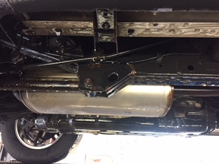

resurrecting this thread. I just got into an 03 V8 with a hole on the underside of the frame. I would like someone to look at this and see if it needs reinforcement. How do i go about finding a good frame welder?
Any good welder should be able to do the repair...IF he has enough solid metal left there after he cuts out all the rust, can't weld rust,
hopefully he can find some solid metal and if so he needs to make sure the frame stays straight and supported as he patches it back together

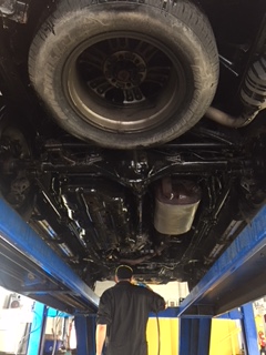

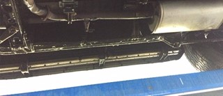

Yes, but unfortunately I am not a seasoned expert. I thought it was just surface rust and now have learned an expensive lesson.
Sent from my Pixel XL using Tapatalk
After repairing the holes I recommend a weekend spent underneath with a wire wheel, primer like Corroseal, and chassis paint. Spray and clean everything 1st then wire brush away followrd by a nice coat of paint.
After the paint is cured use something like fluid film to protect your work.

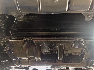

I just bought this 2003 V8. Thought it was surface rust on the cross-member under the radiator. Turns out its totally rotten. Rest of frame is good. What should I do about this?

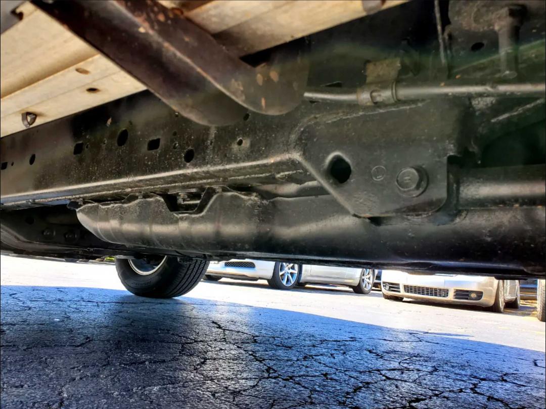

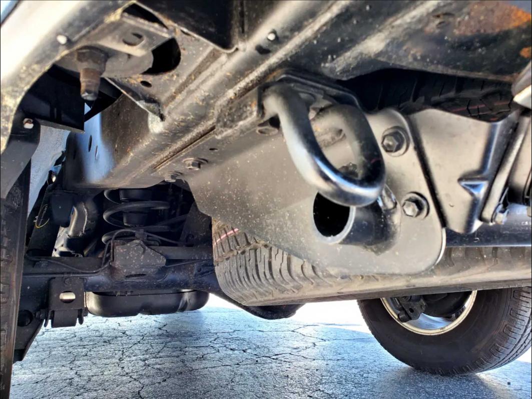

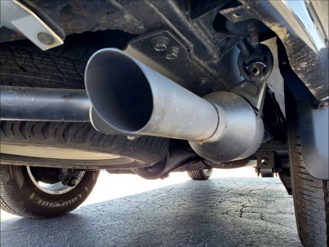

Hi everyone,

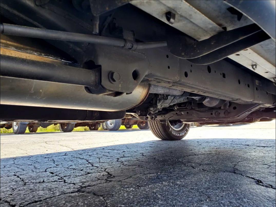

sorry to revive an older thread. New here and looking into buying a 4runner. Yesterday I found this 2004 4runner v8 with 122k miles. Can you please look at these frame pics and let me know if you notice anything I should be worried about? The frame looked clean to me (I'm no expert) but it does look like it was painted or treated at one point.
Carfax history is pretty good and looks like the previous owner did a good job with taking it to the dealer for maintenance.
I should mention that the dealer also has 2 other 4runners for sale and they did not seem to be as clean or have the black coating. My guess is that the previous owner did the job.
Any thoughts / inputs is appreciated.
Thank you.

That frame does appear to have been painted at some point, however still looks like it was clean to start with. I don't see anything that would frighten me, especially in the Midwest.
-Rob
I have an '03 V8 LTD, was under the rear most area just a few hours ago and scraped about a pound of rust off frame , axle housing, various brackets and will wire bush brush another time for painting.
The '04 you're looking at looks pretty good, check bottom of frame below PS front door, this is where the A/C condensate gathered on mine and dripped on floor leaving behind a 10" x 3" long rusted out spot on bottom of frame rail.

Thank you guys for the replies! I will look at that area tomorrow rdruss, I have scheduled a ppi with the Toyota dealer nearby and will have them take a look at that area as well.

Judging by the condition of the lower welds on the rails, overall the frame is in the decent shape. BUT! Given the fact that whatever paint the prev.owner used is flaking off, I'd be really caution and, if possible, poked around with a screwdriver; it's very likely the surface/rust wasn't treated properly before painting, and was rather 'encapsulated'. When done incorrectly, it rapidly accelerates the decay. Pay attention to the inside of rails - some holes are big enough to stick your finger in and feel inside (ugh, sounds a bit wrong :) ). Also, check the front and especially the rear crossmember behind the bumper.
In any case, even if frame is solid, treat it again this summer. And do it right this time.
