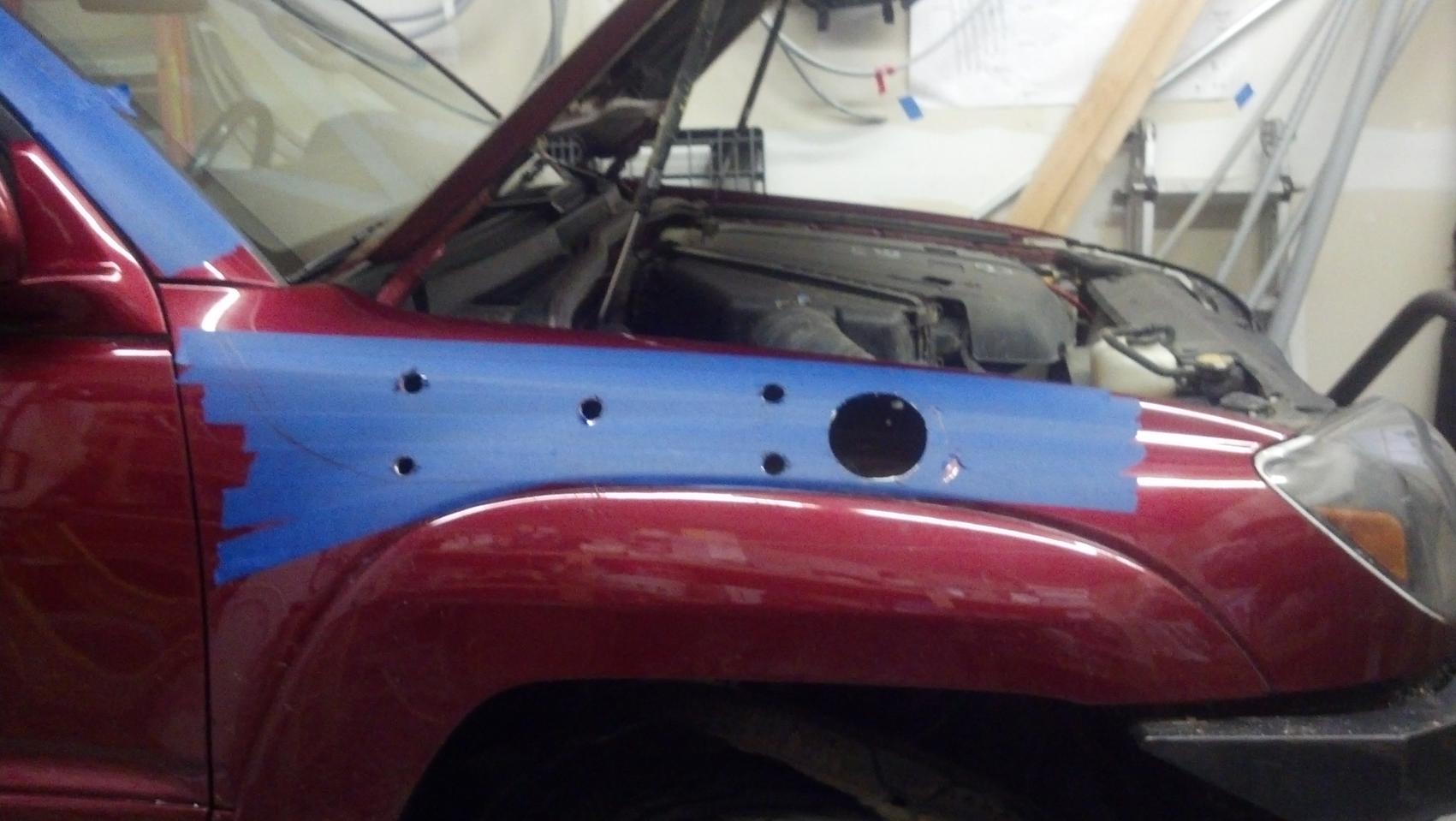

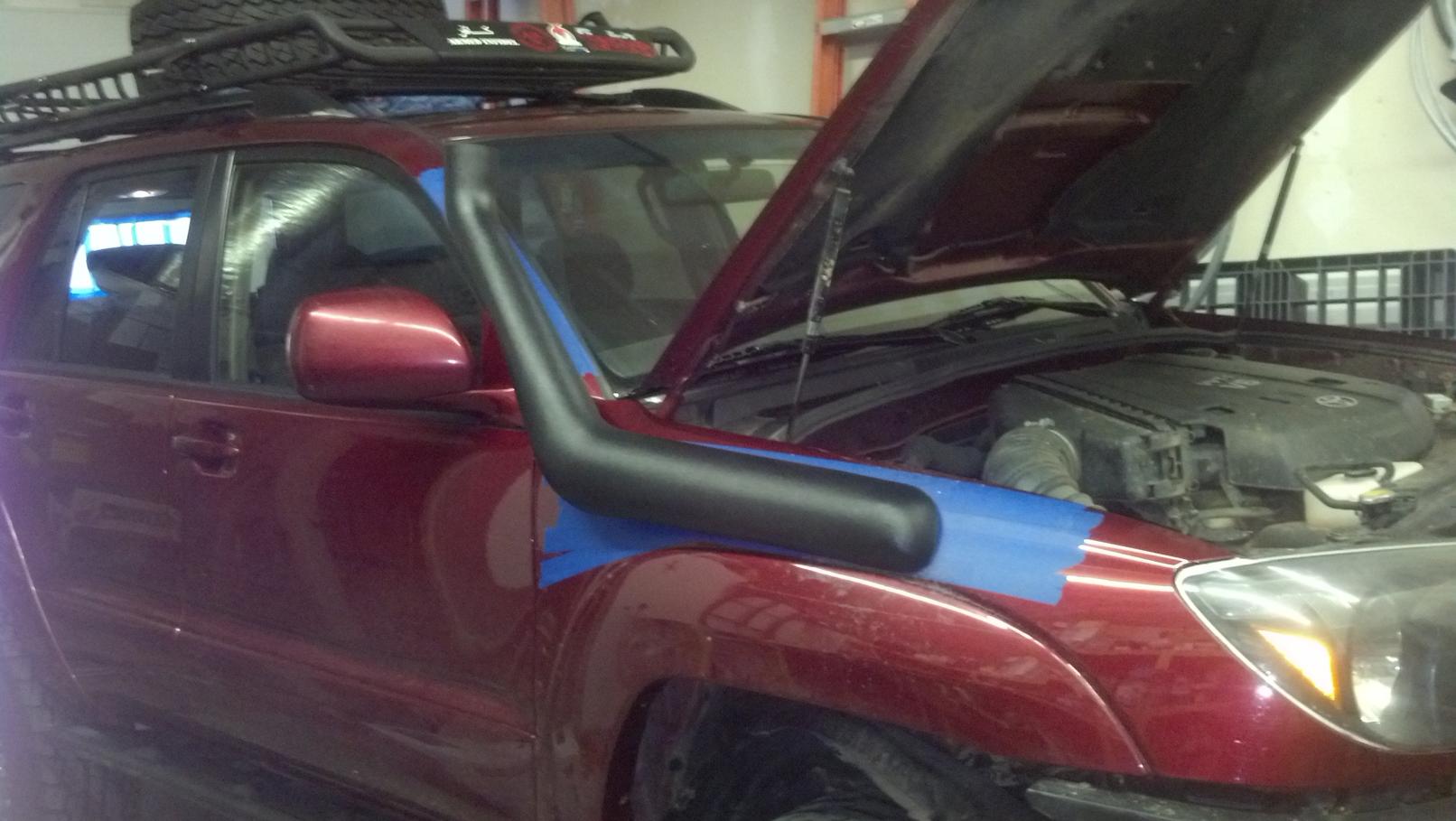

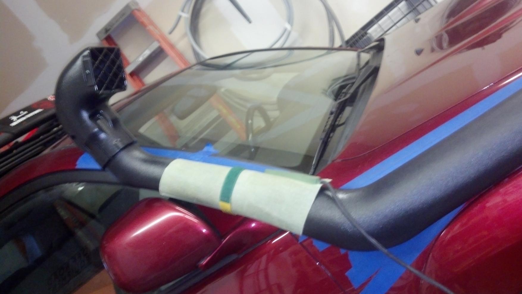

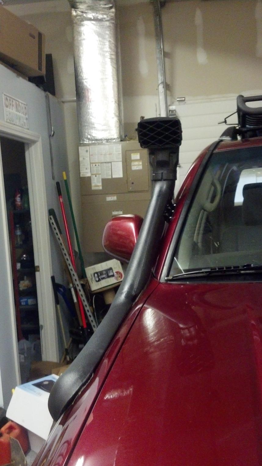

Snork install

Looks great!
How much heating, bending cutting did you have to do to get the fit that tight?
Did you make the A-pillar bracket or was it supplied?
Also, did the kit have the tube that goes from the snorkle to the air box or did you have to make it?
can i see more pics of this?? looks great and fits tight! this has been on my to-do list for awhile now!! you've inspired me to tackle it, haha
Have you got a link to the exact snorkel you got? Also x2 on the heating bending question! Looks really good how well does it sit on the fender? I have been eyeingEbay Snorkel
This has the advantage of not needing to fit the fender as well since it does run across the top.
I got the snotkel because afyer i trimmed the fender liners when installing my demello bumper i vaporlocked my truck in 18 inches of water from spashing water entering the factory intake location. I dont do very deep water but ssh ometimes its deeper than expected. The chinr s e snorkel is the same as the 400 dollar safari. So far the onlyshortcoming is tgat the hardware isnt stainless and is already rusting so i need to get some better screws for the pillar support. I bent the pillar support to fit the angle better. It still isnt plumbed up yet but it will be as soon as it warms up a bit.

How strong/thick is that snorkel? I am asking you to make a value judgement not take measurements. Because I would love to do that but I am scared that here in FL with all the trees and vines i would be getting out every ten minutes with the axe and machete to keep from ripping that thing off. Dang I envy the western guys...
