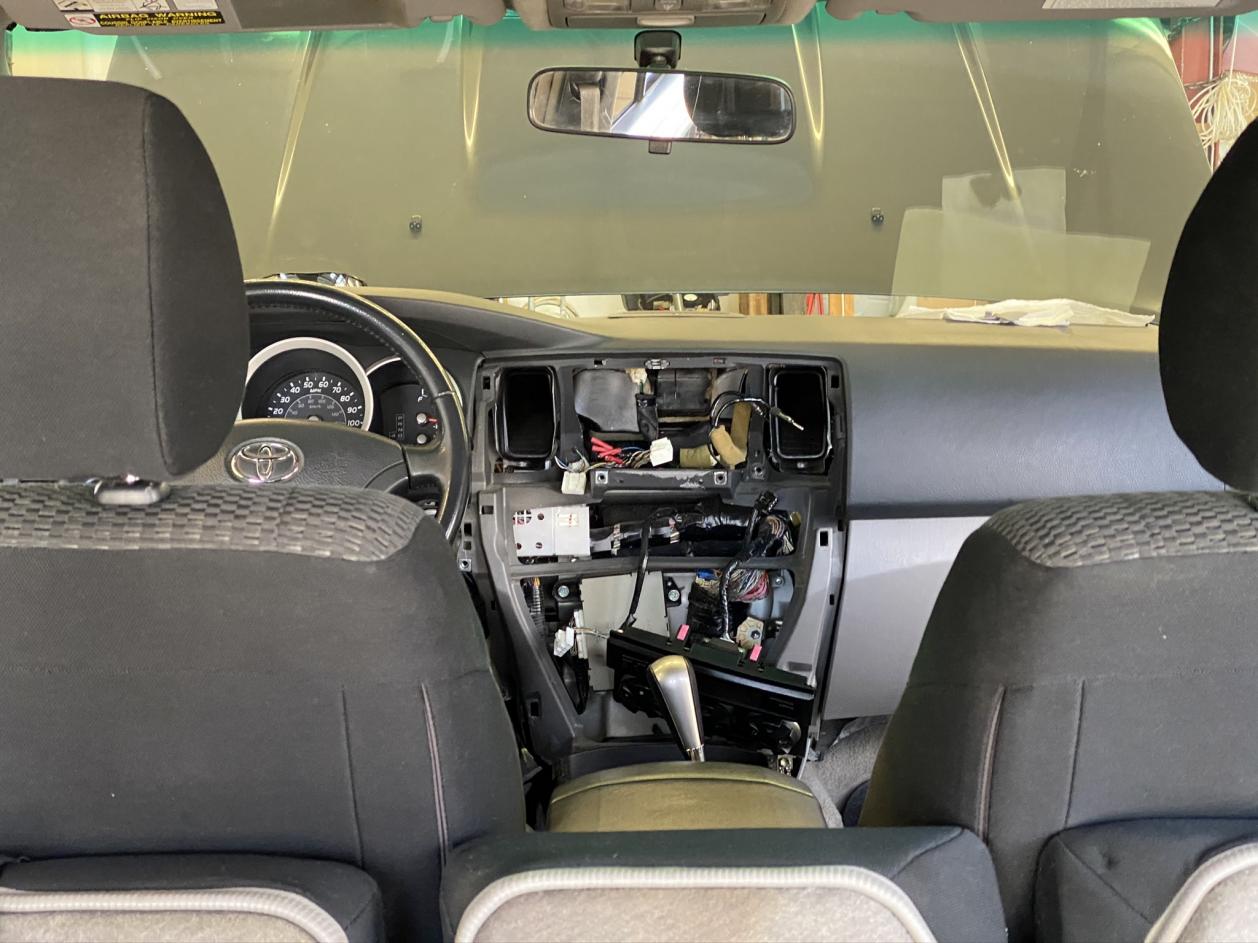

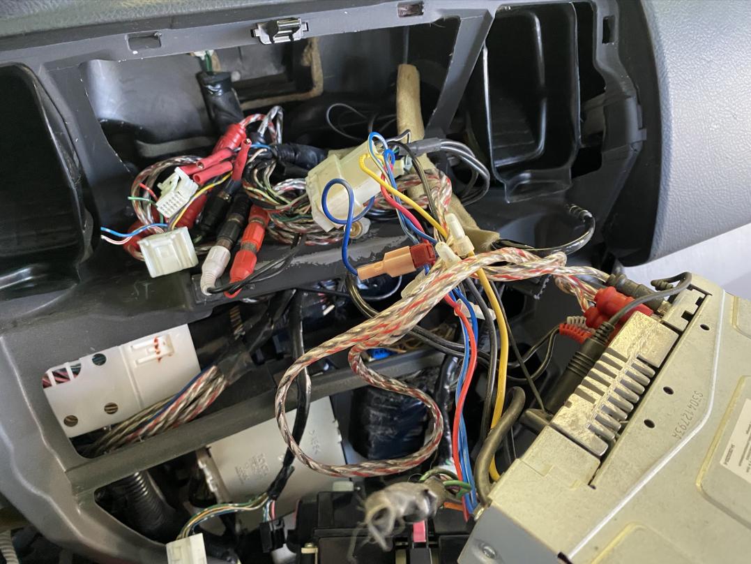

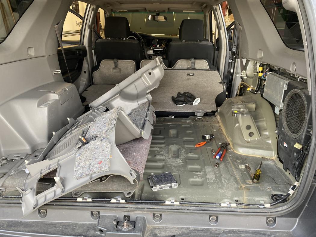

Got the dash pulled apart, crossed my fingers and toes the whole time hoping I didn’t find a cut harness behind there.

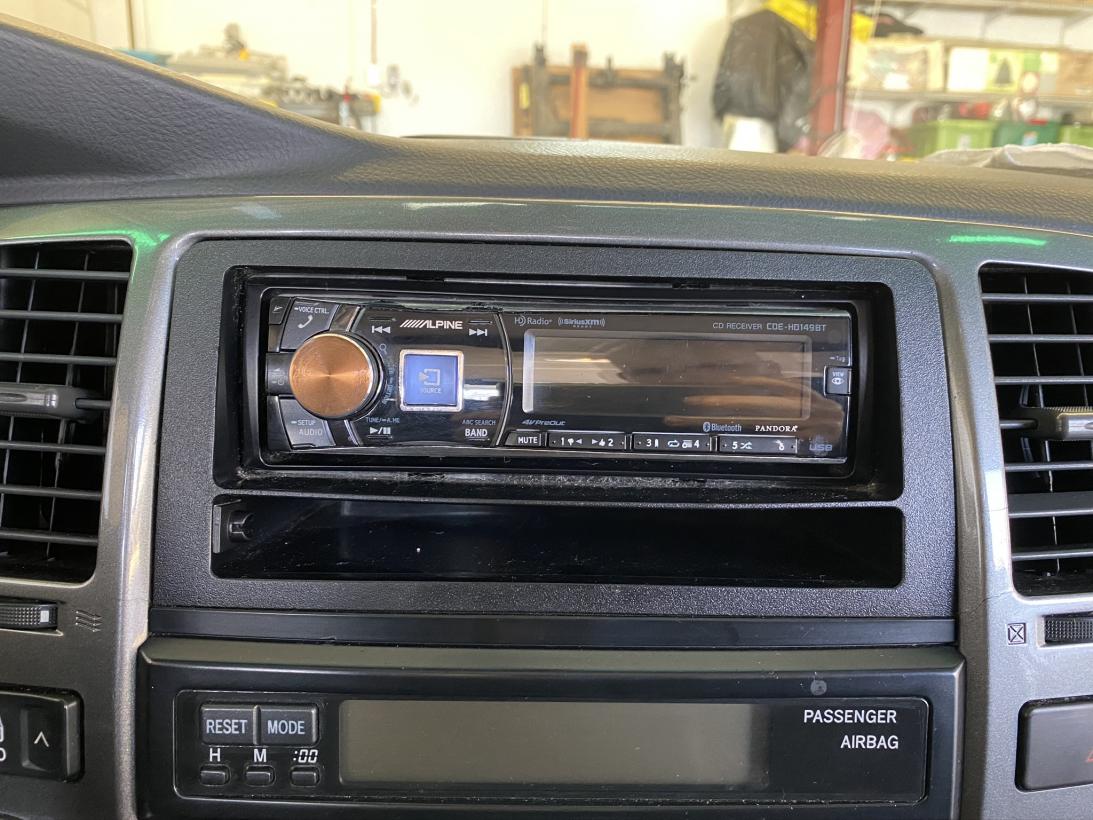

Started removing the crusty half functional Alpine head unit, as soon as I removed it from it’s home I found what would take me the rest of the day to fix.

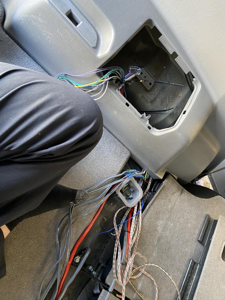

First I saw three sets of RCAs, and a particularly cut harness.

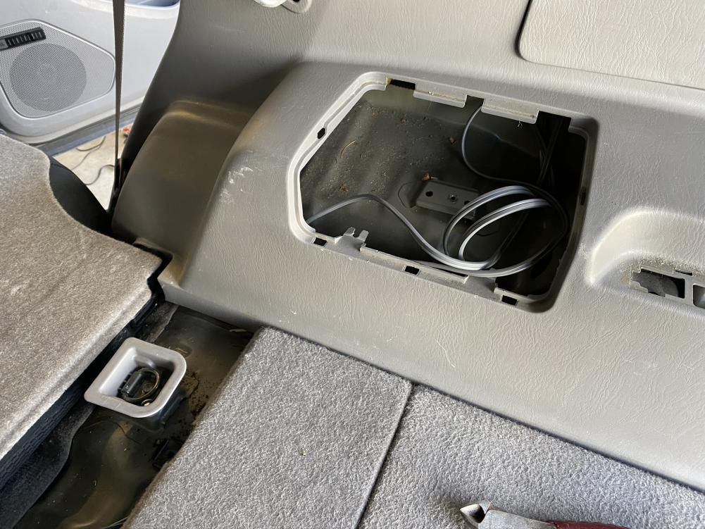

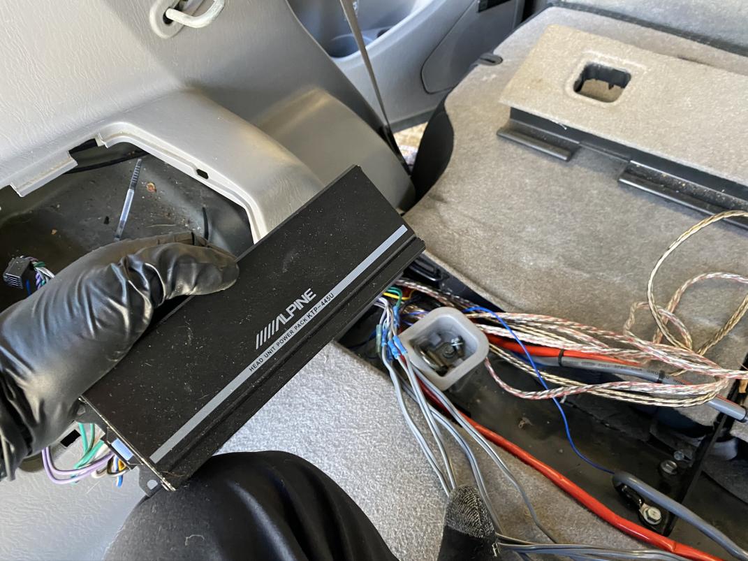

After unplugging the Alpine head unit, I knew I wanted to get all the aftermarket wiring out of there before I installed the new Sony head unit. That’s where things got interesting. I went through the glovebox and found a pamphlet and instruction manual for a Apline KTP-445U (Head Unit Power Pack). I presume this is what was used to have the factory amplifier power a subwoofer. I spent the rest of the day undoing what was done here.

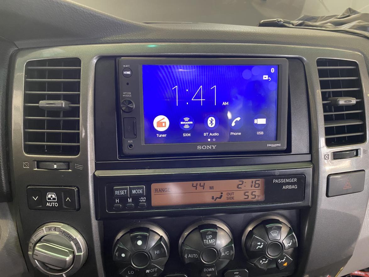

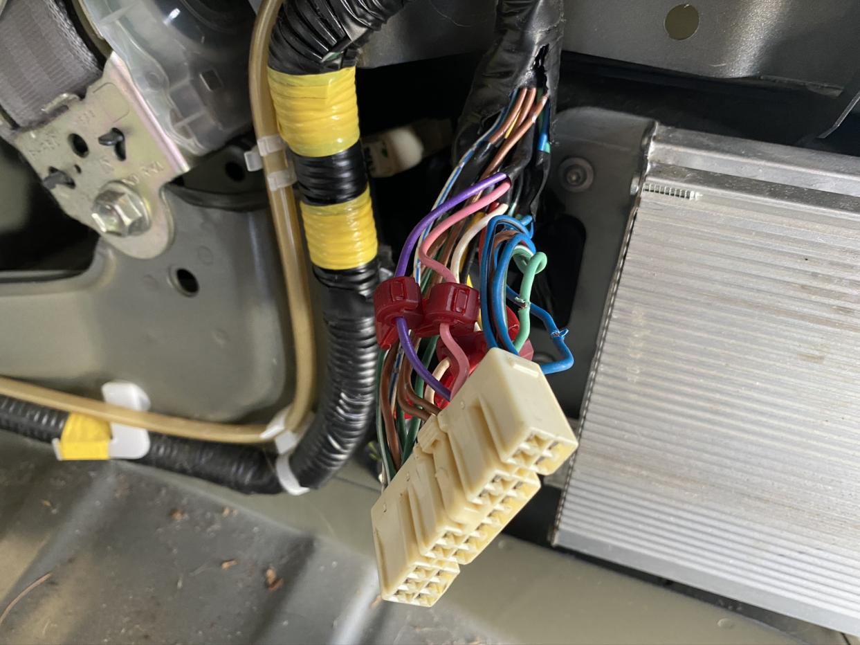

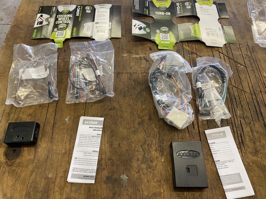

Once I got everything opened up I was able to see what needed to be fixed. I pulled all the previous extra wiring and fixed at the wire taps at the amplifier. The harness wasn’t plugged into the amplifier. During the removal of all this I found a Alpine KTP-445U (Head Unit Power Pack). I assume this is what was used for the external amp and sub. I was on the look out for this thing because I found the pamphlet and install instructions in the glove box. Then I set off putting together the harness for the new Sony head unit. I used the Axxess TYTO-01 and ASWC-1. The steering wheel controls didn’t work with the previous head unit. The dash kit I used was the Metra 95-8210. Turned out looking pretty good I think. And now I have the peace of mind knowing I cleaned it up and restored what I didn’t like.

First, the Axxess TYTO-01 has a potentiometer for audio level adjustment. This adjustment is almost useless. Directions say to turn the radio volume to 3/4 and adjust the potentiometer to get the desired loudness. When I did this, the audio was awful. Way too much power going to the speakers. So I adjust the potentiometer, and the audio had this pulsing effect as if someone was turning the volume up and down slightly.
Second, the sturdiness of the Metra kit is okay once it is in the dash but applying the dash kit, you have to be careful not to over do the screws holding the dash kit to the head unit. Also, if you’re not thinking ahead, you can really get the depth of the face all wrong. Thankfully I thought about this before I put the entire dash back together. It came out pretty good I think.

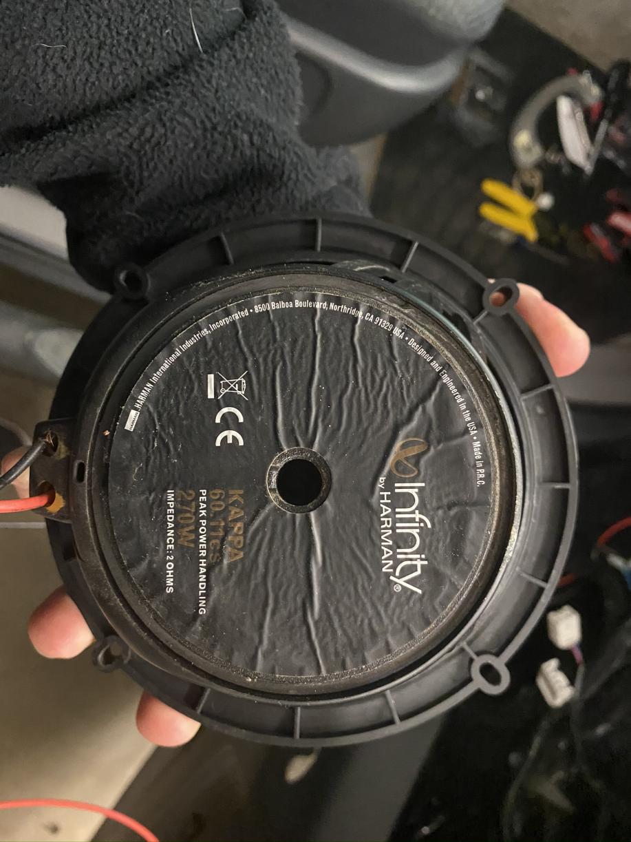

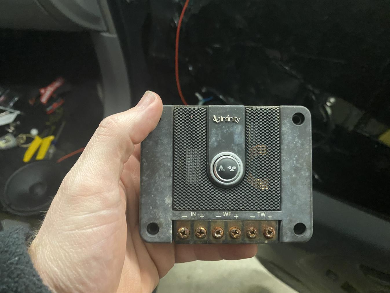

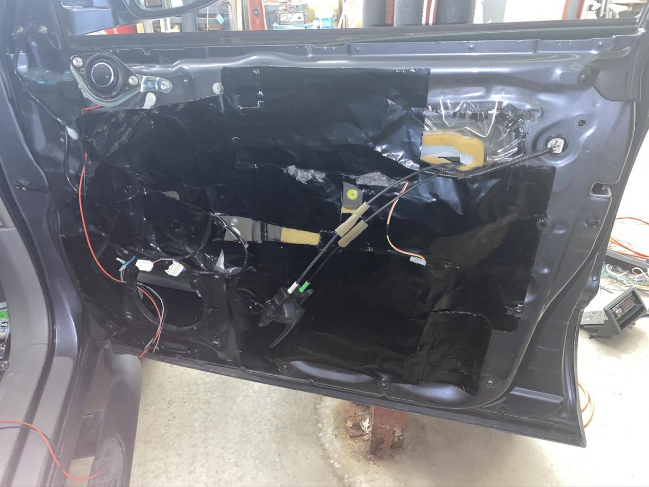

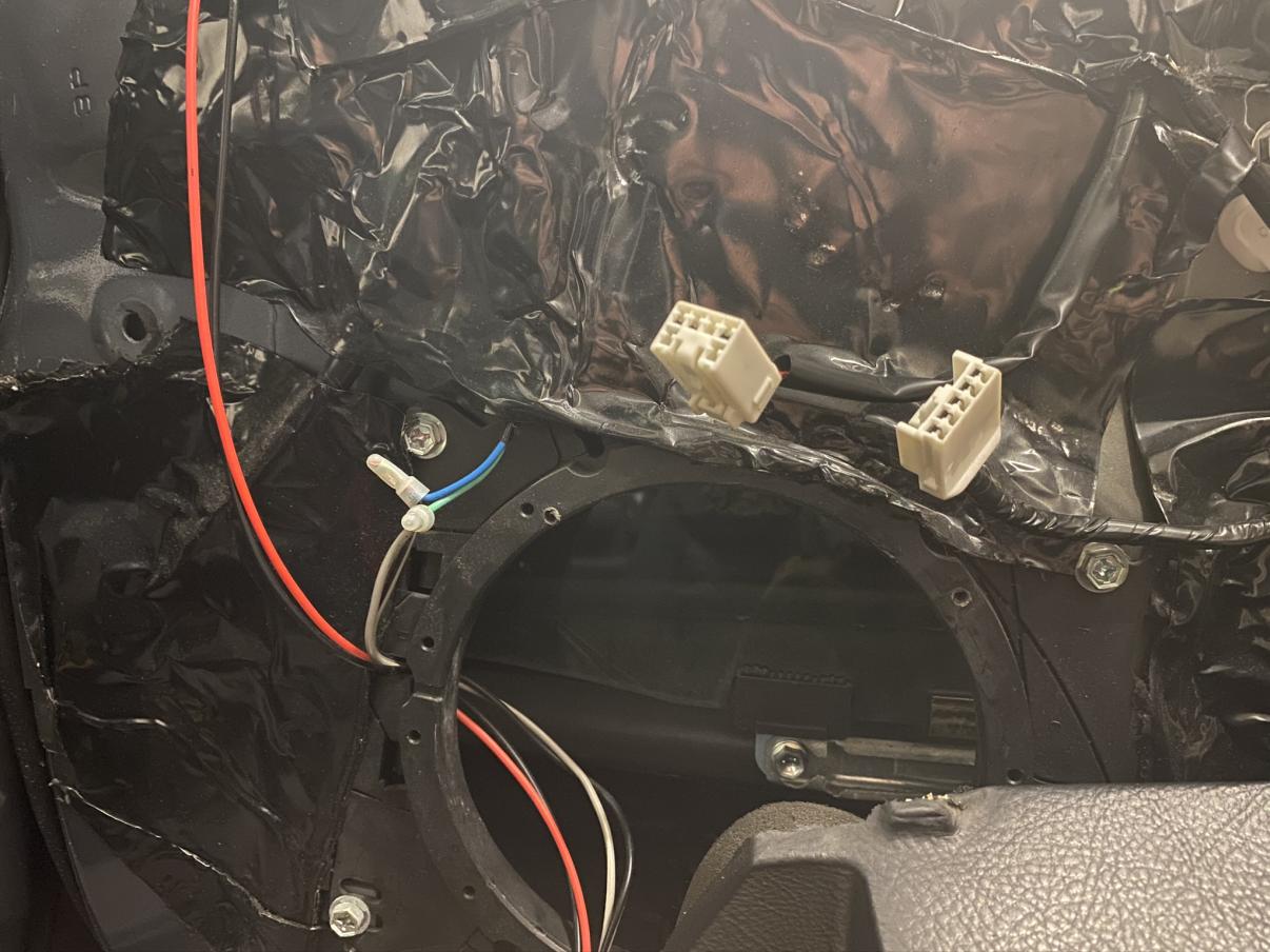

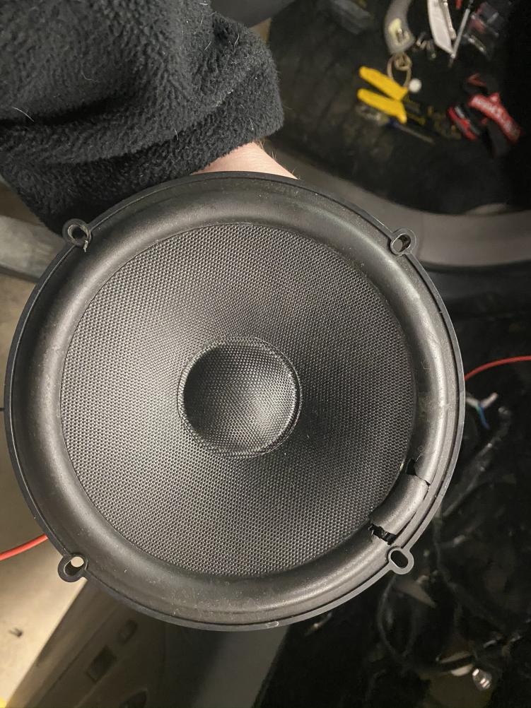

Lastly, back to the audio quality. I was curious why the speakers sounded so bad, I was planning on changing the front door speakers for now. Once I got the door panel off, I realized why it sounded so bad. The previous owner either paid someone to install a crossover and component speaker set of did it them self half ass. I the lower door speaker wasn’t even hooked up and the crossover was held on with hook and loop in the recess of the door. The factory speaker harness had been cut (typical for crossover and component install), and sound deadening had been lathered on behind the door panel. So now, I have to wire the speakers direct until I can’t find the OEM male and female side of the speaker harness and I’ll have to really put in some elbow work to remove the sound deadening so I can reapplying how I would like it (between the inner and outer skin of the door)

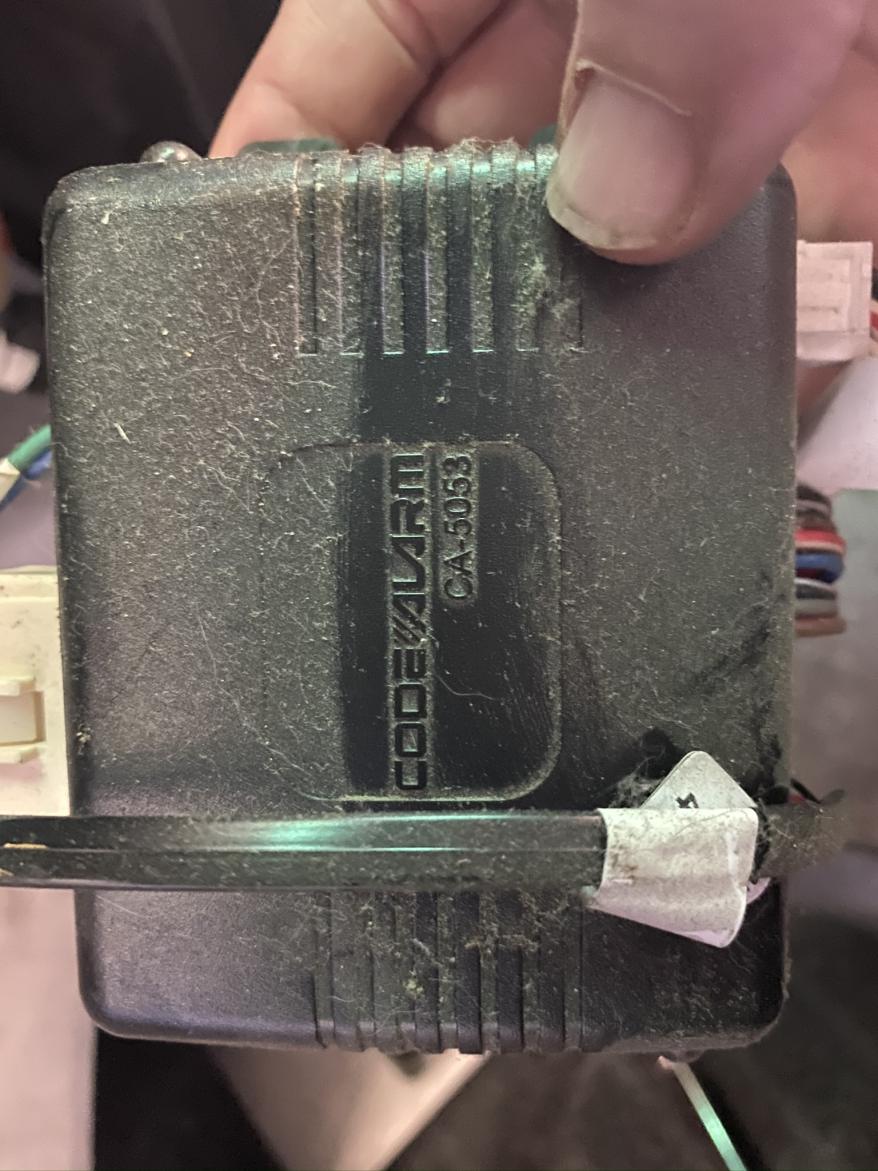

I almost forgot, one good thing I did find while I was in there was a Code Alarm CA5053 and FlashLogic FLCAN ADS. I did not receive a remote for it but I found the correct remote online and waiting to see if the system still works and if I also inherited a remote start with this vehicle. :-)

Yes, I will do the sound deadening on the doors, the materials are on order already.

1. The front speakers are 6x9 ovals, the only crossover is a bipolar capacitor in line with one of the tweeter leads. You can upgrade to a better 6x9 or use an adapter to fit a 6.5" round speaker. The front speakers are not 2 way because of the separate tweeter however you can disable the tweeter and use a 2 way 6x9, one or the other.
2. Rear speakers are 6.5" round and there is no tweeter. The rears are kind of hard to hear because of the seat arrangement.
3. I would recommend keeping the speaker impedance the same for front and rear. The instructions that came with your head unit should tell you what resistance the speakers should be.
4. All speakers have plugs but they may be hard to adapt to aftermarket speakers.
