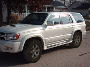

Not sure if these are the wheels you are talking about, but they are 17" 4th gen wheels with the larger flares.
that would have been a 265/75/17 tire on there in that picture. These wheels tucked under more than stock or the FJ wheels I have now do. (To the point that the tire would rub frame on full lock). I would think a 1" spacer would bring you back to stock or a .5" out from stock. I've never been a fan of spacers which is one reason why I sold those wheels and bought the FJ's. (now i'm considering spacers or new wheels again).
I may have better shots of the truck with those wheels that will give you a better idea of what you are looking at with no spacer.

and for reference that was with the 99 "tall" springs only for a lift.
