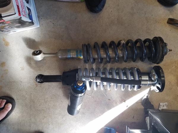

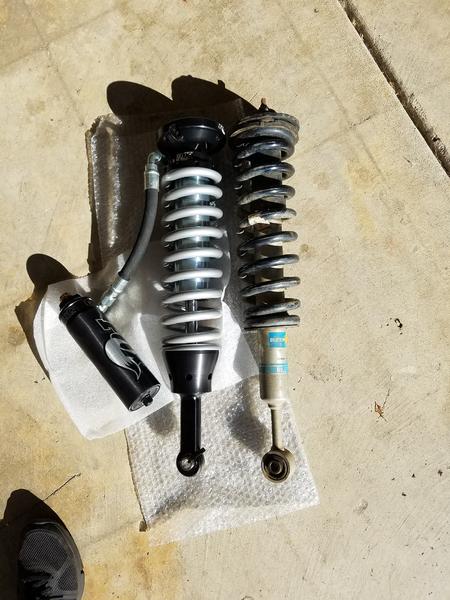

I recently replaced my Bilstein 5100 and OME springs with Some Fox 2.5 extended travel coilovers with DSC adjuster. I had them set for 2.5 inches of lift to match the ride height of my old setup but there was so much preload that I couldn't even drive it. I've attached a picture of both shocks next to each other and you can see how compressed the spring is on the Fox and how the Bilstein assembly is still longer then the extended length Fox. Something has to be wrong right? I had to drop the collar back to 1/2" of exposed thread for it to drive right but I lost almost 2" of ride height. Extremely frustrated and disappointed in these Fox coilovers. The 1st picture is the way the shock came out of the box and the second one is after they were adjusted for more lift.
Bilsteins are longer than all the extended length shocks. That's why it's a very bad idea to put a spacer above them. You could put a spacer above the fox though.
Sent from the drivers seat of my 05 4runner.
