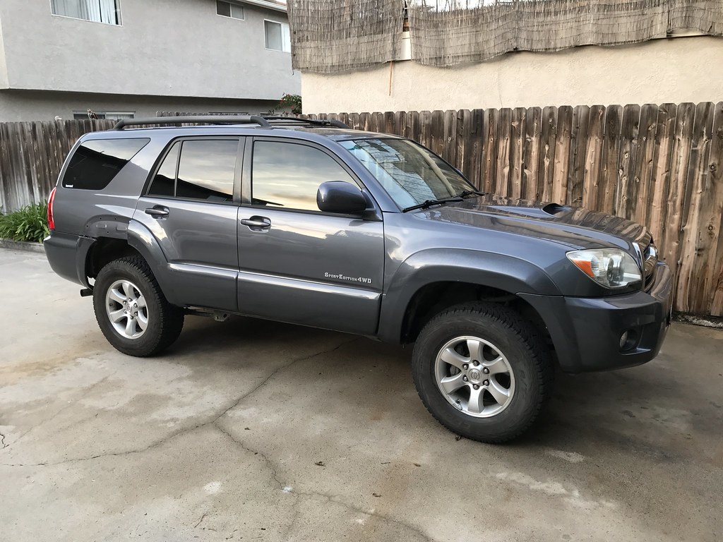

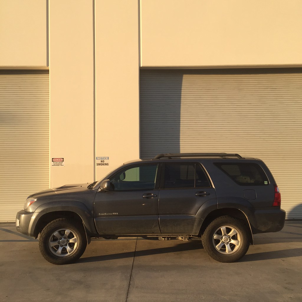

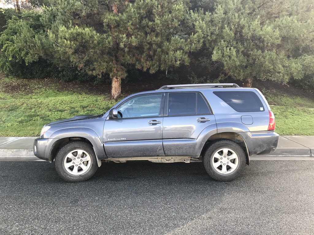

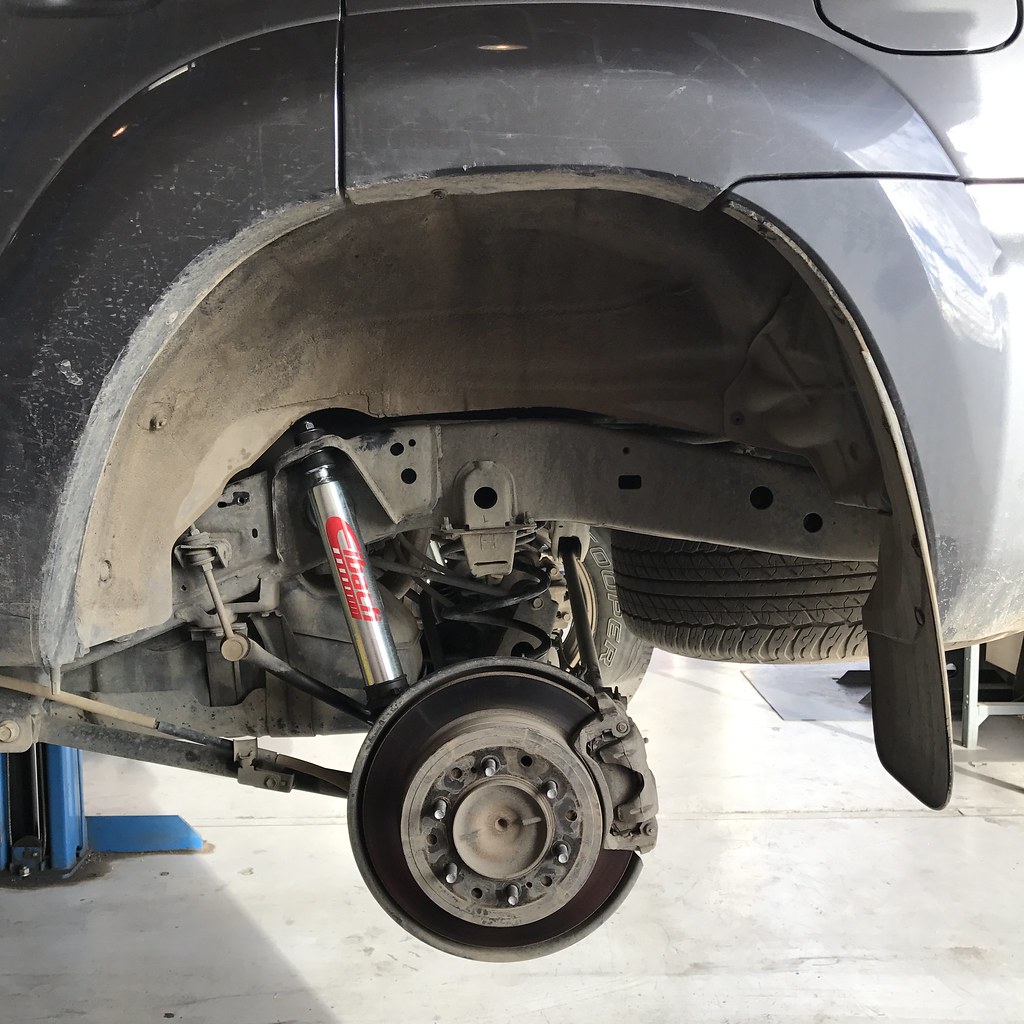

I had Eibach shocks installed this weekend... Pro Truck Sports in the rear and Pro Truck Sport Leveling in the front. Eibach is developing springs for 4th gens and I know a guy, so I got hooked up with everything for testing. I'll be driving around with the new shocks + stock springs for ~6 weeks, then I'll be getting the new springs. So far I love it. I was worried I was going to miss my XREAS, but two of the shocks were leaking anyway so it wasn't riding how it should have in the first place. Got 2½" lift in the front and it soaks everything up so nice. I have a couple big sweeping freeway interchanges on my commute, and it handles those just as well as the XREAS did.
before (stock)
after:
removed the mud flaps and gave her a much-needed wash:

Eibach is developing springs for 4th gens and I know a guy, so I got hooked up with everything for testing. I'll be driving around with the new shocks + stock springs for ~6 weeks, then I'll be getting the new springs. [/IMG]
a new coil offering from eibach that yields less lift then the rear T12s but said it was a ways off. I for one would love to have another option with less than 1.5"s of lift. Do you have any more info?
Not yet. I will ask when I am back in a few weeks. For what it's worth, they are only replacing my front coils.
