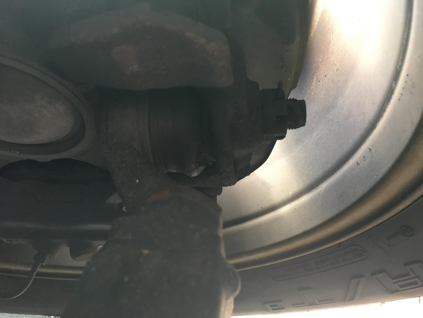

Lower Control Arm angle after Toytec 3" lift
I noticed my front lower control arm angle changed after my lift. The joint looks like it's pushed out towards the wheel and no longer flat like it use to be before the lift. Does anyone know if this is normal or what can be done to fix this??
Uhm, you lifted the truck. Hence, you changed the angles of the suspension components.
Sent from the drivers seat of my 05 4runner.
I'm not questioning that. I'm just asking if everyone else has the same angle on their LCA's and if it's a concern. I don't mind replacing a part if needed to correct the issue.
Ohhhh gotcha! I was interpreting that as why is this angle different? Lol. It looks about normal. How much lift did you put on?
3" Bilstein/Toytec.

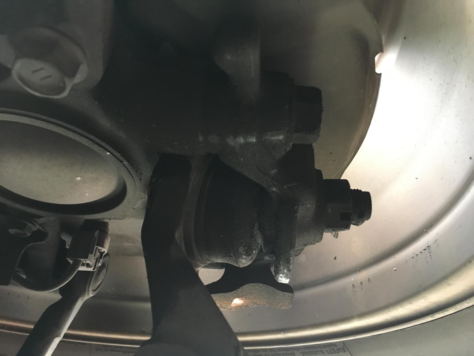

Here's a pic before the lift.
