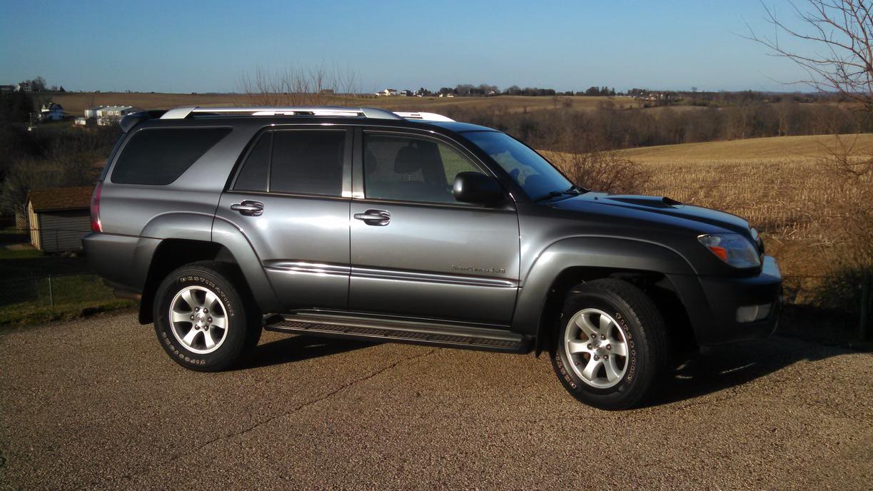

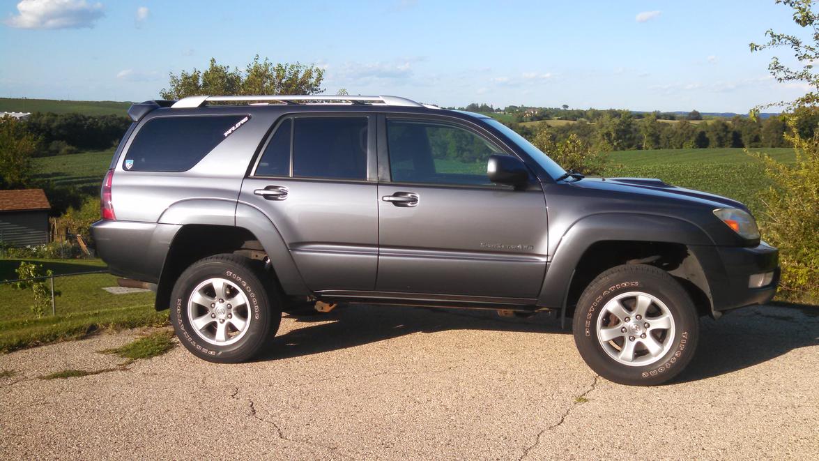

Gained about 3.5" of lift in the front and 2.5" in the back with this kit. Rides stiffer than XREAS, which was expected, but I really like it. Feels very sure-footed. The truck still has some rake with front adjustables set at stock height (first notch), which I am OK with. 0.85" setting would probably level it with no rear spacers. Still averaging over 20 MPG too. Tires will be next. For anyone considering a moderately-priced upgrade, this is a nice set up!

I installed this exact same setup about a month ago and really enjoy the improved ride and appearance. Did you also install the drivers side 1/4" spacer to prevent lean?

My setup uses Eibach Springs sold by Wheeler's out of Oregon (T1 coils for the front and T12 springs in back). My truck still has some rake and my crude measurements indicate that a 0.85 setting would come pretty close to leveling it front to back. I believe it will settle some though and I have no idea what that will be until I drive it for awhile. I honestly don't mind the rake I have now (which is much less than it was with stock XREAS) and probably won't move the snap ring off the lowest setting. I think running it there puts the least amount of stress on the shocks, although the Bilsteins have been proven to be very reliable even at the highest setting of 2.5".
As for a driver's side spacer, I did not install that because to me, it doesn't matter. I know some owner's want the truck perfectly level and have added this. Some have used FJ springs, which use a different one for the driver's side that is slightly taller, I believe. They are marked to distinguish the difference.
Bottom line is that these are great trucks and each owner has many options to make their vehicle unique. Best vehicle I have ever owned!
