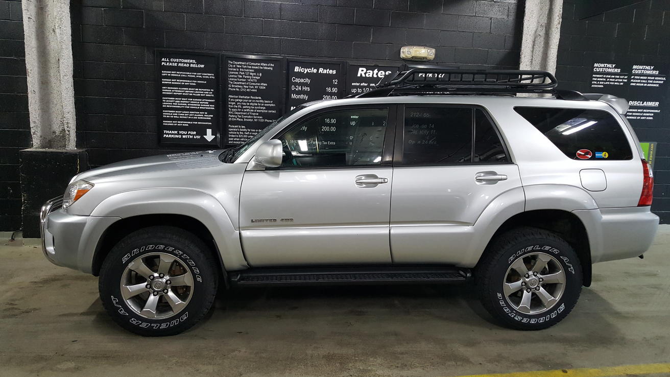

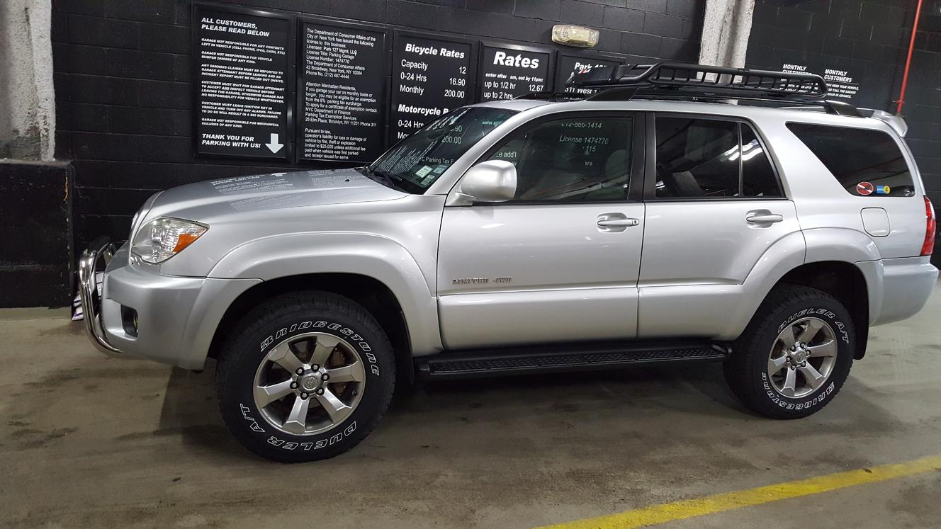

Watson, I have the exact setup you talk about, 5100s with T1/T12 coils. Side picture below of mine gives you an idea of the lift, I'd say it's closer to 2.5" on front and 1.5" on rear. I'm running a V8 limited.
I am running lift from the coils only, the 5100 shocks are on their lowest perch. Rides great on the highway and is less floaty over bumps. Haven't done anything super rough yet but has handled the odd dirt road very well.
On tires, I'm on 265/65/R18 which is one above standard. This runs with no rubbing and no trimming required. It's close at full lock on the front, but there is loads of room at the rear. This equates to 265/70/17 so with this lift you should be ok. Note I'm running Bridgestone Duelers, Maybe KOs would be slightly larger with the thread? Something to consider. However I'd recommend this setup depending on how much Highway driving and what kind of off roading you want to do. So safe to assume at least 2" front and 1.5" rear for your tire calc with this setup.
Any questions on it, let me know. I had the guy fitting my suspension put together the shocks/coils.
