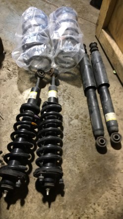

Hey everyone, I need some help with my new rig. I just bought a 2005 4runner limited v6 and the suspension needs to be replaced. I bought a stock suspension from a 2011 FJ cruiser with ~20k miles on it. I've heard that the springs are a direct fit but some modification needs to be done to the struts in order to fit. Does anyone know what modifications need to be done in order to run this setup on my runner??
Also, I want to put pair this with the daystar 2.5/1.5 kit but don't know which set to purchase (FJ or 4runner daystar kit)??
Here is a picture of what i bought for reference. Any input is greatly appreciated as I'd like to get the ball rolling asap. Thanks!

$100 seems high to get the coils installed on the shock, I think I paid a guy $60. Just call around to some small shops and haggle. It is worth it and will save you a bunch of time when doing the install.

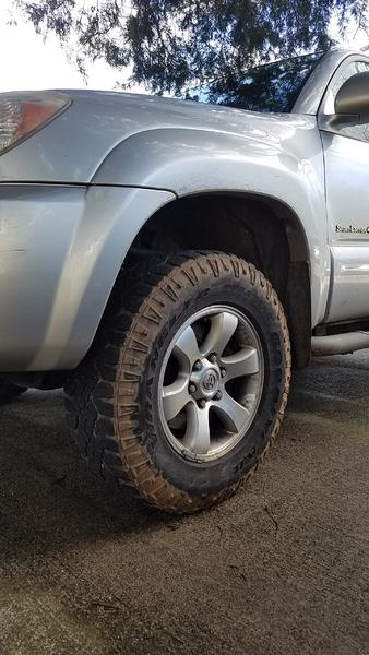

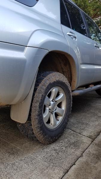

thanks for the pics and they look good. Seems like more wheel well than I am looking for....you have the bilsteins on 0 setting and no other lift components? I wasn't expecting it to be that much higher than the wheels (rear specifically). Maybe a side view will offer a different perspective, but do it at your leisure :-)
Bilsteins are at 0, no other lift components. Might just be the angle of the pic, when I get a chance for a side shot from eye level ill post it. Still considering installing spidertrax kit, might throw em on tonight for comparison.
