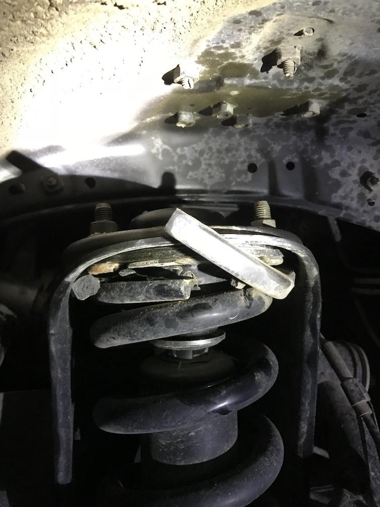

Forgot to reinstall Front "Lean" spacer.
Hey Everyone.
Sooo.. I just replaced the top mounts for my "strut" assembly. Rubber Gaskets were blown out after 5 years. Took photo prior to show the blown out gasket/rubber bushing.
As it got late I slapped everything together and now I realize I forgot to put the 1/4" spacer on the drivers side.
What's the consensus on how soon I should take it apart and get it back in there?
Sad thing is, I borrowed all the equipment to DYI the repair to save $$.
Thanks in advance for any advice.
Chris
Also. GOBI Stealth Rack arrived this weekend. That install should be soon.
Thanks for the suggestion, I will make sure to order both those items! And this is just for the driver side right?
Correct. The trim packer goes on in the rear drivers side (top of the coil isolator which sits on top of the spring), then the 1/4” spacer goes between the strut mount and the coil isolator of the strut on the front driver side
