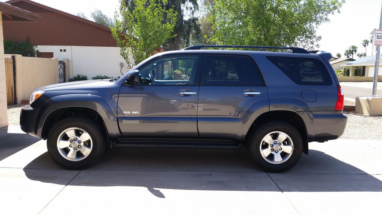

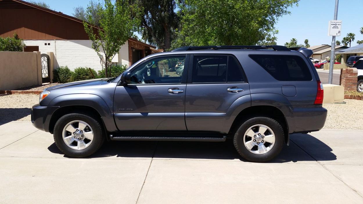

I had hoped to not have to re-invent the wheel but I didn't get the answers I needed, so I rolled the dice...I bought 4 Bilstein 5100's, set the fronts to +1.75" lift, no spacers on the rear. It lifted the front 2" and leveled the truck perfectly. I have a V8 so the same setup on a V6 may result in rearward rake.
The truck looks great, I love the ride, and it no longer rubs or bottoms out on a primitive road I frequent. I hope this info helps someone else.

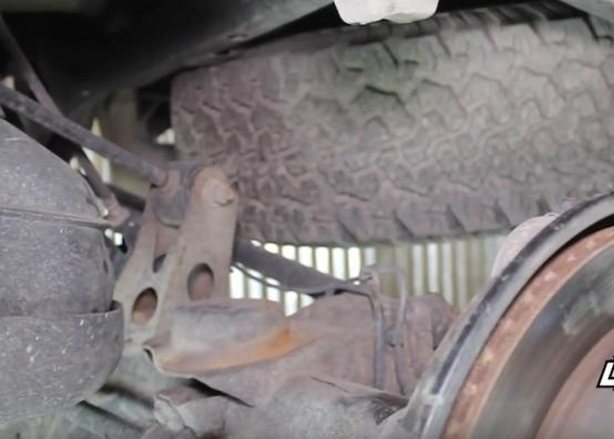

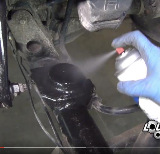

Sorry if this is the wrong place to ask, but I can't ask it in new thread, I am trying to figure out rear coil orientation of 4th gen 4runners, to use them on my GX.
Does the 4runner rear coil bottom pig tail face forward and outward towards brakes?, I checked few youtube videos, one seems to face inwards (https://youtu.be/-tDYnzKtE2c?t=20m47s) and the other seems to face outwards (https://youtu.be/oxV-CAAfrgg?t=2m12s).
Thanks.
Thanks.
I don't think it would matter, and you are looking at the right side and the left side of the axle in those pictures so maybe that is why they are different. It would make sense the coil buckets aren't symmetrical but that they are identical. Any coils for the 4Runner will fit the GX anyway.
