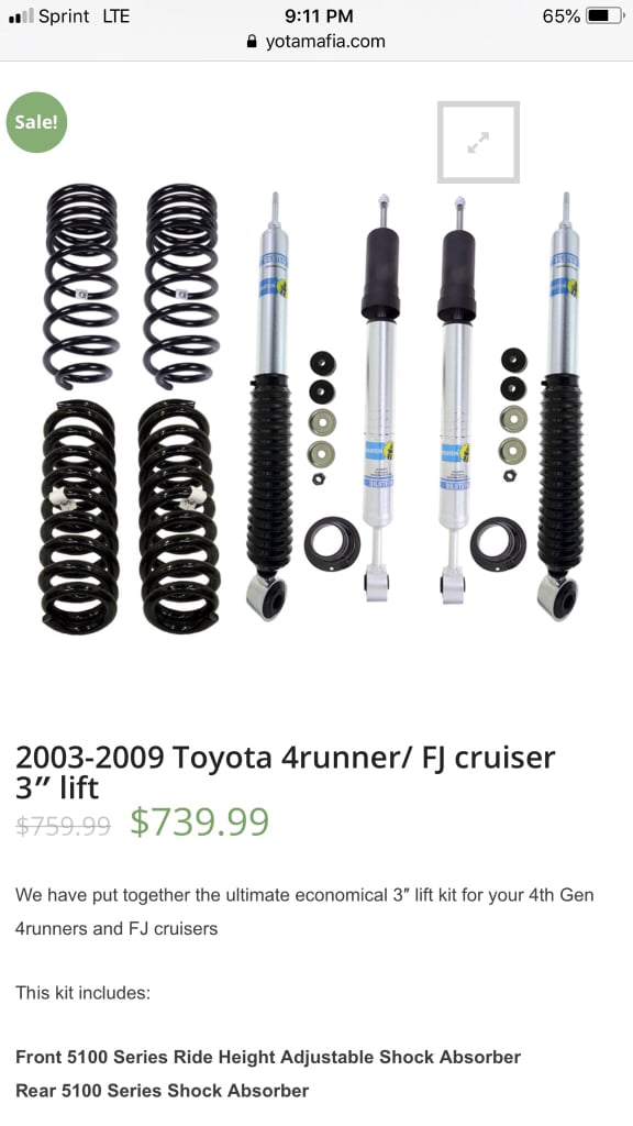

Hello everyone,
Need some input, 05 V8 Limited 4x4 w/ XREAS
I just ordered the bilstein 5100/OME coil package that Yotamafia has on their site.
I can take out the XREAS with no problem, my questions are as follows:
I have seen on this site that there is talks that the 4Runner w/ XREAS needs a different top hat? Is this the case? I was going to order the KYB tophat but didn’t know if there was a different part/part# since mine has XREAS now.
I ordered the 886 coils and 895 for the rear. I have arb front bumper on order which is why I went with the 886 for the front. Do I need to purchase UCA’s right away?
Do I need to purchase extended brake lines? I know stoptech has metal lines but wasn’t sure if that’s what I needed.
Thanks in advance,
Sean

The KYB top hats are what you need. They need to be installed correctly for passenger and drivers side, so watch that.
UCA's with a 3 inch lift is not necessary but highly recommended. Some have been able to get it into spec. others have not. I personally bought the JBA uppers and I am glad I did, much easier to do them with everything out. If you live in the rust belt you might want to replace the bolt and washers too while you are at it.
Keep an eye on your CV boots too, the increased angle will cause some to leak. Both my inner boots leaked until I replaced the clamps.
Brake lines, I didn't find that I needed the extended ones, there was enough line to not stretch.
Watch out for the ABS lines however they are fragile.
Good to know thank you for the input, I will look at UCA’s I was hoping I could avoid them at the beginning and order after. So I will see how it plays out.
