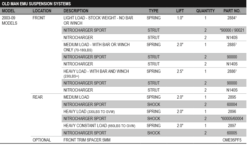

Hey guys,
Long time no post... life got in the way of vehicle modifications :-)
I'm still running my 2007 SR5 4x4 V8. Shrockworks front bumper, Warn winch. Completely stock otherwise. Running the front bumper for the past 5 years has killed my front suspension, hitting the bump stops with bumps at highway speeds. Time for an upgrade!
Looking at the following for a mild lift and smooth out my ride. This is still my daily driver, so need to keep highway behavior into account. Are these choices reasonable? What other items do I need to consider when doing the installation, and subsequent lift (in other words, what else should I anticipate breaking?)
Old Man Emu Nitrocharger Sport Shock Set 2003-2010 Toyota 4Runner
$573.91
https://www.amazon.com/Old-Man-Emu-Nitrocharger-2003-2010/dp/B01F6I0B7M
Old Man Emu 2886 Coil Spring
$167.20
https://www.amazon.com/Old-Man-Emu-2886-Spring/dp/B00CJ1VWK0
ARB 2896 Old Man Emu Coil Spring
$167.20
https://www.amazon.com/ARB-2896-Old-Coil-Spring/dp/B004P9JQFW

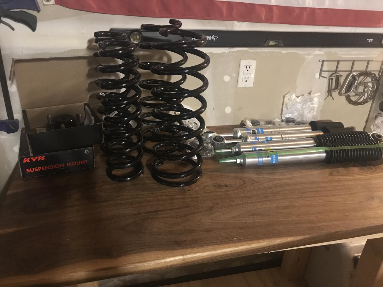

Help please
I am ordering my suspension and I have read the forum for days but unsure on my combo.
Bilstein 5100 Series Shock Kit for Toyota 4Runner 4WD 2003-09 - Includes Front Ride Height Adjustable Shocks # 24-239370 & Rear Shocks # 33-187174 ***Excludes adjustable (X-REAS) suspension***
Moog 81088 Coil Spring Set (4runner spring)
Moog 81045 Coil Spring Set (4runner spring)
KYB SM5640 - Mount Kit
Spidertrax S2PWHS007 Wheel Spacer Kit (1.5 inch)
I have read that a lift under 3 inches does not require new control arms. I am looking to get max height without control arms or alignment issues.
I would like 2.5 inches of lift with no rake.
Can this suspension provide that?
If yes what setting do I set the front shocks?
If no what combo would work?
Thank you for the help
Update. I have ordered all of these. I will return what I don't use. Can some one recommend the best setup with these parts to get 2.5 inches of lift with no rake.
Daystar 1.5" Rear Lift Kit
Moog 81081 Coil Spring Set (FJ spring)
Moog 81108 Coil Spring Set (FJ spring)

I have a similar setup to what you're getting. You can check my build thread if you want.
YMMV with the <3" lift not needing new control arms. Some don't mind running closer to 0 caster. Others do. And it also is heavily dependent on how good your alignment tech is.
Yes, the suspension setup will provide close to 2.5"inches of lift with some rake.
In the rear, you'll get close to 2" of lift.(which will effectively max out the bilstein's as their made for 0-2" lift).
In the front, you technically don't want to change the preload since the FJC moogs have a higher spring rate, but I've done exactly that. I have mine set at the 2nd from the top perch, @ 1.75". I believe it gave me closer to ~2.5" of lift after it has settled down.
