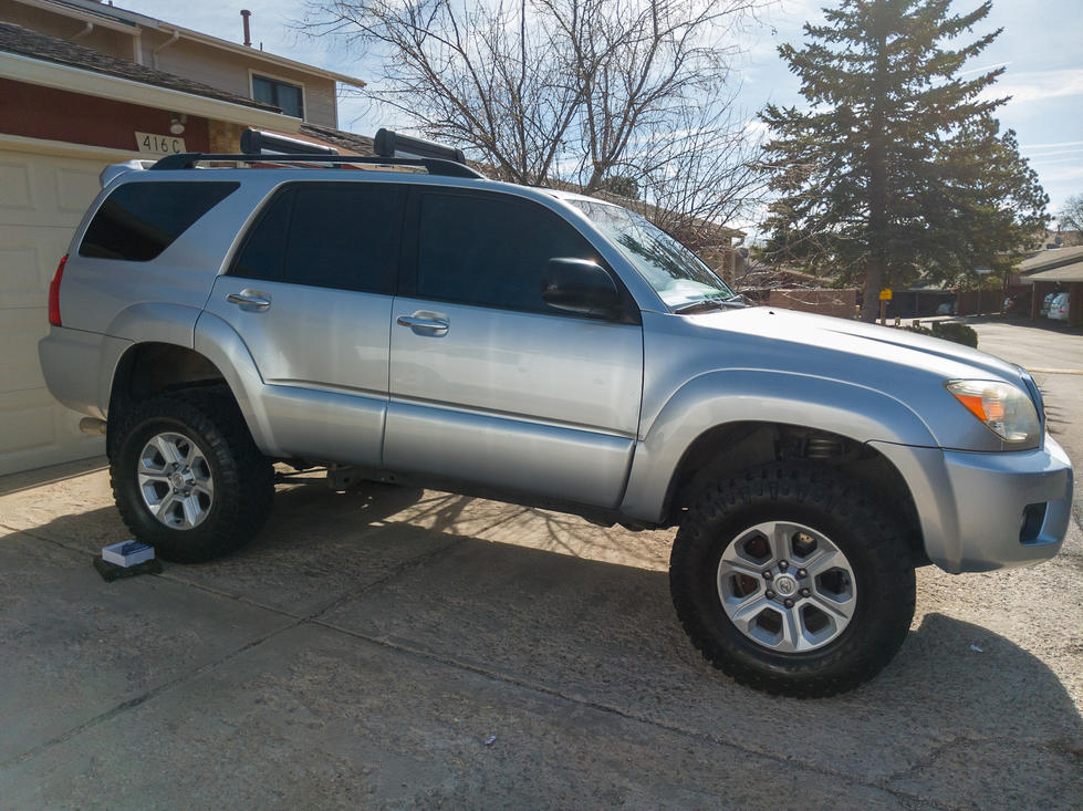

Hello all, first post here. Just picked up an '07 SR5 with some mods already. It looks like it's Toytec 112620 springs and 5100s in the front. I can see three grooves just above the bottom spring perch, so they must be on 0, right? The rear is Toytec RCC2.0 and 5100. It also has a 1" body lift. So, this should be 2.5" F, 2" R, and 1" BL as I understand.
It rides pretty good, but does wander around just slightly. I'm planning to add some JBA UCAs to make sure I can get things lined out properly. I'd like to boost the front a little more though to level it out. As I measured the front is 2.5"-2.75" lower, LF - 37.5, RF - 38.25, LR - 40.25, RR - 40.75.
What is the best way to add 1-1.5" to the front while I'm adding the UCAs? I don't want to redo everything and spend a bunch, hoping to just add a little to what I've got, or swap for some taller springs. Thanks!
Either a 1/2" or 3/4" top plate spacer should net you 1-1.5". Honestly, if you're fine with it, I'd go with the 3/4" spacer, because that way you don't need to replace your top hat studs.
I just bought these to put up front, but I think I changed my mind and I'm not going to use it. I loaded up my rear with my drawer setup and it came down a bit. Now 1.5" might be too much.
I bought a 3/8" and 1/4" top plate spacer right now to put in on the L/R side, respectively. This should fix the driver's lean, and it'll be less rake.
These springs will be good, no need for a top spacer. You can add a 1/2 spacer if you install a bumper in the future to get back the loss from weight sag. These have the same spring rate just one extra coil for more lift.
