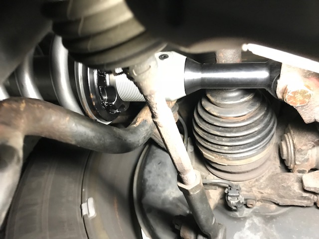

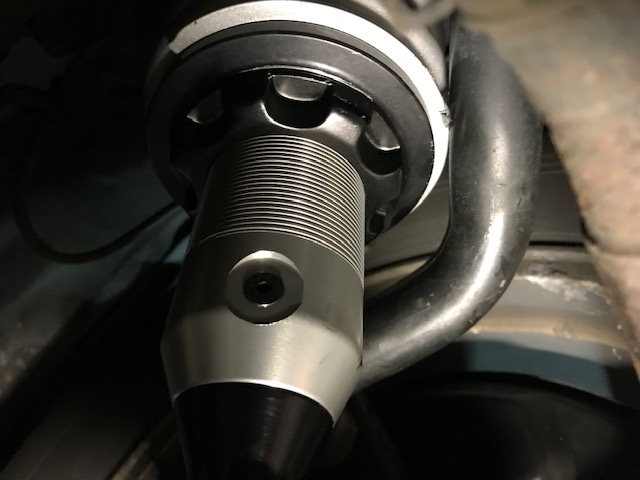

Sway bar rub
Anyone have issues with the swaybar contacting the coil spring after installing Fox 2.0s? I've seen sway bar relocating brackets for some of the higher lifts, but never saw anyone needing it for just a level...
I just finished installing these on the front, and while checking things out after setting the front back on the ground I noticed the swaybar hitting the spring on both sides.
Maybe it's just how I had the sway bar set up when I put in new bushings, and it'll settle out of the way after I drive around a bit? Am I ok for a quick drive around the block to see, or could I really mess up a shock?
How much higher than stock are you? Don't guess, measure the distance from center of hub to the bottom of the fender.
