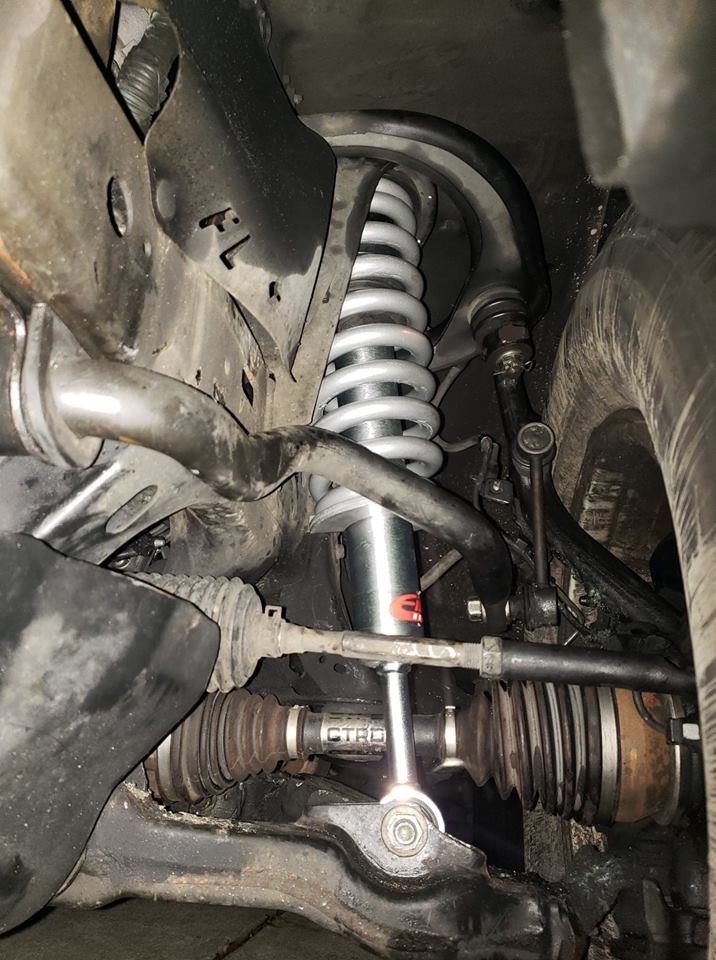

Eibach lift kit
I just recently installed this kit. Definitely an improvement over stock. The ride quality in my opinion is excellent and the the factory rake is gone. I chose this kit because it was on sale vs toytec 3" lift
Following the instructions. I installed them at the first notch recommend by Eibach to maintain stock cv angles, which it does nicely, still gives me leveled and lift.
