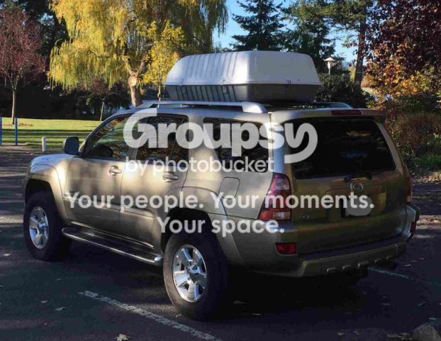

Hello,
This is a great forum thanks to the mods and contributors for your invaluable contributions on this site.
I’m changing out shocks and springs and will be disconnecting the Xreas
system on my 4th Gen 2004 Limited doing the work myself. My budget is about $1200.00 CDN = approx. $900.00 US
I’m currently on new Duelers 265/70/17 AT, with a Daystar 2.5/1.5, and Spidertrax 1.25, I’d like to keep the height and zero rake of this lift and level combination.
I’m wondering if any of the 4th Gen folk who have lifted their rigs know if this set up described below (Billstein/Moog) will keep the profile described above as it is?
My new Duelers and the Spidertrax will be part of the new configuration.
Shock Absorber
Bilstein 5100 Bilstein Front and Back
Coils/Springs
Moog 81081 Rear
Moog 81108 Front
Also does the Bilstein and Moog combo described above require a spacer to maintain my current lift and level?
Thanks in advance for your feedback.
What are you trying to get from the lift? Just appearance? Want to actually offroad?
This is fine for just appearance. If you want to offroad a lot, go a full shock/spring setup all around. It's way better than a spacer setup. But if you're not trying to reinvent the wheel, this will do.
