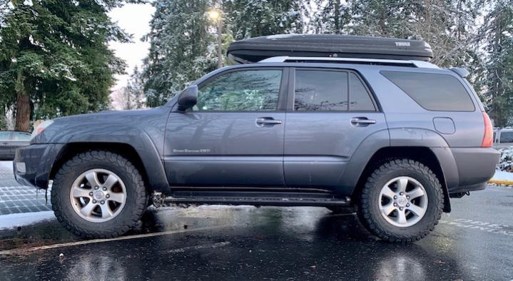

Which of these lift options?
Please share your Opinions and Experience with these lifts Options:
Option 1:
Bilstein 6112, w/ 5160 on rear, Medium springs,
w/ SPC Upper control arms.
Option 2:
Old Man Emu 2.5" Suspension
2885
90021
2895
60004
OME95PF5 w/ Nitro Upper control arms.
Compare and contrast for my decision.
Questions welcome.
Objective is to have an all around versatile suspension.
Which do you favor?
Thanks.
