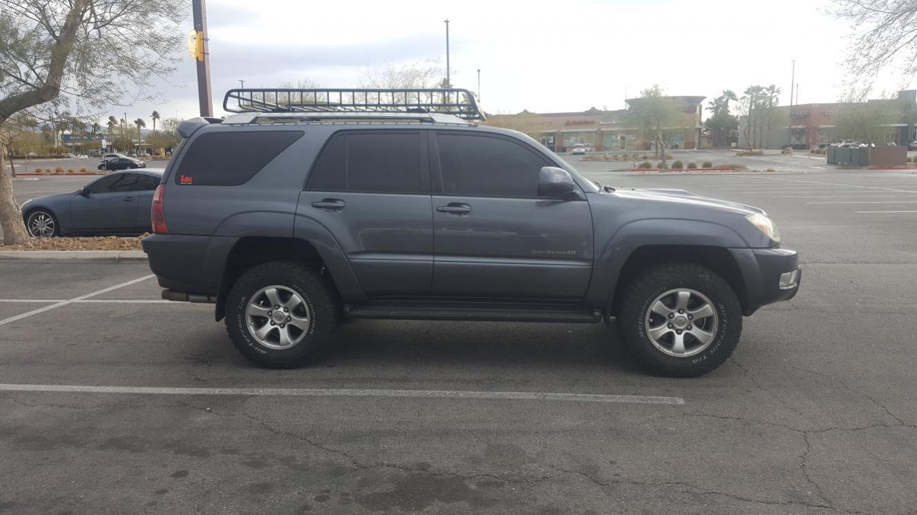

4th Gen Suspension Options/FAQ
OME 283 and OME 295e. Bilstein 5100
Caster on RIGHT: 3.4
Caster on Left: 3.0
My LCA control are seized on LEFT.
Replaced the LCA on RIGHT side. Original caster was 1.9 on RIGHT.
You dont need UCA for mild lift.
Hopes to helps someone looking for a baby-lift and bilstein 5100 (bottom notch)
3 months of settling.
2.00" in REAR
1.40" On driver side
1.55" on passenger side.
V8
Caster on Left: 3.0
2.00" in REAR
V8
looks great
