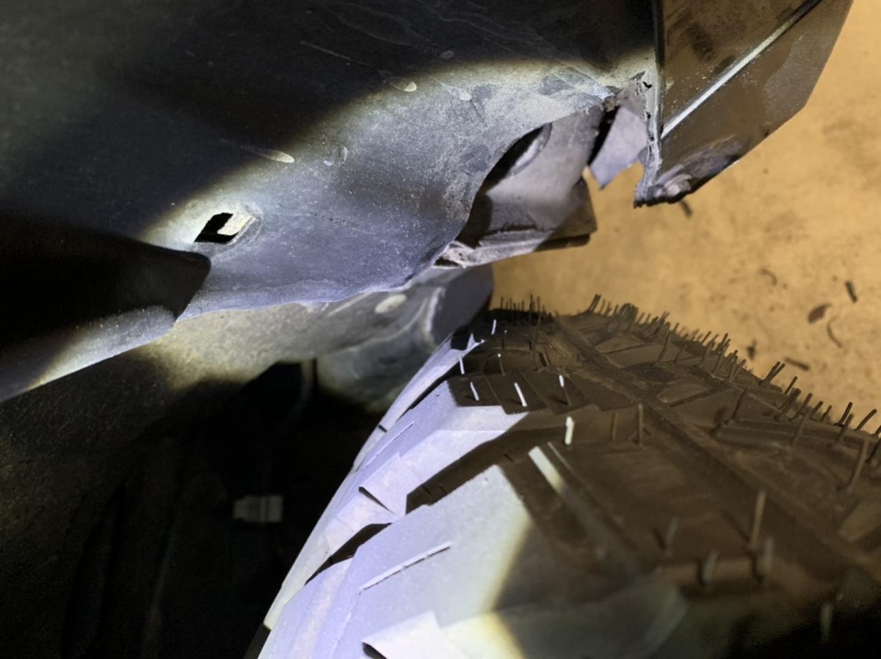

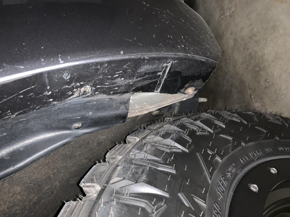

I did the BMC and trimmed as much inner fender as I can, but now I rub on this pinch seam. What’s going to happen if I grind this off?

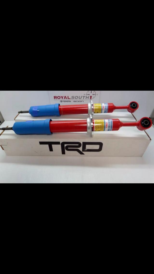

4Runner springs + FJ Bilstein
Would the springs on a 2003 4Runner fit on a pair of front Bilstein TRD red shocks?
Dude, you are asking the same basic question over and over. It's been answered a few time already. Yes they will fit. But it's recommended that you get new springs instead of using the old, stock ones.
