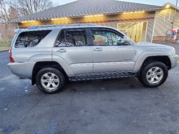

Been a bit crazy. Not the best pics but i just took it to the carwash for the first time and decided to take a look. I think my eyes were deceiving me before but right now looks like the driver side is lower then the passenger.
I'm gonna measure it when the weather is better and I can leave my kids inside alone for more then 2 min without bloodshed...

Is it normal for the passenger rear to sit a little higher than the driver side after a lift? It's about 1/2" higher.
I think I read a post in one of the stickied threads that the springs on the driver side are a little higher, to account for the weight of the gas tank + driver? So if you replaced your springs and used the same size for driver & passenger, that may be your problem.
I definitely don't know though, you'll want to confirm that with someone more experienced than myself!
I didn't measure the aftermarket ones. I did however just measure the factory springs and they both measure the same.
I checked it out last night. The rear springs weren't centered in the seat all the way on both sides. Took the weight off the axles and was able to scoot them over.
Sitting a little better. RR-37.75", LR- 37.5", RF-36.5", LF- 36.25".
I checked my stock car and its very similar. Driver side is 1/4" lower compared to the other side Front and Rear. The fronts settled a lot. They were sitting close to 37" on Saturday.

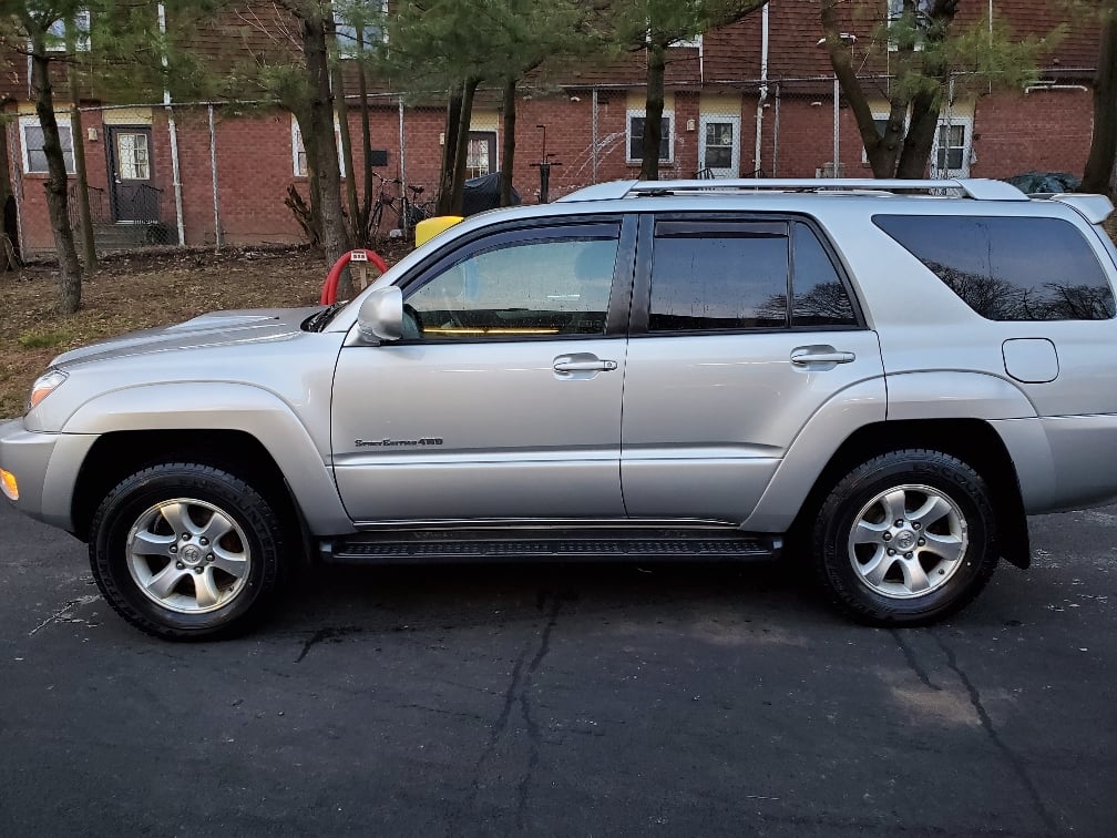

Thanks for the input - any chance you might have any photos that you could share of your truck with the lift? The Eibach kits seems to be popular with the 5th gen guys, it's been hard to find 4th gens with the kit.
I'll try and snap a picture tomorrow and I'll post it. I don't have any before lift photos for comparison, didn't even think of it!

I went with Bilstein 6112 setup. Lifted the rear 1.5" with the B12 springs, front 2.5". I could had gone another notch and gained another 1/4-1/2" in front. It drives phenomenal on the street so far. Very planted, but doesn't feel like a 1 ton truck. Actually pretty surprised how compliant it is. Coupled with the 265/70-17 K02s it drives nicely. I am debating on doing the same setup on my other 4runner or going with the 5100s to save some money. I think the added weight of the V8 in mine would benefit from the 6112s though. The last time I lifted a vehicle was my Jeep XJ and I Went the cheap route with a cheap lift. Rode like crap and never enjoyed it. I put a spacer on my Wrangler last year and it now drives like crap due to the extra pre-load. I plan to pull the spacers out and put a better spring/shock on. You get what you pay for with lifts. With a daily driver you want to enjoy driving it on the road.
Looks great and thanks for the picture and tire size info, very helpful. Just to confirm the Bilstein/6112 setup is the Bilstein 5100s w/ Toytec springs, correct? Did you need to install UCA and a diff drop?
