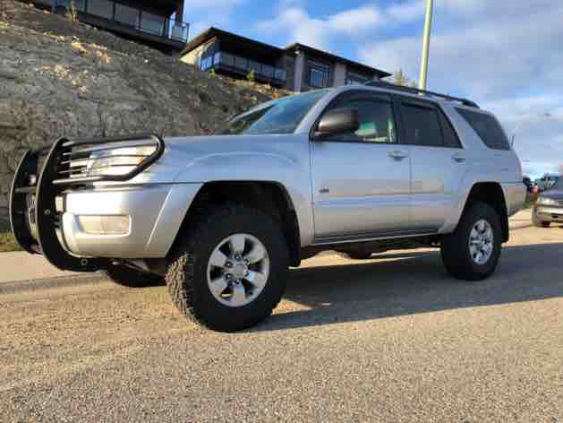

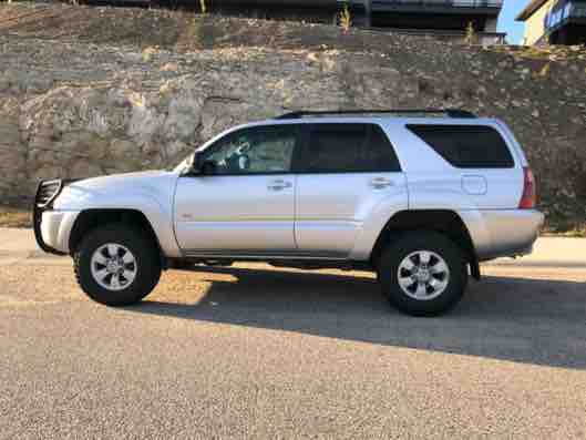

Here's the pictures of the Eibach Pro Stage 1 Kit. I gained 2.5 inches up front and 1 inch in the rear. There is about 1 inch rake which is perfect. I also used a 10mm OME trim packer on the rear for drivers side lean. So far that side is still .5 inches higher because I've only had it on a couple of weeks. I'm thinking it will even out at some point when it fully settles.

Thanks for the pictures! A 1" rake sounds about perfect. I think my currently stock suspension has about a 2.5" rake so there is def room for improvement. What size tires are you running?
275/70/16, 31" BFG K02, D Rating 8 Ply. With this lift you should probably be able fit a 17" wheel with a 32" tire max. This was as large as I could go without getting new wheels.
Thanks - I was looking at either 265/70/17 or 255/75/17... both right around that 32" mark. Just to confirm, you didn't need to install UCAs or a diff drop since the lift was under that 3" mark, correct?
That's correct, no need for UCAs or a diff drop. This lift was designed to work with all the factory components.
