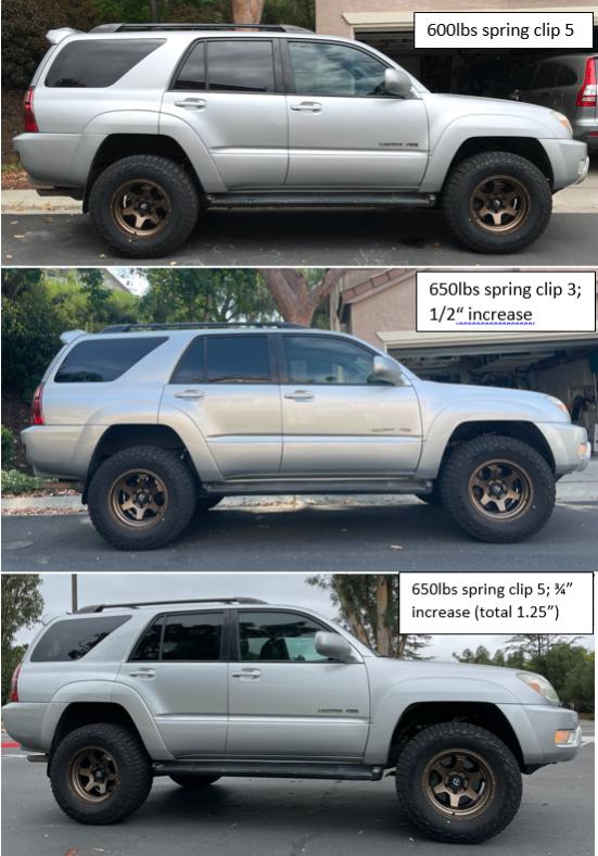

I can't guarantee anything but if you have V6 the max will be 3" per Bilstein spec sheet with 6112 with 600lbs springs. I had to swap my springs to 650lbs to attain 3". Hope that helps you. I added photo of mine with springs changed.

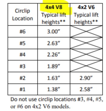

Hi and nice ride and nice height with OMEs. I don't know if you are trying to lower height or same height as photo. I think you might need to use clip 5 minimum for about 2.5" lift per Bilstein Manual. If you have lowest clip setting it will only raise 1.38". Manual says V8 but I think it is similar to V6 depending if you have 600lbs or 650lbs coil spring.
