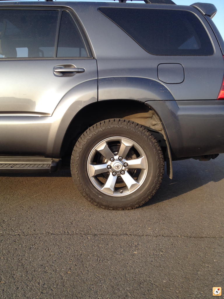

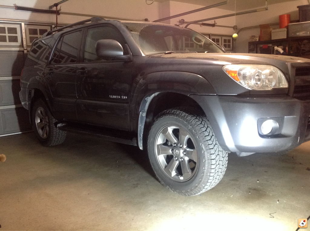

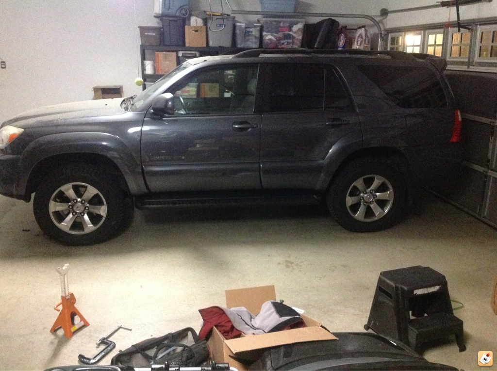

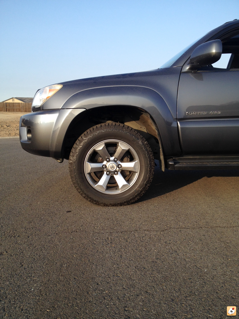

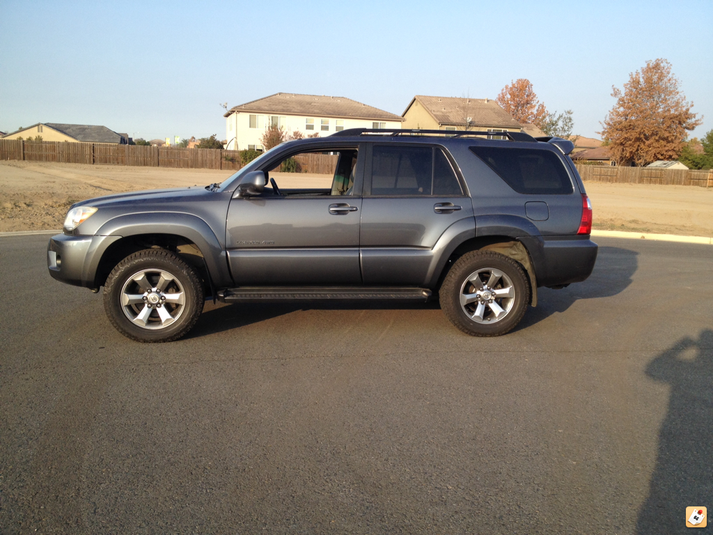

I was getting a ton of rub on my front wheel wells whenever I cranked the wheel hard or backed out of the driveway. In addition to the rub I was showing increased wear on the inside edge of both front tires. I have 127k on this 2006 Limited V8 AWD Stock 18" rims with Hankook DynaPro ATM 265/60's on em. It seemed like a good time to go through and upgrade my suspension.
I went with Bilstein 5100's all the way around. I set the billies at 1.75" and continued to use my original springs. After the install I am getting a higher nose than rear (at least by appearances) and this is with less than a quarter of a tank of gas in it. My passenger side has more clearance in the front as well. Will this difference in height settle out for my passenger side? Also, what is the expected drop I should see after the suspension settles. This high nose "appearance" is enhanced due to my running boards sweeping upwards. From back 12.5" from ground to bottom of running board to 13.5" in the front.
I had a hell of a time getting these puppies into their places in the lower control arm. Will I see increased wear at all of my joints and CV axle? If so, am I better off dropping down to the 0.85" setting?
Wheel Well Measurements. (Measurements to fender from center of Hub.)
Drivers side: 35" Passenger 35 5/16-3/8". Rears are both at 35 5/8".

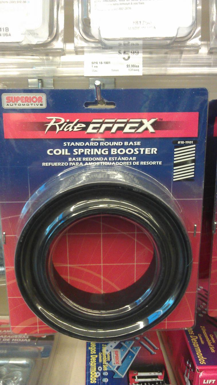

Will the Superior RideEffex part# 18-1901 work to correct the driver lean?
I don't think it will, you'd need to measure the diameter of the rear coils to see. I don't have a set to measure.
