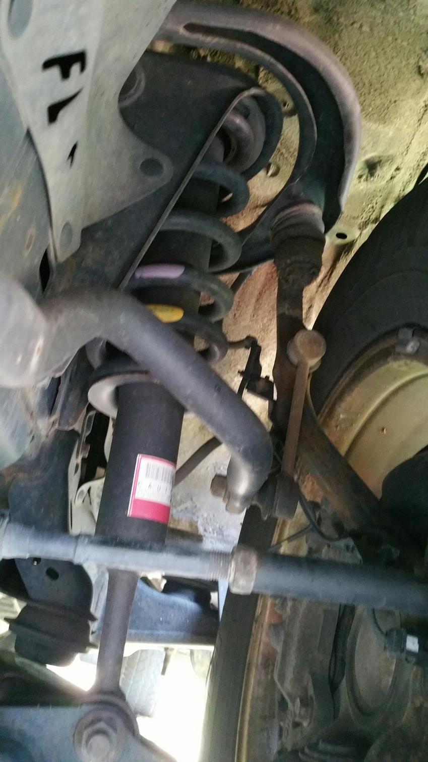

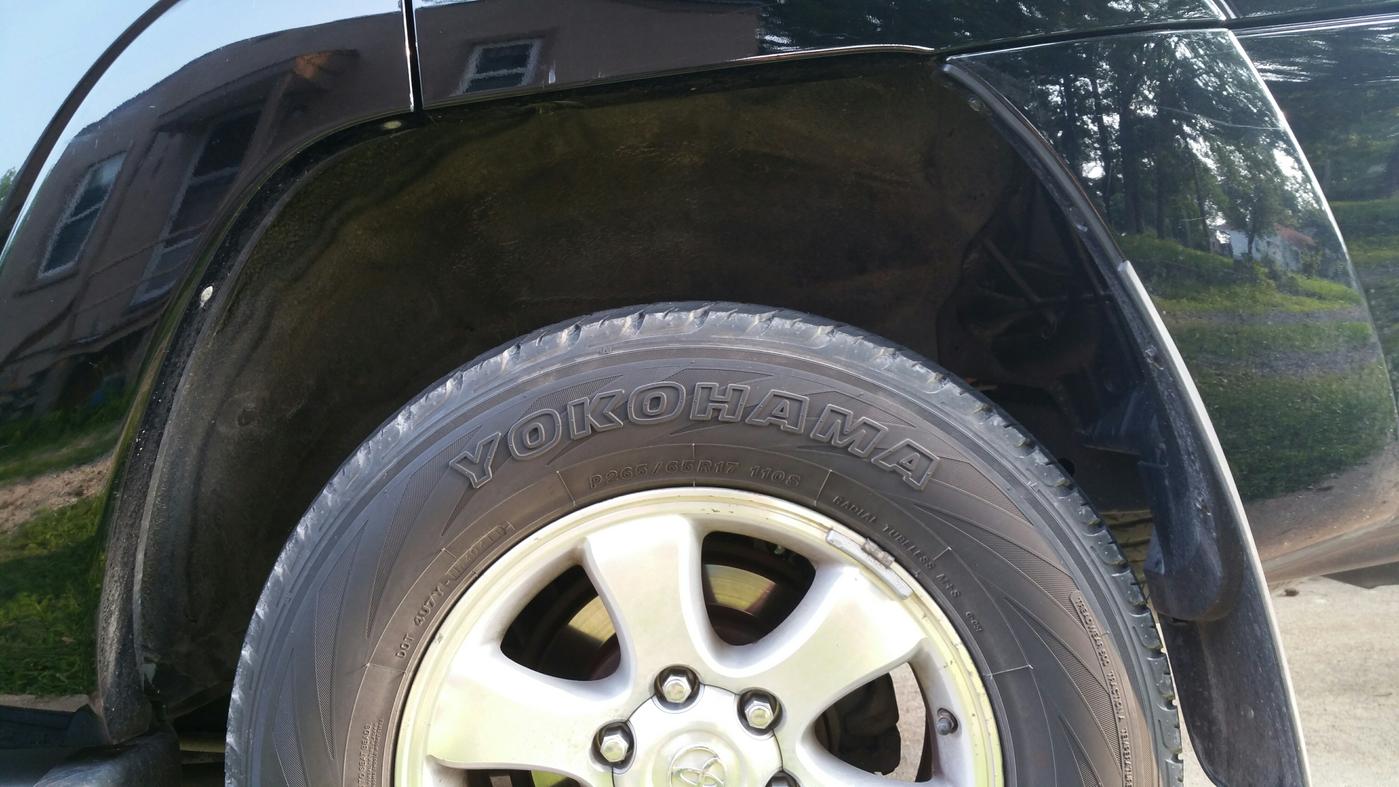

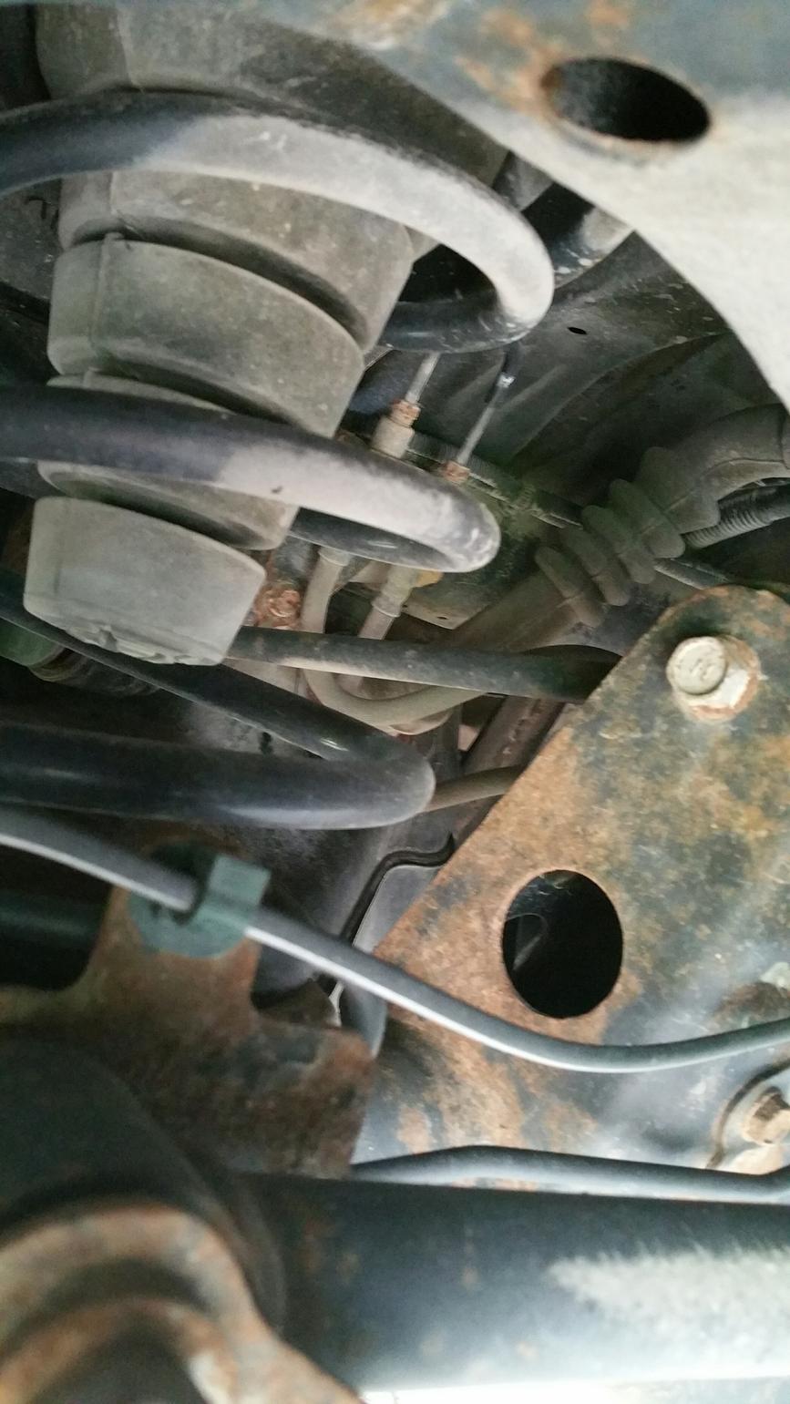

Hello everyone! My name is Rex. I'm currently living in the St. Louis Metro area. I have recently purchased a 4th Gen T4R. I got a 17ft aluminum boat recently and the 2012 Civic Si wasn't quite cutting it for towing.
I'll be posting a Noob Message on the general thread as I have a few CEL and other questions not related to this thread.
The 4Runner currently has 265/70/17r tires on 17 (stock alloys?).
I will preface the following with this: I have now spent one full week reading, learning, doing my own research and got to my proverbial brick wall and just wanted to reach out to the community. I have a bit of extra money and want to turn this (somewhat) older diamond in the rough into a good DD that has an edge to it. I love toyota's and 4runner's in general. This is my second!
I have read and come to the conclusion that i definitely want to do a suspension upgrade and lift. As I only have the 2wd I'm thinking a set with the bilstin 5100's would be ideal as I will be DD and towing and the adjust ability is a great feature. I am most interested in the Toytec lifts from what I have seen. The full $1200 setup seems less desireable than this C/O front with new springs and 5100's all around.
3" Lift W/ Bilstein 5100 Height Adj Coilovers FJ/4Runner
I have found one guy/girl on there that has this setup and it looks great and is quite affordable without the diff drop (865 give or take) on the toytec website. Anyone else have this and like it?
2 questions.
1. I'm wanting to run 275 or 285 / 70 / 17R's on http://www.toyota-4runner.org/4th-g...unner-fj-7-spoke-17in-wheels.html#post1716563
the TRD Pro 2014-15 4R wheels. Would the lift provided by the toytec I'm looking at give enough clearance for the 285's?
If not, would i just need to get spacers to provide a bit more clearance on top (is that possible with the C/o linked above?). I'm in need of assistance with the spacer route-as that is completely foreign to me. (i've provided pictures of what it is looking like today).
2. I'm interested in the BFG k02's or the GY Duratacs...or even micky's if anyone has suggestions there..I'm open. There is a place doing b3g1 free and i could get the terra grappler g2. Just give me your opinion on tire size and brand.
Thanks again and I hope to learn from the forum and eventually contribute!
Oh last question--someone mentioned yotatech lift discounts through the forum. I looked and all i saw was a direct link to the same Yotatech site google takes me to when i looked under the vendors thread.

Got my billy 5100s, my 885 front, and Superflex rear. Anything else I should pick up before doing the lift while everything is apart? Runner has 90k miles on it now. Brake system looks good. Swaybar bushings? Extended front/rear swaybar links? I want to have as many ducks in a row before I start tearing things apart. No point in doing it twice.
