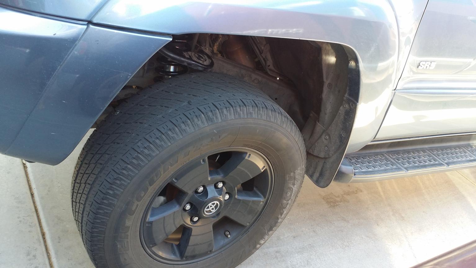

Wow...this is tall...
So I had my build done on Saturday....Bilstein 5100s all around & front set at .85, OME 884s on front, Toytec 2.0 on rear. I have some wore out 265/65/17s now but trying to decide what size tire to go with. I have a 2005 SR5 V6 2WD. This lift has seriously lifted my vehicle....it's 16" from bottom of sidestep to the ground. I was thinking about just going taller with a Toyo A/T 265/70/17 then I won't have any rubbing....looking for some opinions please....please don't judge my dirty beast...

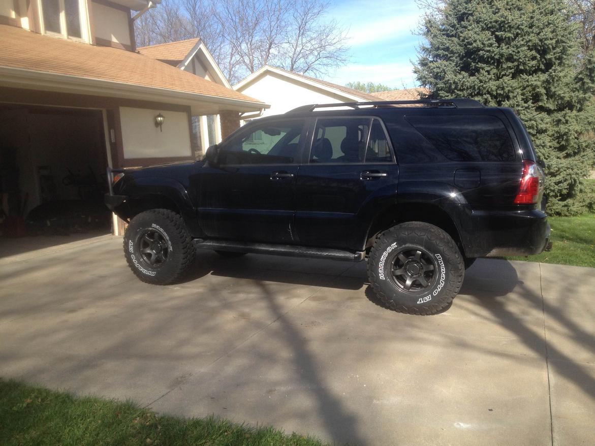

I recently installed the Heavy OME 896 to the rear of mine and Im running 285/75r16's. I went from a 17 to a 16 because the tires were cheaper and I really liked the konigs from FN wheels. I got mine from toytech. They dont actually advertise the OME as 3" of lift in the back, they say its more like 2-2.5" in the back and 3 inchs up front if you go with 886's anything lower than that and I believe you need the .5' spacer. And like an idiot, I was so excited to install mine I forgot to take before and after measurements so Im not sure how much I actually recieved. I will say it was noticeable when I was done. I was worried when I bought it that it might sit higher up front but it actually leveled out pretty nicely. As far as Dif drop is concerned it goes both ways. Ive seen some pretty heated arguments about that one, but most of the things I saw was that it was more of a 3rd gen thing, not really required on the 4th as it doesnt really drop the diff it just rotates the front of the transfer case forward about a 1/4 of an inch and that your skid plate wont fit right afterwards. I didnt do it on mine
So, should I modify the Bilstein 5100 front setup and Bilstein HD 4600 rear set up (each pair with approx 30K soft miles), or should I go with the setup of new Fox that my buddy is recommending. Also, what skid plate senario would recommend as well as a lower profile bull guard that can handle a winch and lights? Or, is it just as cost and look efficient to put in a grill / bumper guard?
