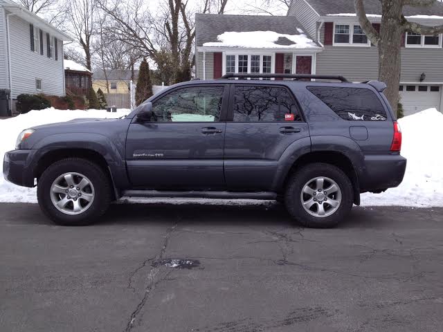

Put Bilstein 5100's all around at the .85 setting about a week ago. Love the look and the ride.........
