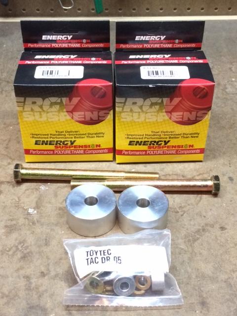

I installed an OME/Toytec 3" lift a little over 1 month ago. I didn't replace sway bar bushings, add a diff drop, or install sway bar relocates.
I'm thinking replacing F and R sway bar bushings, adding the diff drop, and possibly installing a sway bar relocate. I'm not getting any noise from sway bars, but it sounds like it might be good preventative maintenance for the long run. I had my CV's re-packed and new boots done at about 80,000 (I had Daystar leveling kit installed around 20,000). I have 1/2" clearance between sway bar and coil on passenger side, and a little more on drivers side.
Am I wasting money with these upgrades/mods/replacements?
I'm thinking replacing F and R sway bar bushings, adding the diff drop, and possibly installing a sway bar relocate. I'm not getting any noise from sway bars, but it sounds like it might be good preventative maintenance for the long run. I have had my CV's re-packed and new boots done at about 80,000 (I had Daystar leveling kit installed around 20,000). I have 1/2" clearance between sway bar and coil on passenger side, and a little more on drivers side.

I would at a minimum do the diff drop. I did the diff 1" drop when I put the new coils under mine and my CV axles' seem straighter than before. It is nice.. Only thing, I had to buy different longer bolts for the ones that came with the kit I bought didn't fit. no biggie thou, only cost $1 for the bolts and washers from Home Depot.

Ditch the sway bars. With those stiffer springs it soaks it right up. I haven't looked back since losing mine.

I'm not sure I'm ready to run without sway bars yet, as my T4r spends 75-80% or more of its time on the highway and it's still the family play vehicle. Perhaps down the road I'll end up without, but for now I think replacing the sb bushings will be a good maintenance decision for low cost. The diff drop is also more or less supported and another low cost preventative maintenance mod as well. I picked them up at Toyteclifts this afternoon on my way home. Time to get under my T4r again during the kids spring break! :jump:

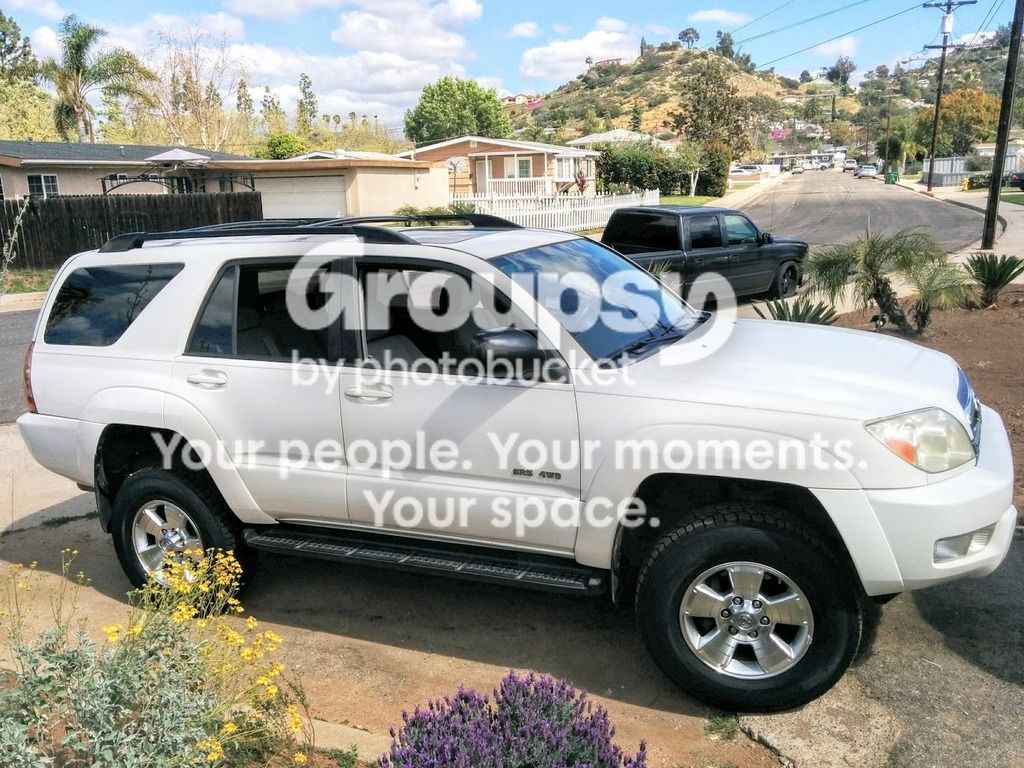

Lol for sure. I was thinking Toytec or OME. Hard to tell the difference from here. What would you suggest? Not limited to those two...

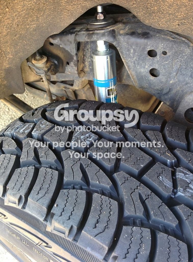

I just lifted mine and I was torn between toytec 2" and ome 895e's. I chose the toyecs for the smoother ride. When paired with 884's up front and 5100's I kept a significant rake. Keep in mind I have the 5100's on the 0" setting as not to preload the 884's. Still trying to decide if the rake is too much. Hope this helps. Good luck!!
