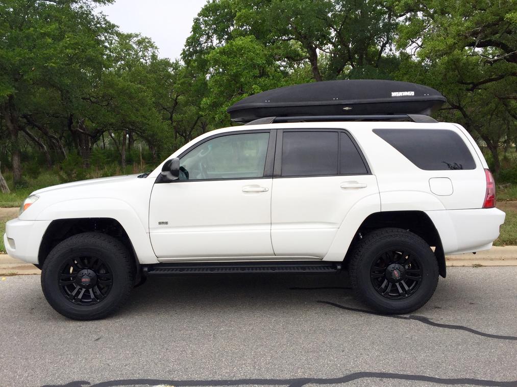

Finished, 5100's on 2, FJ coils, and a wash. Dropping off to my son now. Thanks everyone for holding my hand through my fist build.
What lift setting are you using in the front, by 2 you mean the 1.75" notch? Do you have a spacer in the rear? Looks nice
I totally spaced measuring prior to lift. But I will say a bump over 2". Final measurement for front is 37" on both sides, and for rear driver side 38 1/2 and passenger side 39". I'll take measurements after a month or so to see what the settling in difference is. I had the 1.5 daystar ready to install, but after I saw the front after installing 5100's I didn't want to go any higher. Figured it would not match up and make my new tires look smaller. So I held back and glad I did. I think it looks perfect. It's only 2wheel drive, so no need. I rides sweet. Could not have done it without the help from some awesome guys on here.
Maui, that looks perfect. I'm about to do the same thing to my 04, 2WD, V8.
Do you have the parts list and where did you buy from?
Bought it all from RockAuto. Just put your year and make, and you will get the correct parts. I can look my records up and and see, but you can also call them. They will hook you up

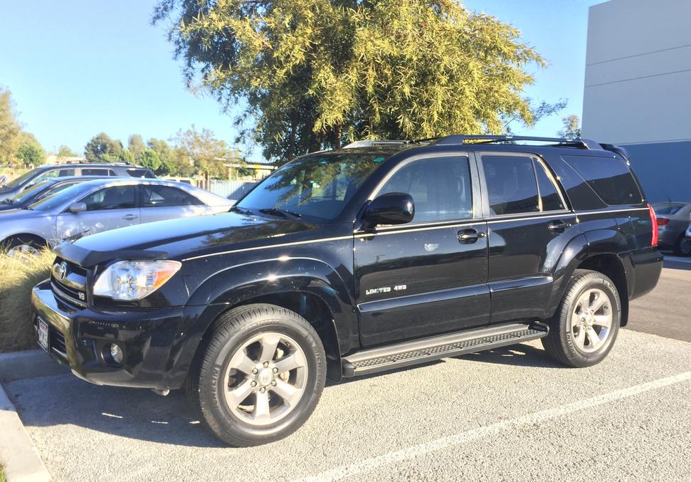

1st Mod to stock '07 Ltd 8 cyl 4WD
I just bought a set of Bilstein 5100s for the front of my '07 Ltd 8 cyl 4WD, no XREAS. 121K miles
Reason: I want to level out the stance and occasionally drive rutted unpaved roads.
note: All suspension currently stock and rides very nicely.
Question: What setting do I need to to use on the front Bilsteins to achieve this level stance?
Future plans: TRD 17" wheels and 285 70 tires

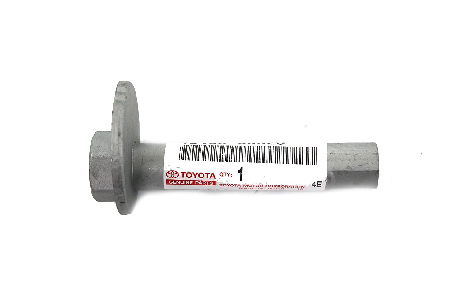

I'm having a shop replace all 4 front control arms and I'm going to be buying the cam adjusters assuming they're all siezed (Canada).
Is the part that usually gets stuck only p/n 48409D? Does the bolt get stuck inside the cam sleeve or does the cam sleeve get stuck to the bushing sleeve? Looking to reuse the bolt, nut and one cam if possible.
Can I get away with only replacing this item?
