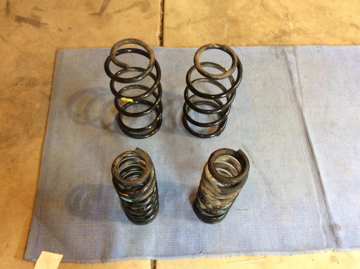

I've got some stock OEM coils I pulled off my 04 V8 with about 110,000. I'm asking $40 for all 4 if interested. I didn't read entire thread so if this way off base I apologize.
