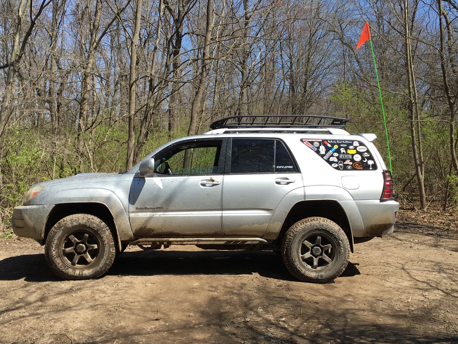

I have P265/70r17 on 17x9 and they fit fine and look fine. Picture below. P-series 265s fit on 9" but I was told LT 265s will not. Probably something with the sidewall not flexing enough.
Also, 6x5.5 is the same as 6x139.7 I believe. Can't answer your other questions.
