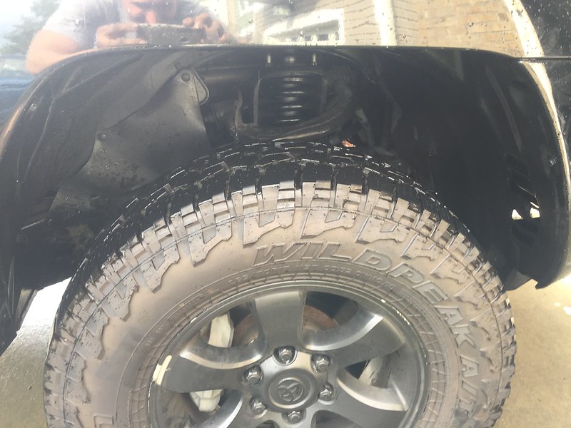

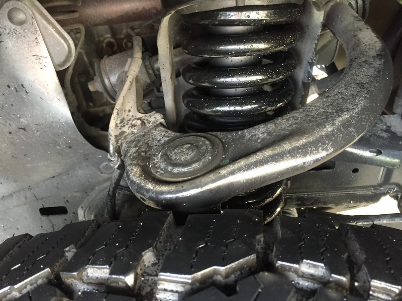

Okay, I finished my install a little bit ago. I'm not 100% sure I'm okay with how the UCA is now. What do you guys think? I am okay going the wheel spacer route if you think that is a good option. Or I will take them out and drop down to the .85" setting if need be.
Here are the photo's...
IMG_4006 by Drew Carter, on Flickr
IMG_4005 by Drew Carter, on Flickr
